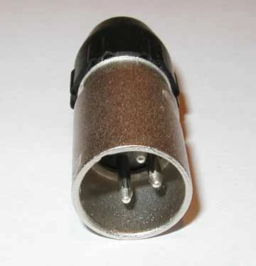

What about these EGR eliminator plugs, do they work?

Not so sure if using the EGR elim plug is a good idea. usually with the EGR unplugged, the CEL is tripped and the computer recognizes the EGR as non-functioning and disables it. The Elim plug, if i am thinking correctly, tricks the computer into thinking it's working to turn the CEL off...however, this means the computer may adjust fuel/timing thinking it's working.
Are you getting a custom tune? If so, i'd skip the EGR elim plug and have the function removed from the tune completely.

I'd research what exactly the plug does. If it tricks the EEC into thinking it's working, i would not use it. I'd rather let the CEL glow and the EEC remove the function than take a risk in running lean at cruise.
Here is what RJM Injection says about the plug I purchased from them:
EGR Valve Position Sensor Eliminators send a 0.50volt CLOSED EGR signal to the computer. The computer then knows the EGR is permanently closed. Keeps the annoying CHECK ENGINE light OFF, and more importantly keeps the engine running smoothly. Guaranteed to work on any 1986-93 5.0L Mustang! Also works on most 1986-95 Ford that uses the Light Gray EGR valve position sensor; which has a closed reading of 0.24 – 0.67 volts. Without this the computer will assume the EGR is stuck open when removed, causing a rough running engine.
I found this...aparently, it does work properly
