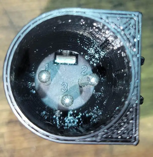

FastDriver I was uncomfortably high & wearing a helmet SN Certified Technician Sep 5, 2001 6,240 2,949 224 Vass, NC Jun 25, 2024 #61 Jun 25, 2024 #61 @NotMyStang 1-2: 2.04 ohms 1-3: 2.04 ohms 2-3: .371 ohms
N NotMyStang 20+ Year Stangneter Oct 14, 2003 32 1 9 Jun 25, 2024 #62 Jun 25, 2024 #62 Perfect! I’ll make a new resistor triangle to get these values and see if it makes a difference on my 95. Thanks again.
Mac131 Active Member Aug 9, 2024 236 218 53 USA Sep 1, 2024 #63 Sep 1, 2024 #63 FastDriver said: @NotMyStang 1-2: 2.04 ohms 1-3: 2.04 ohms 2-3: .371 ohms Click to expand... I have one of these but the readings between 1-3 and 2-3 are swapped. Any chance what you posted is flipped?
