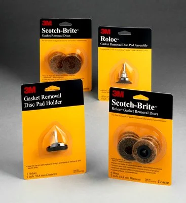

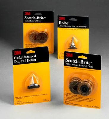

For the last 15 years I have been doing the silicone on the ends. No leaks here. :D (RTV Blue)
I do a great job of cleaning the surfaces first with a 3M Scotch Brite gasket cleaners. Like this.
Then I clean the surface with brake cleaner and a clean rag.
I put a small dab of silicone between the center ports on each side of the thermactor holes to help hold the gasket in place, and a very small amount of sealer around the water ports, just enough spread out with my finger to fill in the imperfections in the metal. (Like Stang8URMPRT mentioned)
Then I put a thick bead for the front and rear and fill in the ends (little notch) where it meets up with the lower intake gaskets.
I set the intake on right away and do not let it tack up so it adheres to the intake and the head well then torque the bolts down right away going over the sequence about 5 times or so to make sure the intake is seated properly.
I do let it sit for 24 hours before I start it up to let it dry.
No leaks! :nice:
I also cut the gakset material out that hangs over in the water ports.
