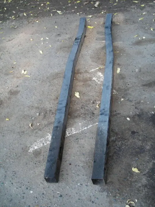

My Mach 1 came stock with bolt in subframes...They were pretty thin & crappy though...I hope these arent the ones your looking into?
I wouldnt waste my $$$ on these....
heres a pic....

Yeah, IDK if they look like that or not the ad says weld in so they are prolly different. Thats why I posted this because I wanted to see if anyone DID know what they look like. The ad on ebay, just type mustang subframe and click search and it will come up under ebay stores (bottom of page) and you will see the ad say 96-98 Cobra subfame connectors and they are buy it now for $45.
