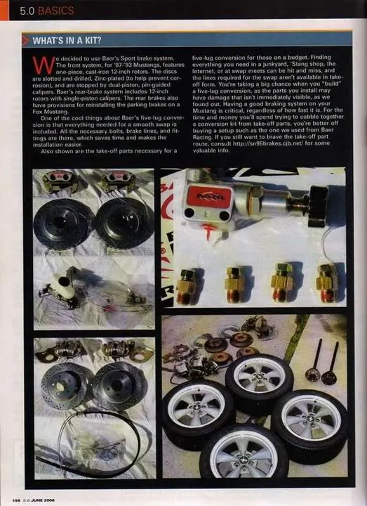

Hey guys,
I need new brakes all around on my 87 LX and I am going to purchase the Ford racing 5-lug conversion kit. I was wondering what benefits are there besides cosmetic? How much better is my braking going to be and is it worth the $3000??? Thanks!
My opinion....
It is a great kit, comes with everything you need. You will notice MUCH better braking over stock.
However, I think it is a VERY expensive kit.
All told, you should be able to get the same kit from a combination of the local parts stores, eBay, and the boneyard for well under $1000.
My brother, Sal, did a 5-lug install on my coupe in one day...

does the FRPP five lug have wheel offset and backspacing restrictions like the other JY five lug/rear disc conversions?
how does it affect track width?
are there any other suspension(ball joint, bump steer, problems w/alignment), wheel, or clearence related issues to know of?
do these issues become more apparent when lowered?
