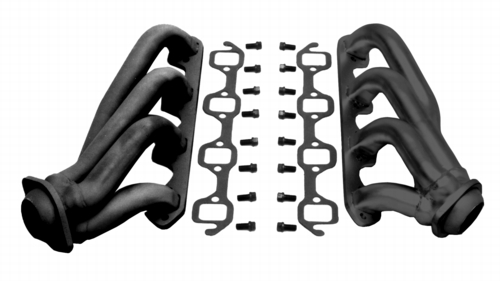

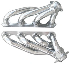

Which one of these headers pictured are the right headers? They are both the same model number but the pictures are different on the JEGS and FordRacing websites. Is it a mistake or did ford change the design again?
JEGS:
Ford Racing:
Could be one is for '79-93 and one is for '94-95, but that's just a guess. I would say one is stainless and one isn't but that doesn't explain the differences in tube placement. Just by looking at them i would think the black ones are the right ones because they look as if they would come out further from the heads (which is the point of "P" headers, so they clear the plugs). However, the collector angle on the black ones does look funny.
They are the same exact headers. You are just looking at them from different angles....Trust me. Spin the bottom one down a little so the flange is pointing straight up and the top tube will look longer, and the bottom will look shorter, its just an illusion.
I just remember there's a difference in the flange style for '94-95 so that's not it.
Mob, look at the #7 primary on the driver's side header....they're clearly different between the two pics. No angle changes needed :D
I was under the impression that pretty much all of Ford Racing's headers were stainless, not painted black. The ones i've seen were top notch parts to...awesome welds, flawless fit. If i ever go back to shorties that's what i'll be using.
The pictures are definitely different, you can tell that. The "P" headers are going to come straight off of the flange more to clearance the different angled spark plugs from the "P" heads, that's the reason there are even "P" headers in the first place.
Yeah, you are right 85_ss they do look different. My guess is the bottom pic is a generic pictures because they do not come in black. I dont know what you are worried about though,if it says P headers for 87-93 mustangs it will fit, regardless of what the picture looks like.

This is the case with the pictures I posted. It seems that ford racing has not changed the picture on their website to the new style header. The one pictured on the jegs site is the M-9430-P50 (correct gt40p header) and the header pictured on the ford racing site is the older M-9430-SSC that was replaced by the P header. :nice:

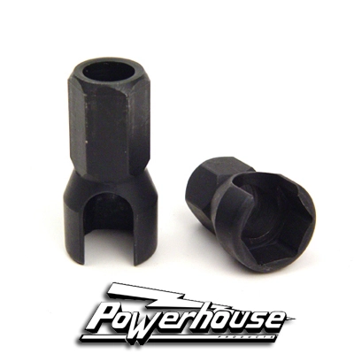

I also came across these handy little sockets for tight header clearance.
$48 for Two

......or you could use a wrench like normal people and save yourself 50 bucks! :nice: lol
