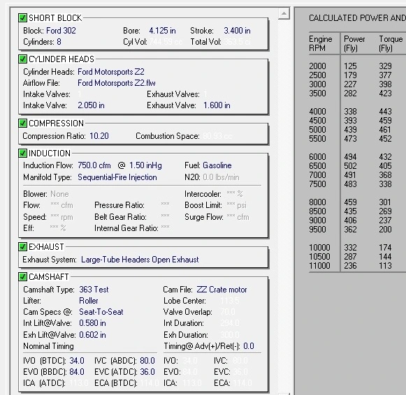

507 HP at 6500 rpm is not what I would call street engine (unless you are doing high speed races on the interstate). Based on some of the specs I could find on the combination, and plugging them into a dyno sim program (I came up with 502hp @ 6500, 461 lb ft @5000) I would bet off idle power is not much higher than stock.
I understand it is a sim program and they are not know to be perfectly accurate, but it is likely in the ballpark.

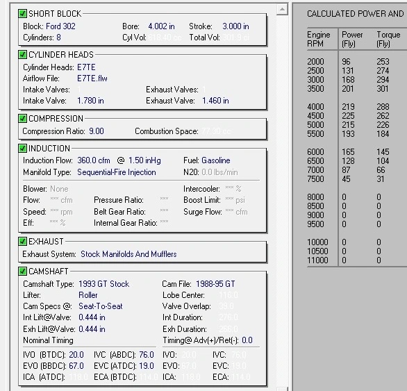

Same program, stock 5.0 specs
Take it for what you want.
459HP at 8k rpm on the crate 363...
That program is skewed to say the least. The valve springs on those heads will not go 8K.
Off idle power is going to be a lot better with the 363. That is the beauty of a 3.4" stroke over the 3" stroke.
The printouts shown show 80 lb/ft more torque at 2K rpm for the 363, which is basically off idle.
Yes the program doesn't know what you actually rev the engine to. It is a calculation that assumes you can rev every engine to 12k. If you think about it, the actual engine becomes limited by the parts in it. The program assumes it can rev higher without those limits. Valve springs limited to 6500 or 7000 or 8000 rpm do not change what the engine can produce from 2000-5000. So ignore the numbers higher than you will likely use.
Remember it is a simulation and obviously has errors.
Hey here is another option, change the valve springs to some that can handle 8k and 459 is probably close to what you get.
