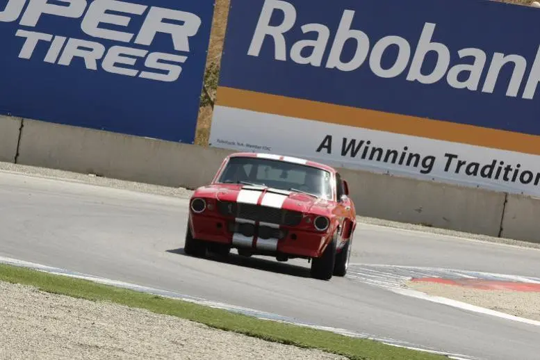

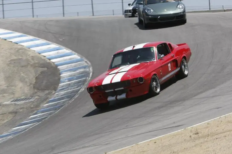

Here is a video of my car at Laguna Seca with a Tcp Man Rack. I run 245 45 17
tires up front and it is a little tough in a parking lot, but the feedback at speed is amazing. You can feel the front tires starting to slip away in the steering wheel.
YouTube - Greg G | Mustang GT500 | Session 1615 | Laguna Seca
Here are a couple of photos.
