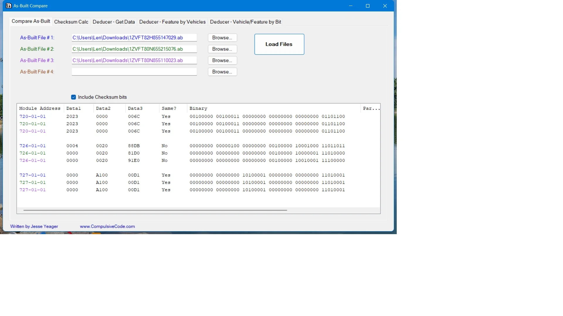

Here's an Asbuilt compare of one 2005 GT and two 2005 V6 with no apparent fog lamps. It seems the difference show up in the 726-01-01 line. Maybe this will help.

Awesome. I’ll take a look. Thanks
