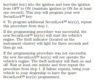

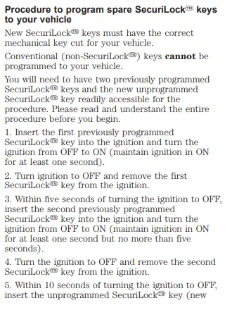

Once you have 2 programmed keys, you can easily program a 3rd (up to 8 total keys) using the procedure outlined in the owners manual. This procedure is also in the above video near the end.
