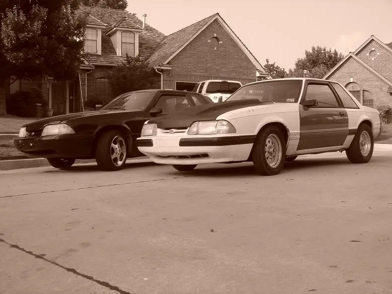

i kept the 4 cyl springs up front on my old coupe that i converted to 5.0. it sat BADA$$. here's a pic. btw, my car is the multicolored one. don't laugh at the paint either, she was my baby and was a work in progress! :)
and about the caster camber plates question, i had them and before i did the camber was really off. dont know which would be considered positive or negative camber, but the top of my wheels were in further than the bottom....so i'd recommend them.
