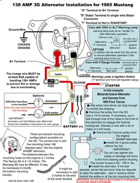

Here's some info that helped me when I converted to a 3G:
Nice diagram. You can also hook the Yellow wire directly to the output terminal on the alternator itself, makes for a cleaner install and saves space on the starter motor relay.
