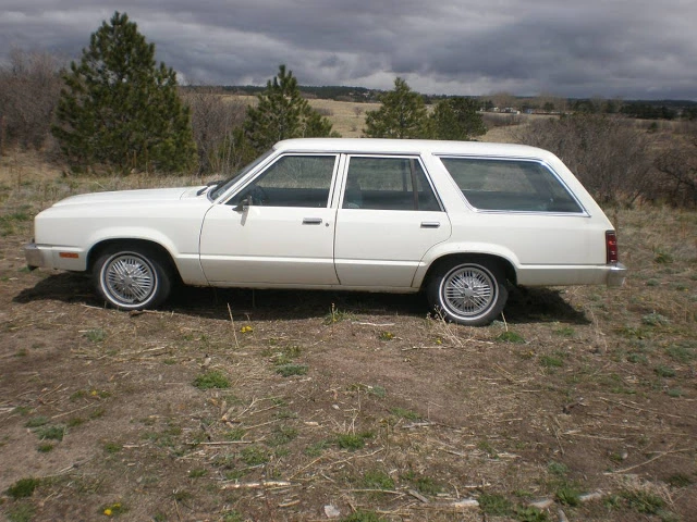

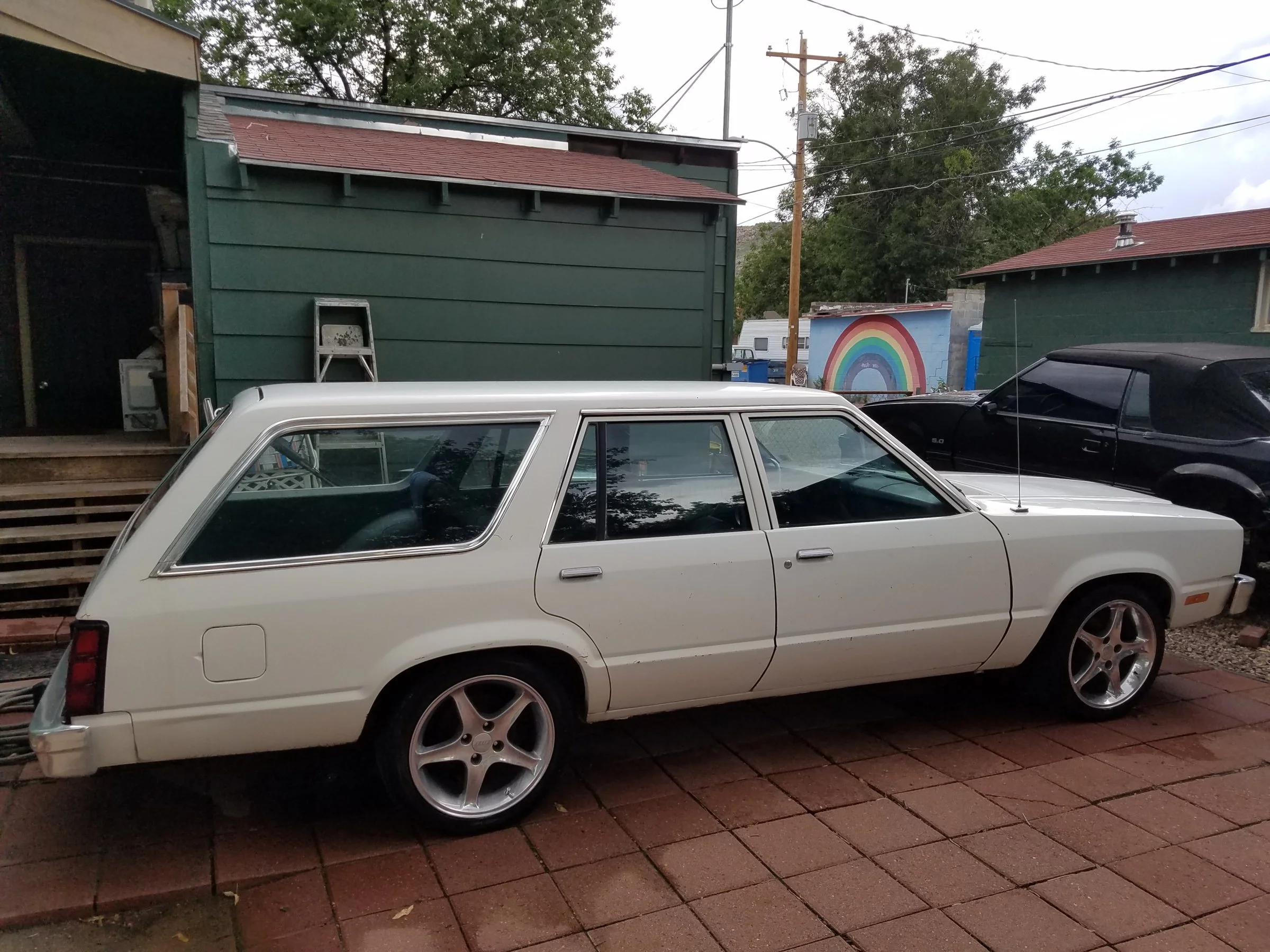

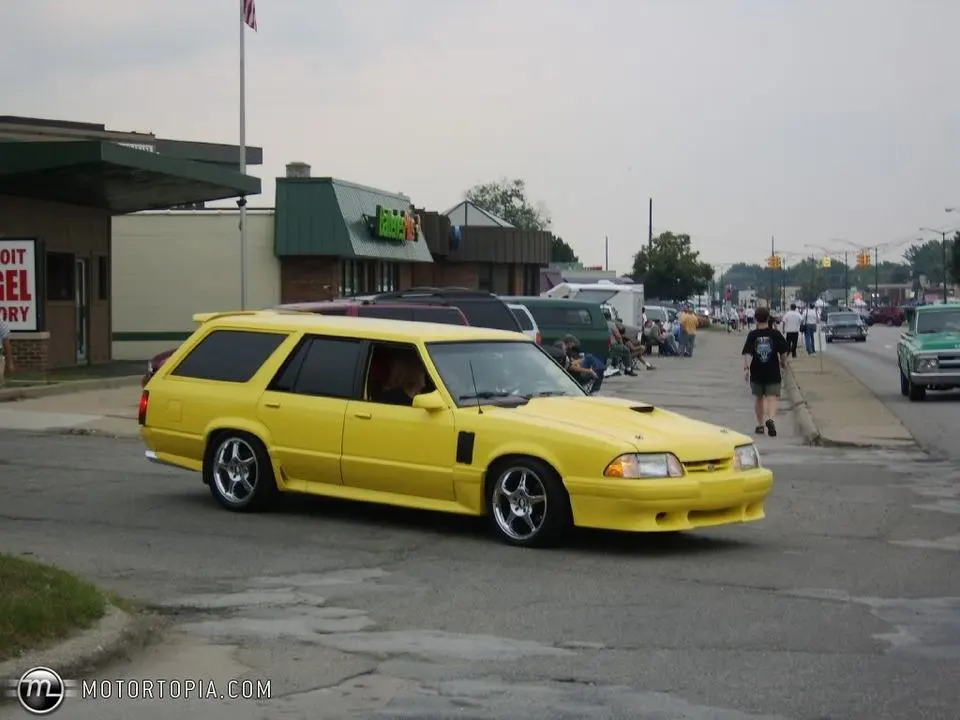

Need counsel in mustang front clip replacement going from fairmont to mustang.

This has been done before on other forums.
Have you already googled this? I bet there's complete write ups on it.
BTW, it looks very hot when done properly. Good luck with this. Show us your progress as you go along.
Reactions: elarm1
That fender/door line looks like an exact match for the mustang fender. I would bet it's as easy as removing the fenders and bumper and hood and installing the mustang parts...with a few quirks like hood latches, wiring, etc.

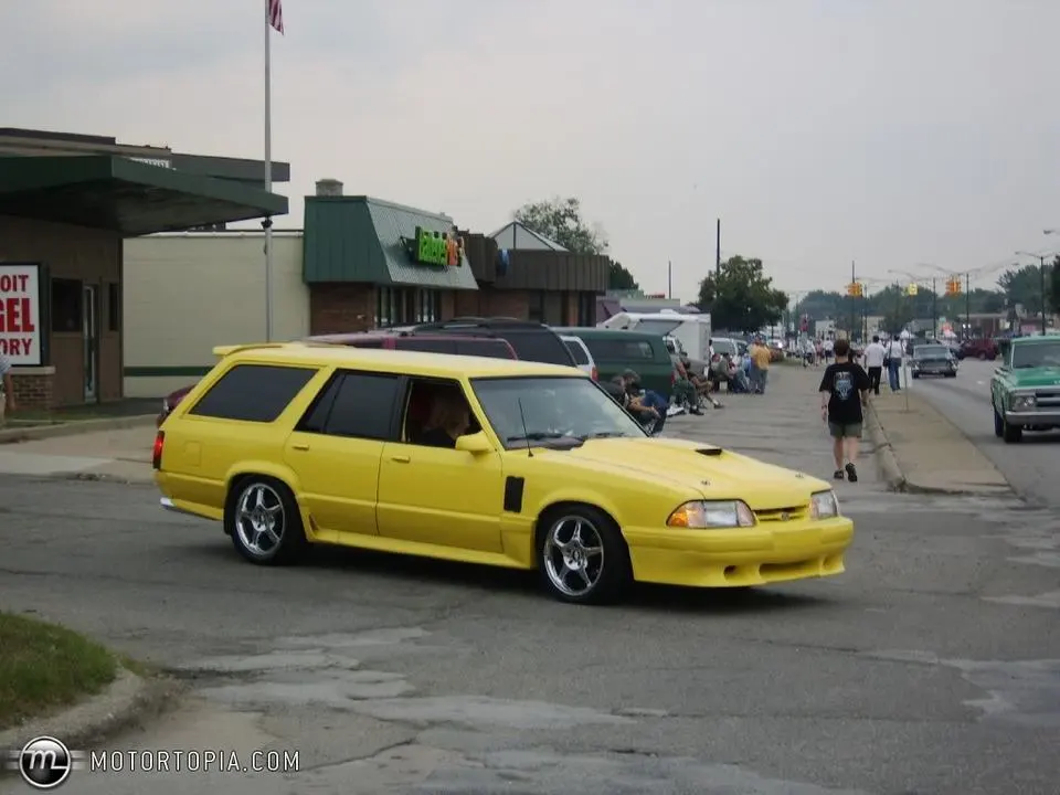

Thanks for the input and encouragement, glad I found stangnet. Trying to finalize a deal for a donor roller '88 mustang gt, no engine/trans., which will provide front clip, suspension upgrades all around and beginnings of the interior. Linda and I wanted to buy a '68 mustang, when we got married, however, we got a son instead... :-) now, in our seventies we are going to create our FairTang and we are enjoying every moment in the planning.
I think it's a good look. It has obviously been done before, so you have a template to work from. It's not something I've ever considered personally, so I have no input as to what you'll have to consider w/ regard to the sheet metal swap.

It does need the early front end either way,..the aeronose doesn't flow as well as the 4 eye versions do.

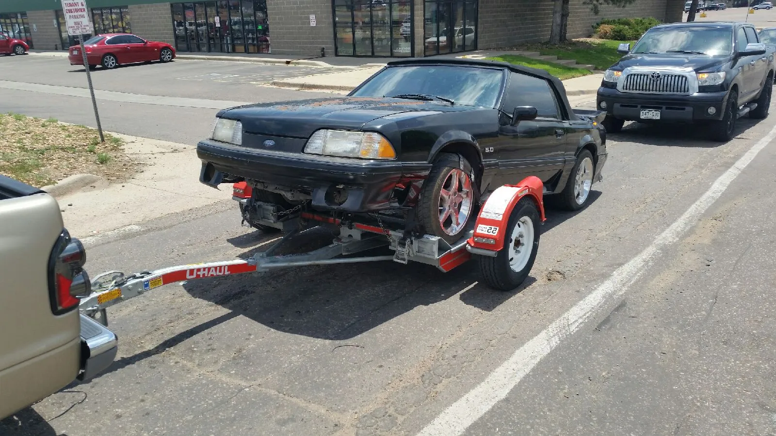

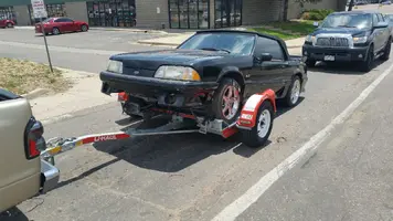

Donor '88 mustang gt on the hook and ready to start supplying upgraded suspension/posi rear end, parts, wheels, tires (almost the same as yellow fairtang example,) and some gt front clip, parts (very hard to find a mustang that was backed into an accident... :-) need leads on a hood and front grill. will post a classified ad for the convertible top, which is excellent, doors, trunk and saleen rear wing, later this month. thanks for all the support, the project moves forward.

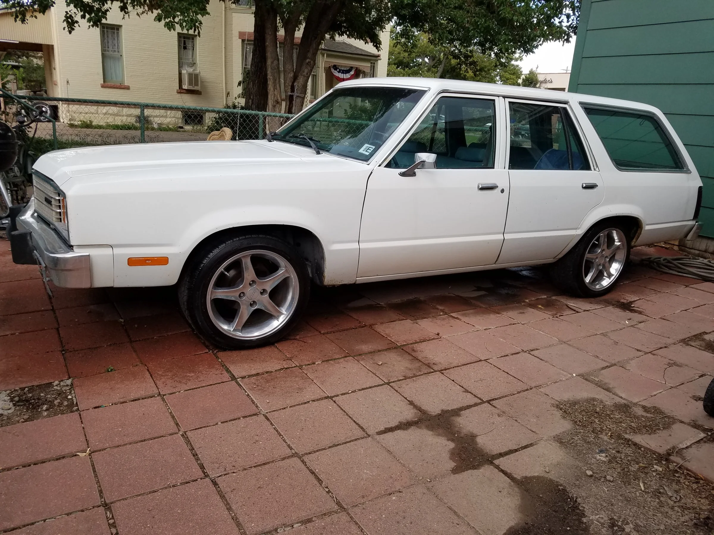

Decision points: for anyone who has taken on a build knows, there are many decision points along the way, i hit one yesterday. Preparing to swap the 79 fairmont suspension with the 88 mustang gt, i test fit the alloy wheels and tires and then i realized what an amazing, straight fairmont, including the front clip. When the suspension is swapped and car lowered, 3" in front, 2" in back, does it really make sense to swap the front clip or move towards de-chrome, new paint, highlighting, then move on to interior updates. So forum followers what is your vote? Thanks, Al a.20170728_154304.webp

Wow, what a question.
If your gonna customize a car it's best to start with the best example you can find. No collision, frame damage or rust issues are a good thing.
I think a fox nose on that car is, well, strange looking and must have associated mustang related body mods elsewhere to look right. It could be btch'n ride.
