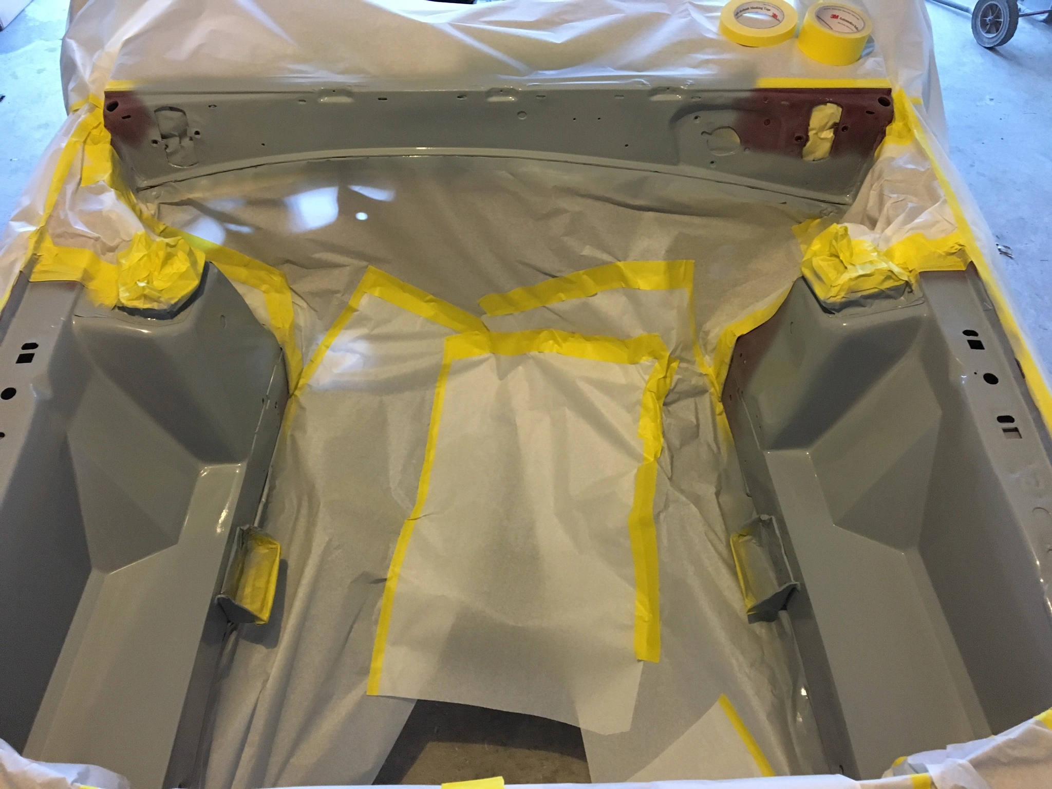

I appreciate it Dave. One question I have about painting the jambs is I know it's a small confined area. I'd considered using a cheap detail gun, but, I wasn't sure that gun would spray primer it's only got a 1.0 tip. My other gun is an Eastwood Concours HVLP gun. Is there a trick to using the big gun when you don't need much paint. What say you?
A 1.0 tip is a fairly big tip on a mini-gun. I have two Sata mini-jets, they have a 1.0 & .8 tips.
I use the mini-jet with the 1.0 tip all of the time for primering small areas, shoot, I even brought it home to primer my engine bay after smoothing it all out. They work wonderfully with a 1.0 tip.
I wouldn't try to do a much bigger area than that though. It was in the low seventies when I primered it.
I would suggest using your mini-gun for the jambs and save your normal gun for when you spray the outside.

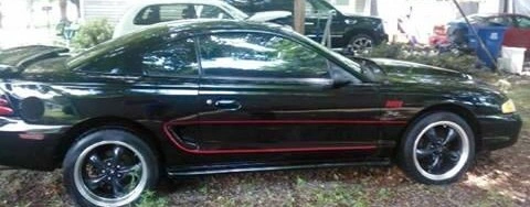

Dave,I have another non-fox body paint question.
When I bought my SN car-it came with these red stripes down the sides, and BOSS lettering on the fenders. The lettering has a very hard edge around the lettering
The stripes you can feel an edge,but no where near as thick.
I wouldn't mind just changing the stripe color-but I HATE the Boss lettering and want to make it go away..
How would I go about making the lettering go away?
And change the stripe color?

Are they just stickers?
I wish- they are painted on.
They where stenciled and the black paint laid on top
Get me a better picture of them Chris.
It sounds like they just laid them out on top of your paint job. If I were there, I could make them gone in about fifteen minutes. Let me think about this for a minute.

I'll get some better pics tomorrow. All I know for sure is if you run your hand over the boss letters you can feel the outline lol
Tell you what Chris, do you have some fine grit sandpaper? Like 1500-2000 grit?
Start sanding on the Boss letters with the sandpaper and water, real light like. Do your best to stay just on the letters. See how easily they come off. Let me know how that goes before you finish sanding them off.

Absolutely Dave, I'll get some better pics, and some more fine grit sand paper, and go from there :-)
Absolutely Dave, I'll get some better pics, and some more fine grit sand paper, and go from there :)
Try not to sand into the surrounding paint too much at first.
Just do this to see how easy it comes off. I'll send my phone number tomorrow night and we can talk through it.
