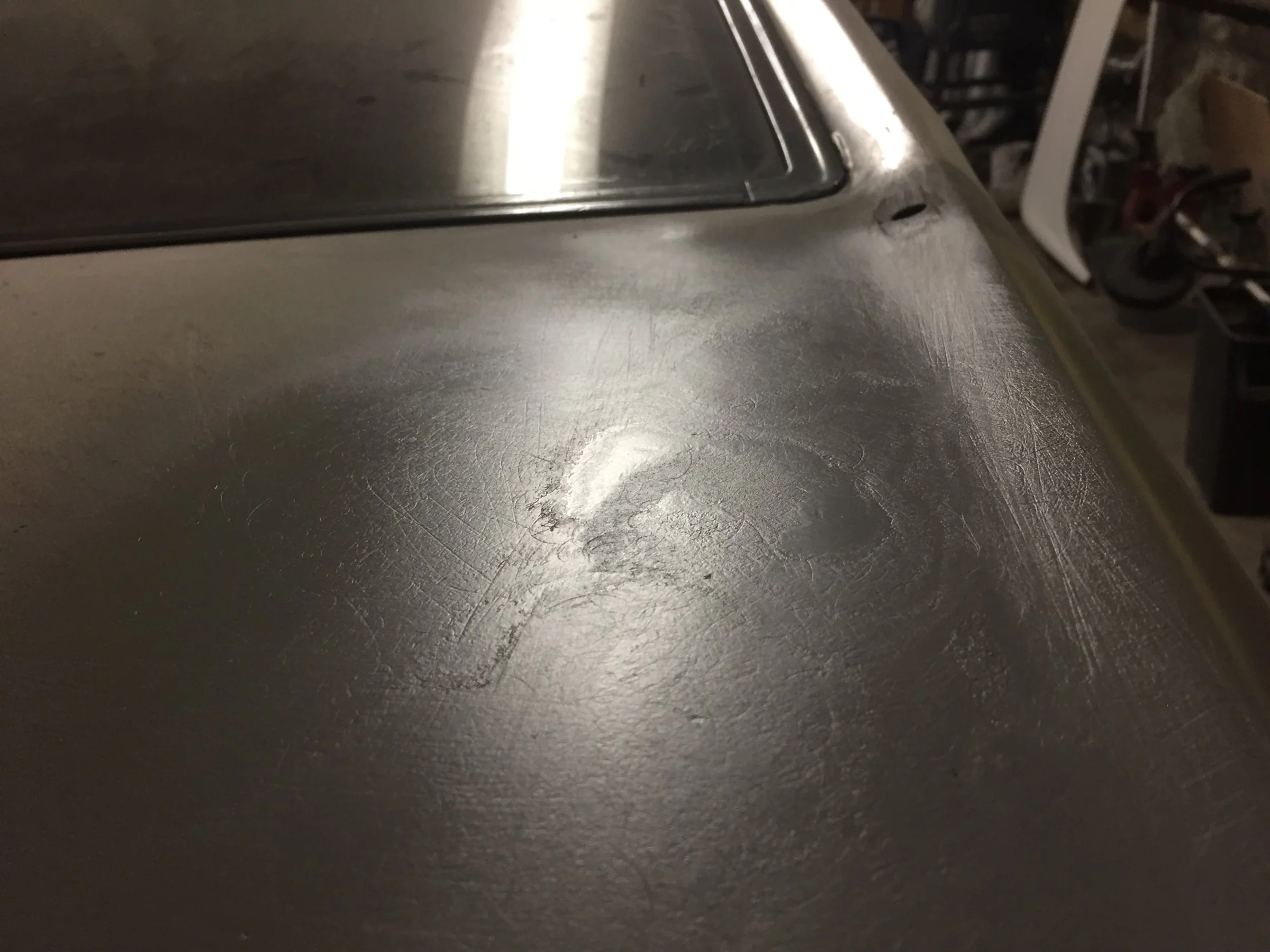

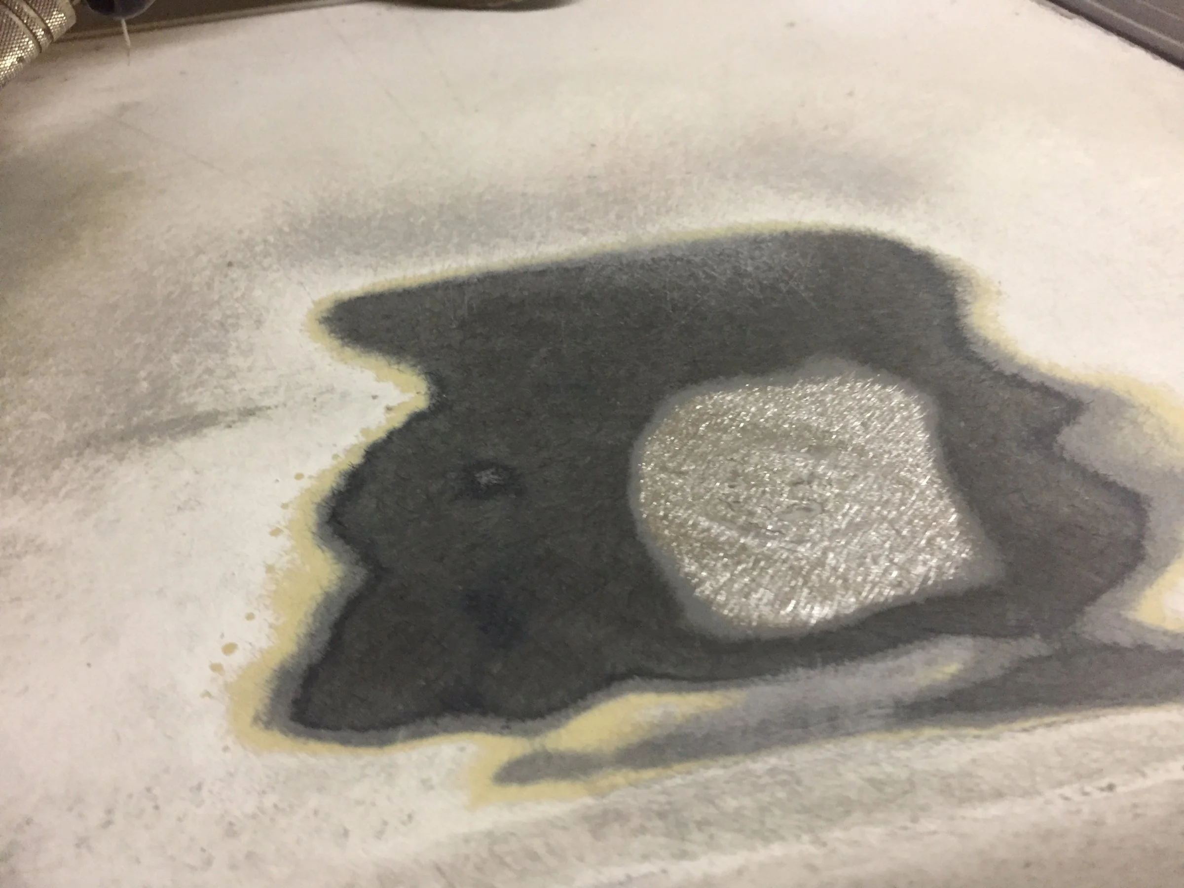

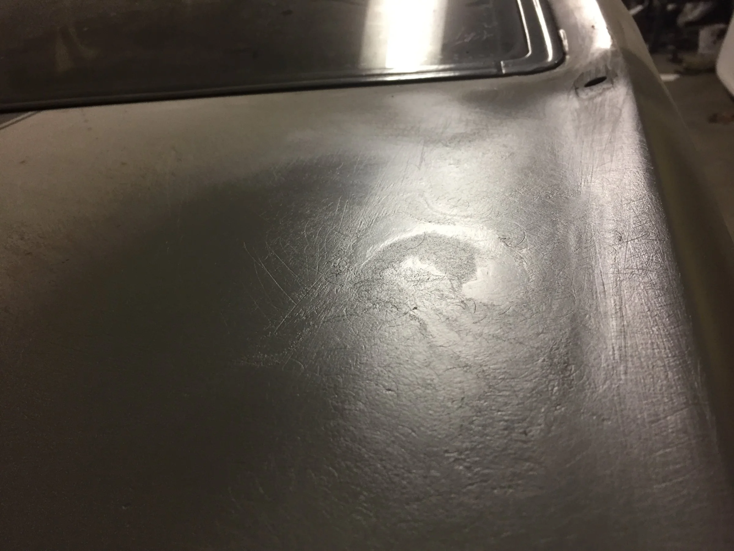

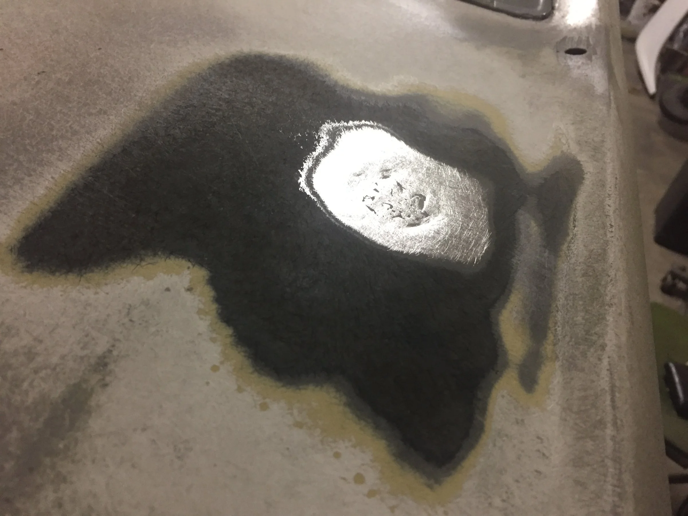

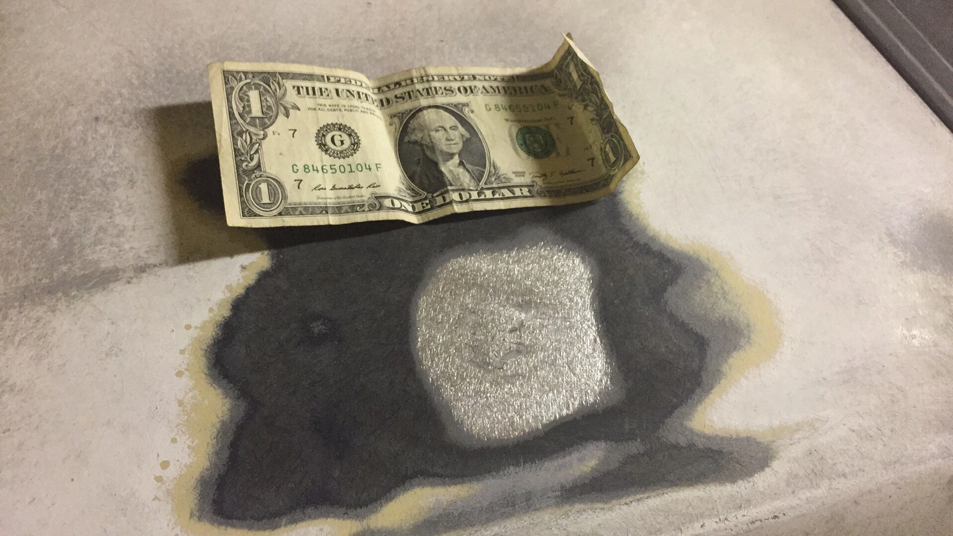

Ok, so I'll just post a pic of what I'm dealing with. I wanna preface by saying this is not even close to something I'd paint over. This is just trying to get it so it don't bug me every time I see it till I actually start the body work. I plan to properly strip to metal and go from there, but I'm using this as a chance to learn.
So I'm the pic, I welded up the hole, ground, tapped it down, body filler, da sanded with 80, and primed with canned filler primer. This is where I start to get lost. Am I sanding the filler too much? I know I need to take it to 120 when I'm using proper materials. I know the canned primer is much thinner than the spray stuff so I dunno if that is the issue? This is where I thought glaze was needed but I'm not sure.

Ok, new pics to show more of what I'm dealing with. You can see the original paint, then coats of primer/sealer/ white paint. This will all come off when I do this proper.
Again, this is just for learning, not a final product.
I think , the steps would be to widen the sanded area , do a coat over the weld area to fill it in, knock it down, then do a skin coat over the whole area, then block that with 80-120-150, then a coat of primer??
Pretty much.
Feather it a little further like you said. You may get away with just using glaze to fill that. It doesn't look bad at all.
If you use glaze, you won't need as harsh of a grit ofnsandpaper. 80 grit for the initial blocking, just to knock it down. Finish in 150 or 180 prior to primer.

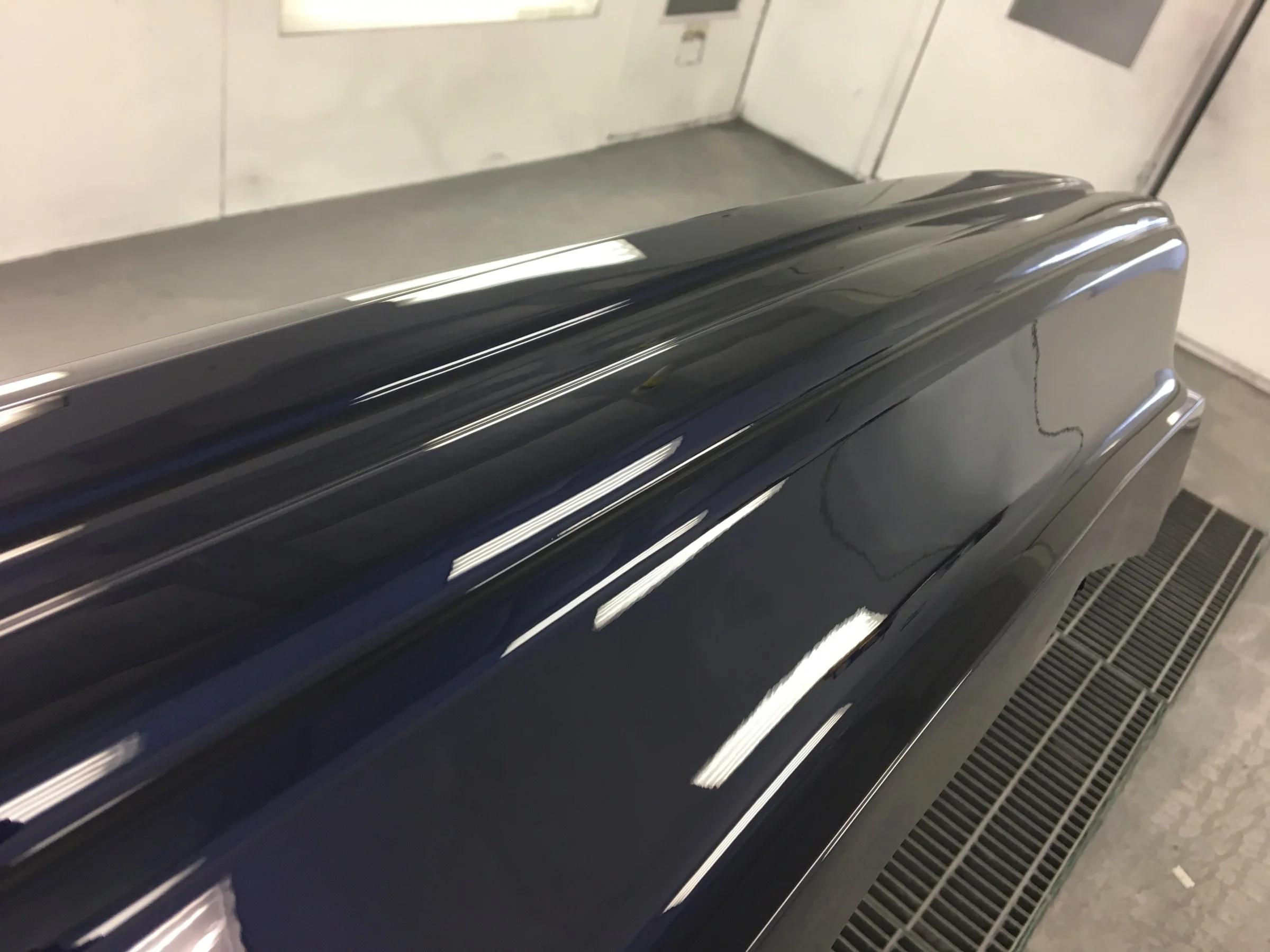

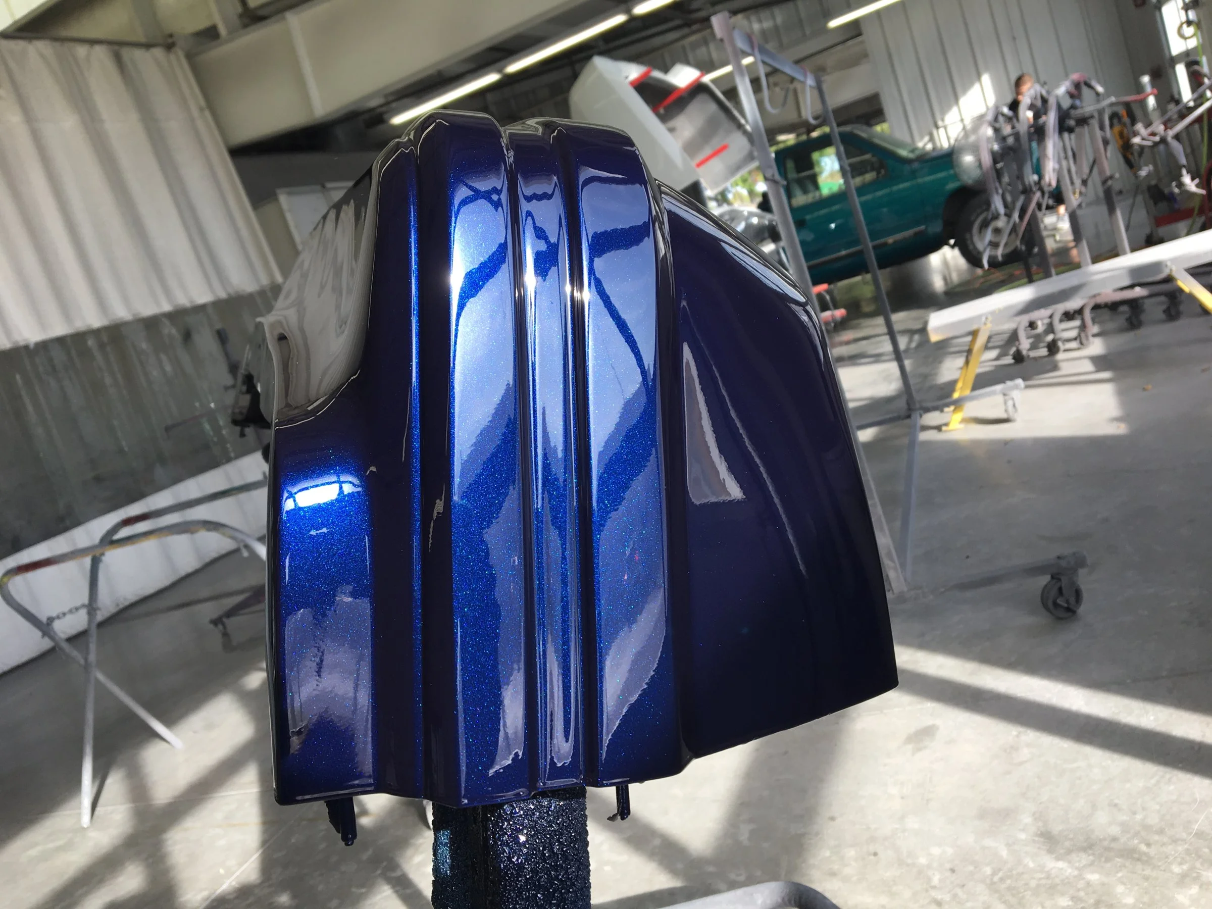

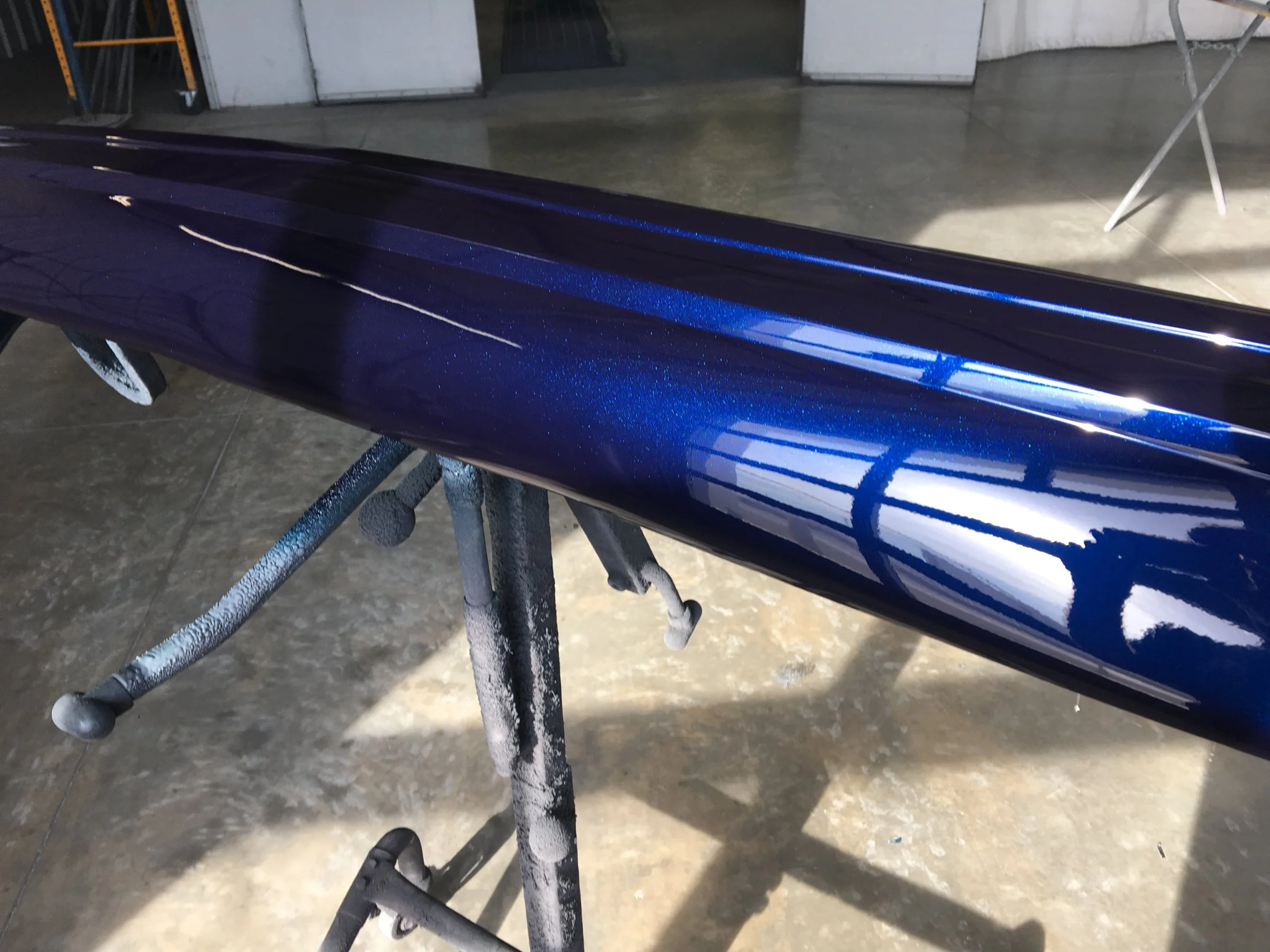

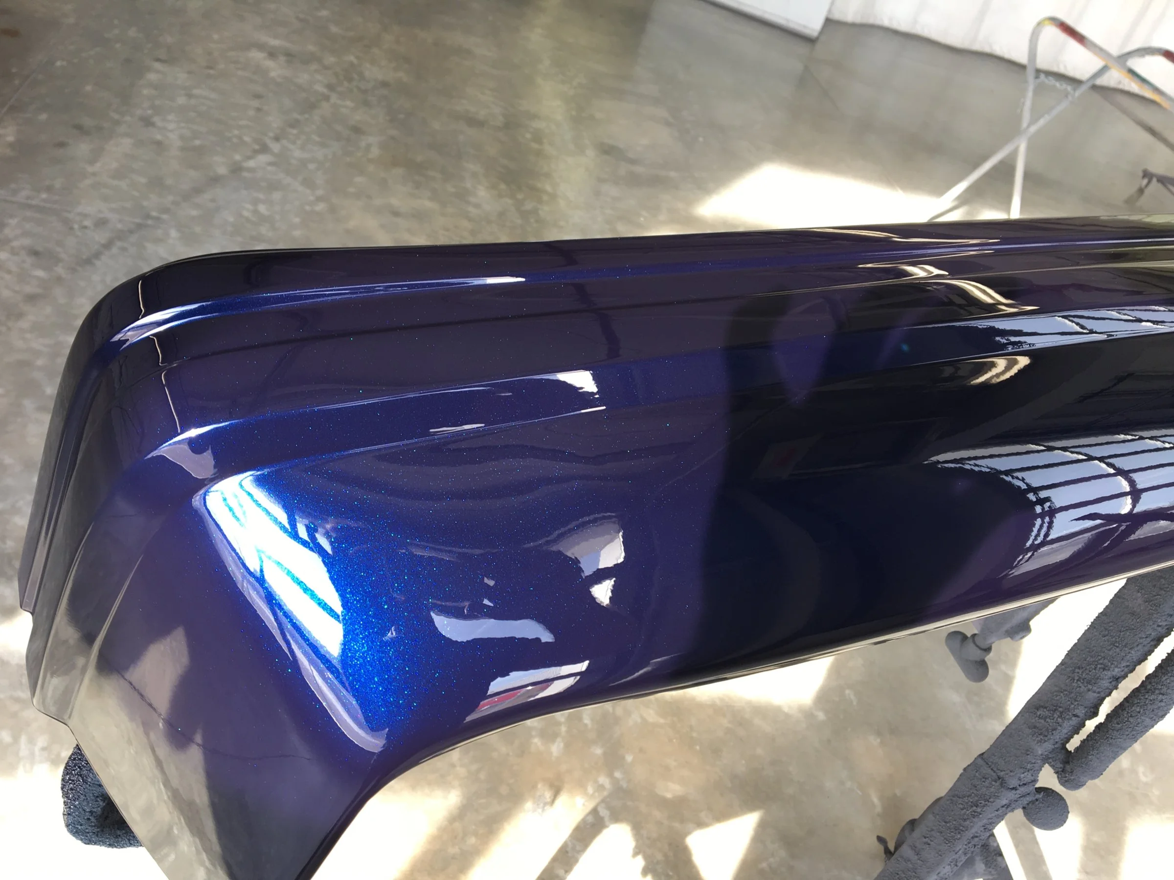

Btw, i never finished up with the bumper repair on this thread so.....
After i reprimered the bumper, i blocked it with 320. I then cleaned it up, sealed it, five coats of Kona blue and clearcoated it.
My primer, sealer and clearcoat all have flex additive. Check to see if your paint will have this additive in it, these bumpers are very flexible.
Anywho, pictures:

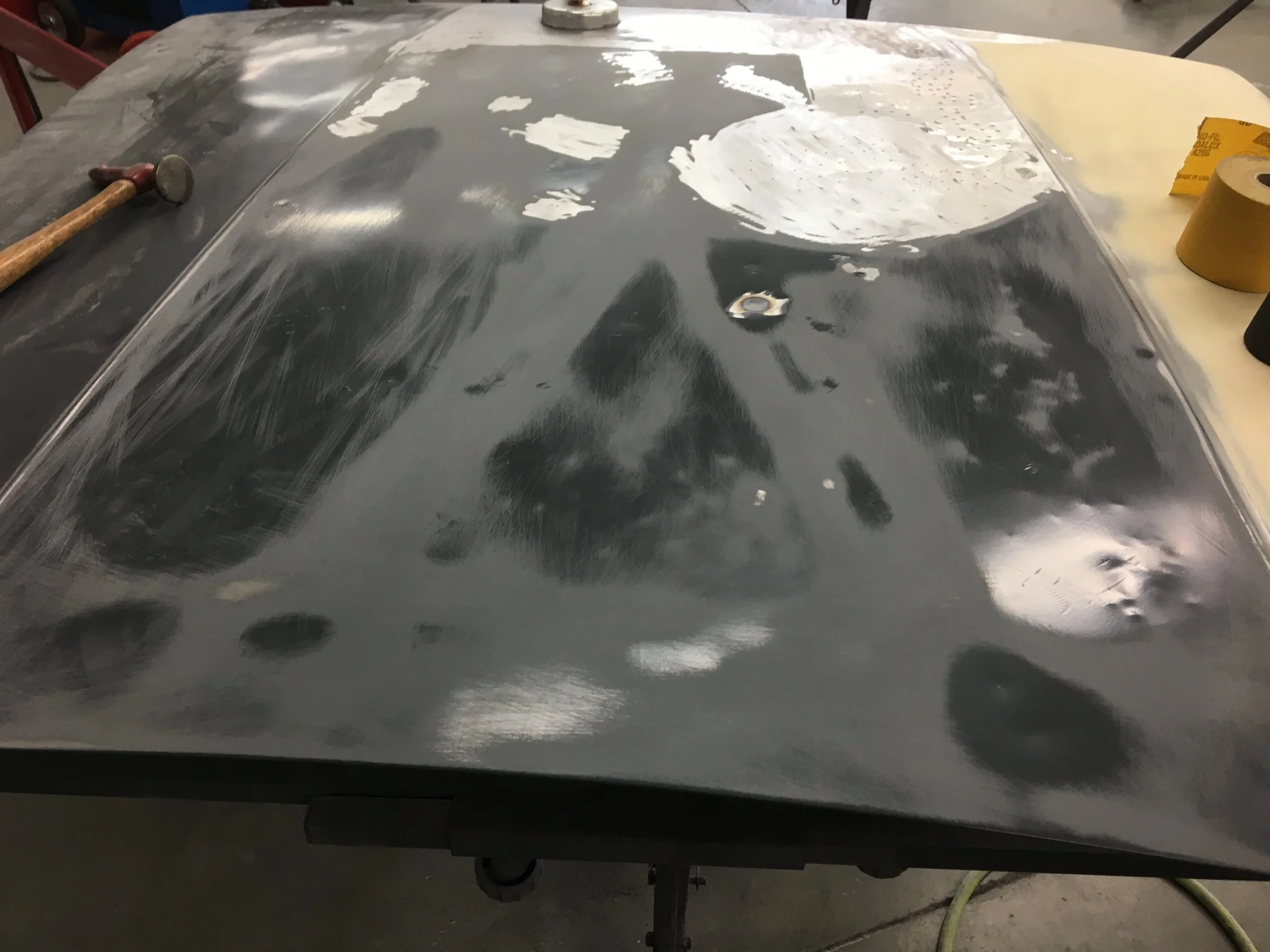

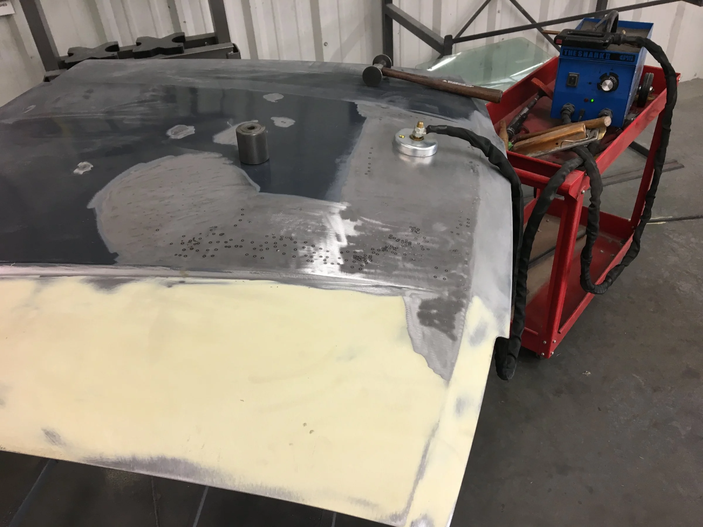

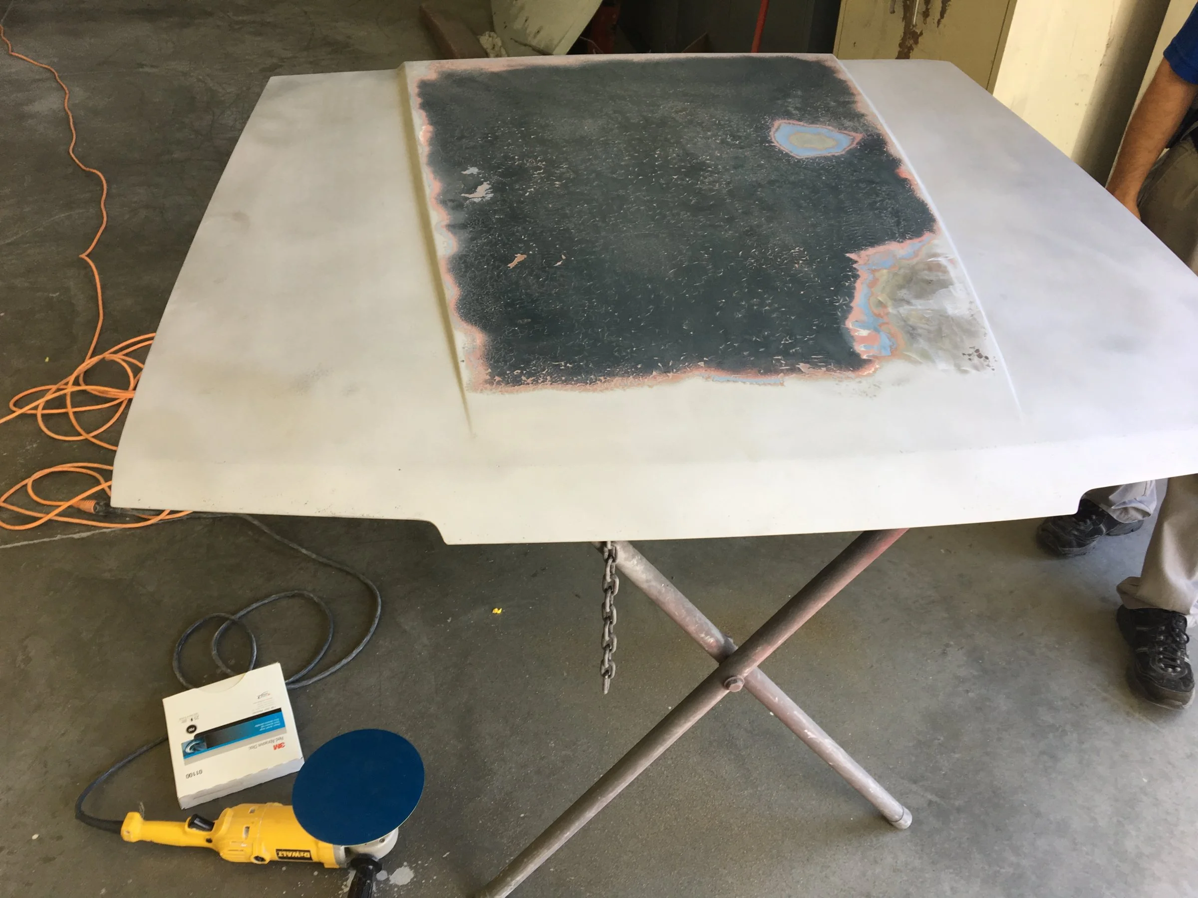

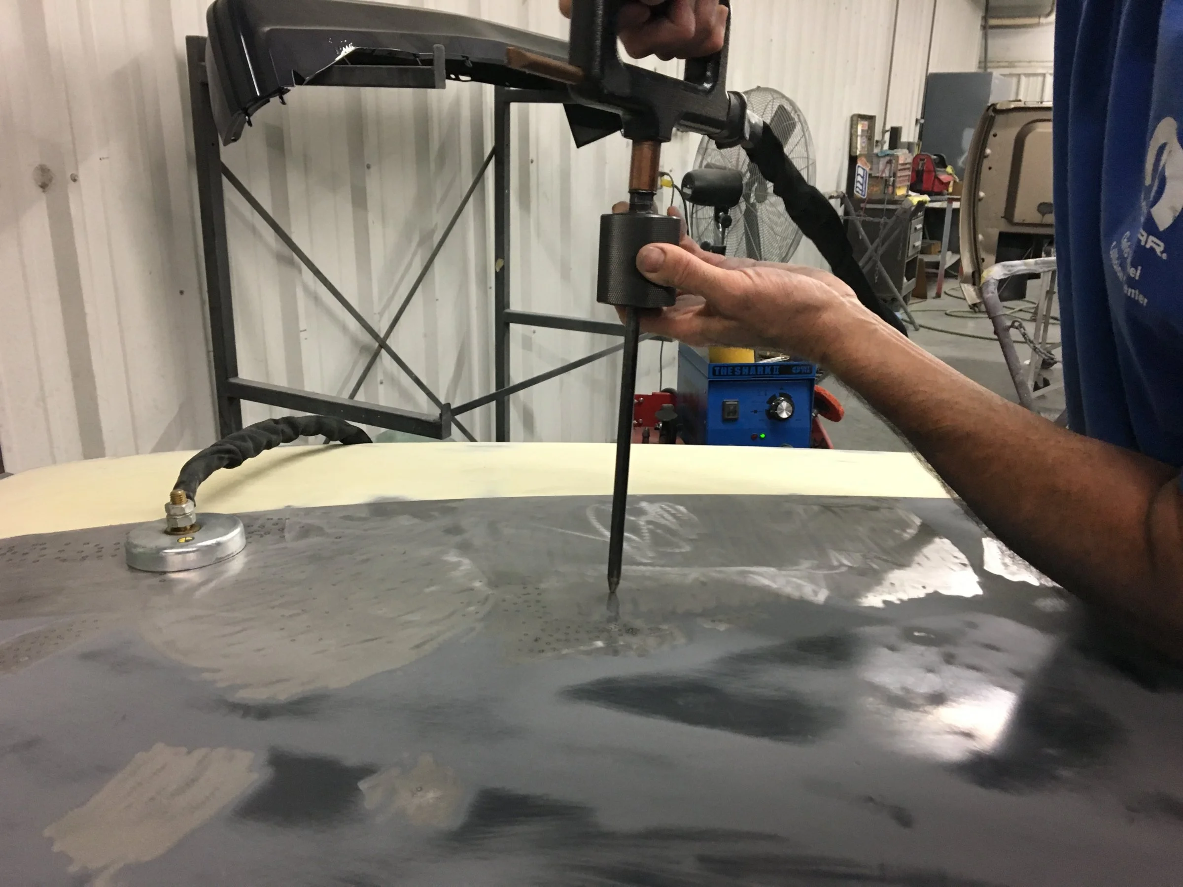

Another thing, i'm going to show how to shrink stretched metal in my blue car's build thread. I guess it would be a good idea to show how i do it here as well.
My test subject is the hood to my blue car that was a little rough in the first place, then i took it to my media blasters to have them clean the paint around the edges and the supports underneath.
Well, the blasters got in a hurry and just blasted the entire underneath side:nonono:. This warped the hell out of the flat unsupported surface of the hood. Sandblasting creates a lot of heat on metal, thin surfaces like a hood skin should never be blasted with sand, use something like crushed walnut shells or soda blasting.
I'll get a picture of the tools i'm using and a couple of me working out one of the larger warps. You'll see in the pictures i'm posting that i've already been working on it.
Make no mistake about this, it takes time. You won't fix something as ugly as this real fast. There will be mud....
Why don't i just buy another hood? They cost $550 new, and that's for an aftermarket hood that may not fit properly, besides, i don't have $550:shrug:.
A couple pictures, one of before sandblasting, after, and one of it worked on a bit with it having been etch primered and given a couple coats of primer to prevent rust.
If i have time, i'm going to take out the big one on the right side and the smaller one in the middle today.
Reactions: RaggedGT

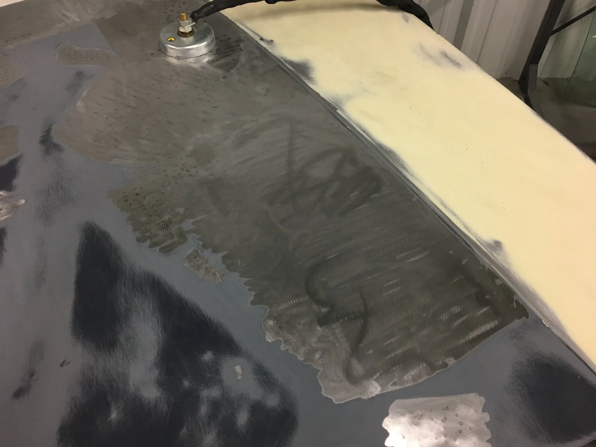

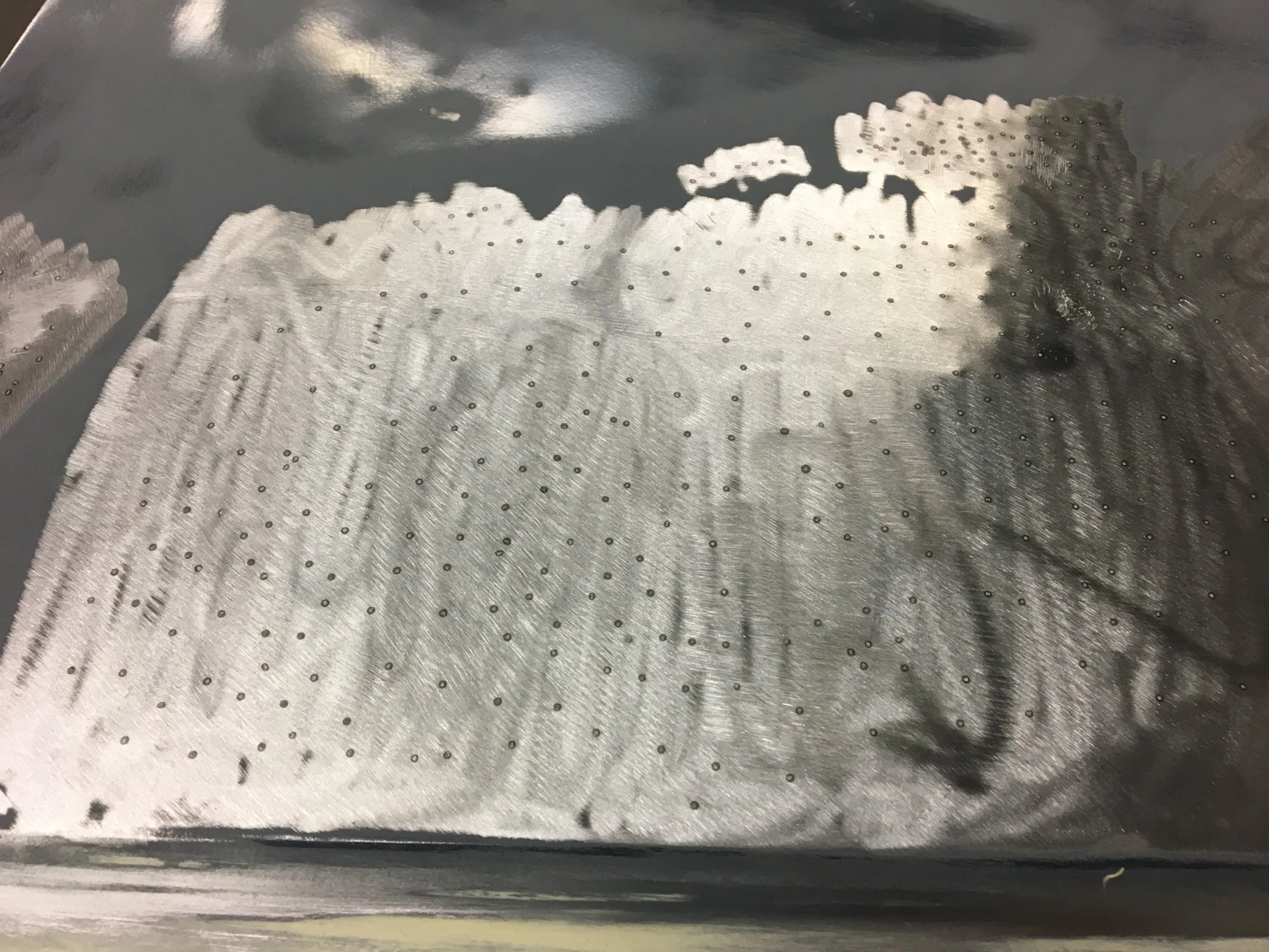

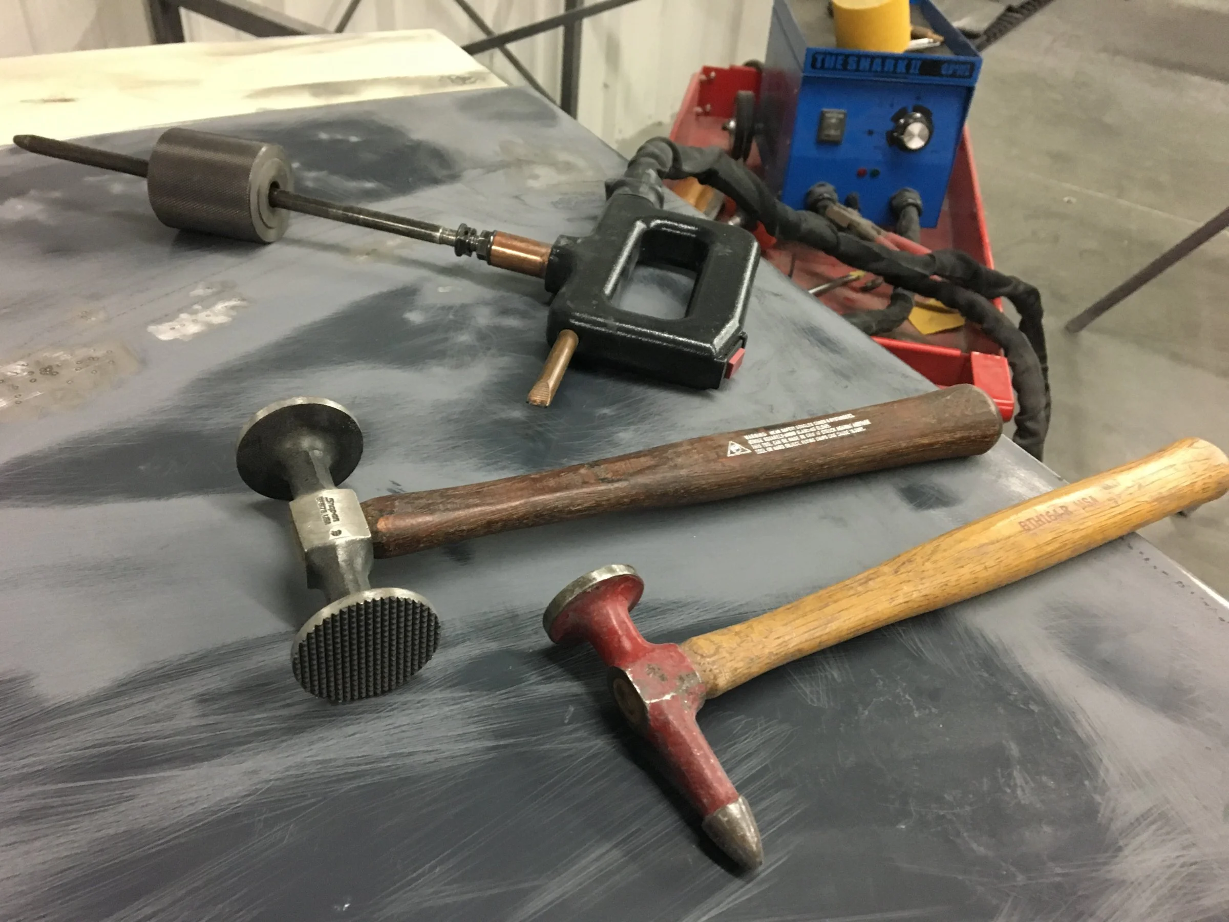

Here's a little progress with some of the tools I'm using.
The puller is a great device, it's used similar to a nail gun except you don't tack on studs. It has a magnetic ground that you put on a bare metal spot close to where your working and using the long electrode end, you press the button and it tacks itself to the surface. It has a small slide hammer on the electrode that you slide up against the handle to pull out the dent.
When you have high spots, you use the smaller electrode and turn up the amperage and it shrinks down the metal.
First thing is to grind off all the primer and make a nice clean metal surface. This is just like welding, you'll want the area you're working clean of all paint and dirt.
It takes a lot of hits to shrink up the metal as you'll see in the third picture. You go in a circular pattern starting on the outside of the stretched area and work concentric circles heading toward the middle. It took maybe a hundred and fifty whacks with the puller for this one dent. But it's fast, I might spend three or four seconds on each pull.
That area feels very tight and solid now. Now I can commence with the hammer and dolly stage to flatten the small dents out. I'll use a metal file to knock down the little tips left from the puller and give it it's initial straightness before slinging mud.

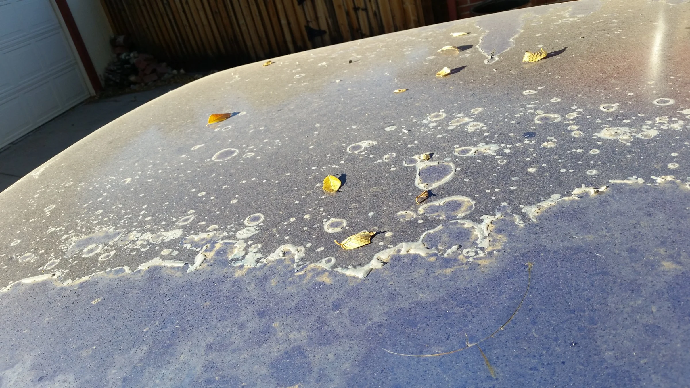

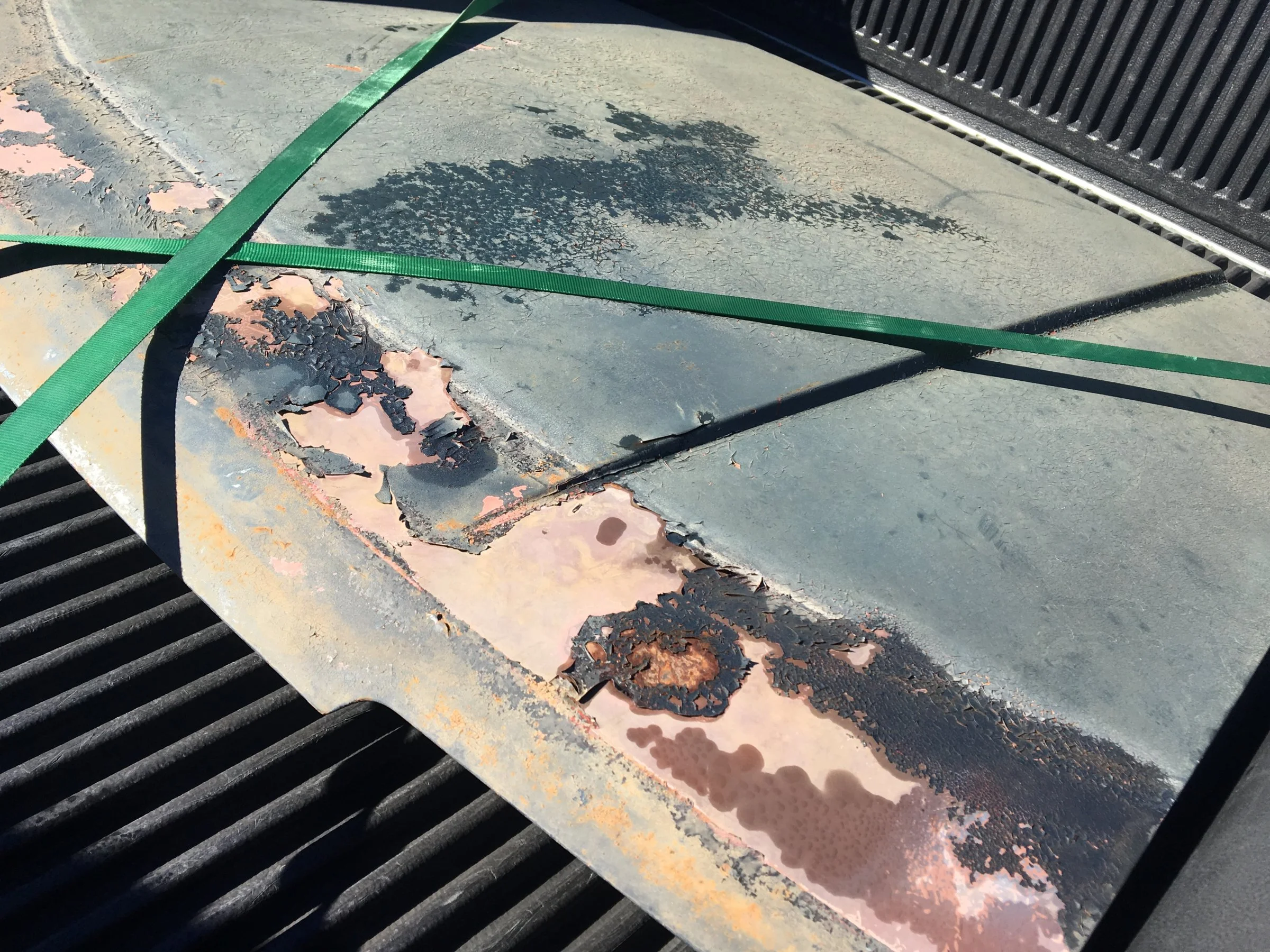

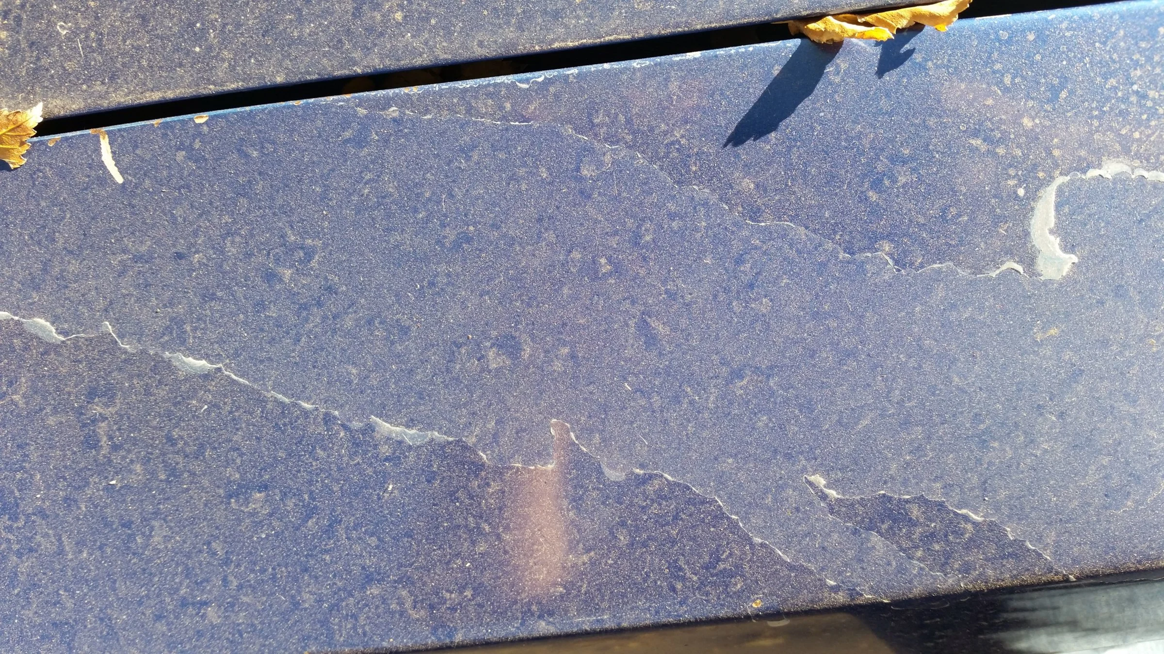

Kind of yes and no, depends how long the paint has been delaminating.
If it's been awhile, the base coat underneath the clear will absorb various chemicals from the air and gives you an unstable base for your topcoat.
Generally, you can feather out the peeling clearcoat and primer the area similar to what you would do with a repaired area. Allow it a few days to harden and shrink back, then block it out and continue with the rest of the refinishing process.
The only problem you'll have is the shrinking back off the materials you spray on the car. After a week or two you might see sanding lines or a ragged circle imprint if you refinish it too quick. The trick is letting the primer shrink back as much as you can. If you can let the primer sit for a week before sanding it, or more, the better the end result will be in the long term.

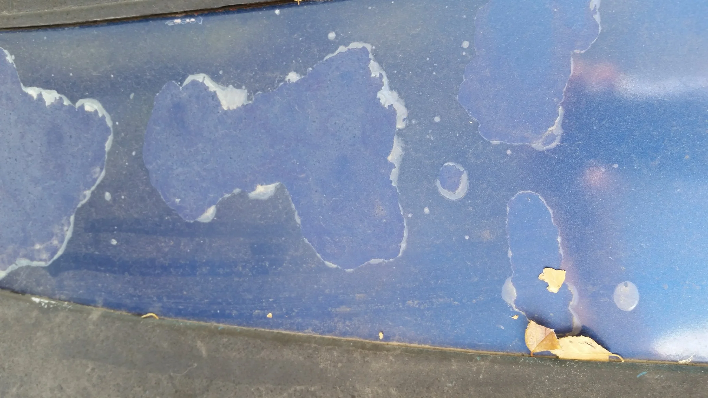

Post a picture of your problem, i'll tell you what i would advise for your situation.
Sorry it took so long to get pics but here they are...
It will need to be stripped.
The problem with large areas of delamination like that is that the underlying basecoat has had time to soak up crap in the air and rain. You would have bad results trying to paint over that.
Thanks Dave. In your experience, what would you say is the best, easiest way to strip it? I'm not looking for a show finish but I do want it to look decent. Maybe I'll paint it that blue you painted. That paint was pretty awesome.
You can use a DA sander with some 80 grit.
Chemical strippers are an option too, you'll just need to be careful with them. If you want to go this route, ask me specifically about it. It's kind of long winded.
Of course there is the option of a media blaster. Just make sure THEY'RE NOT USING SAND:dammit: to blast the paint away.
