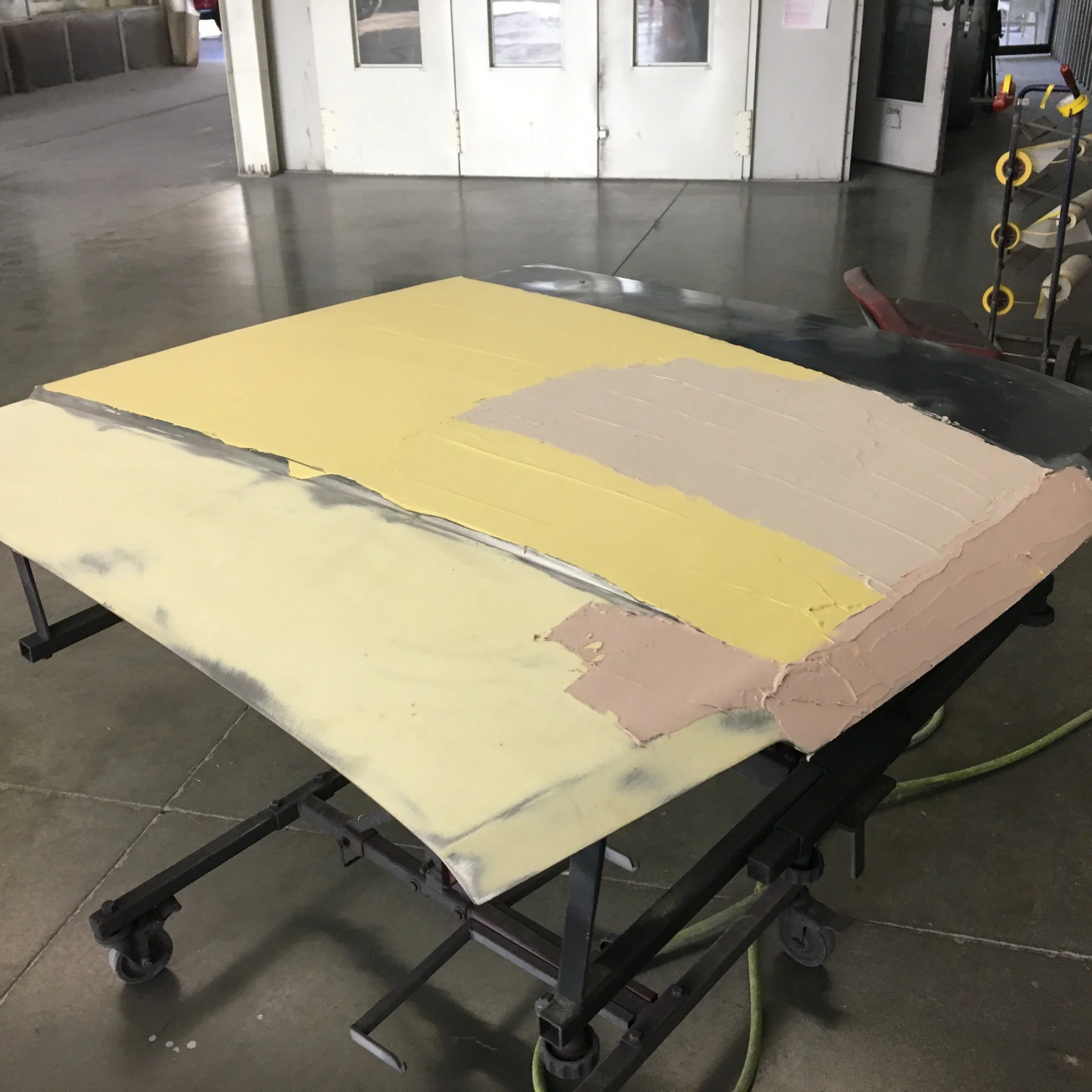

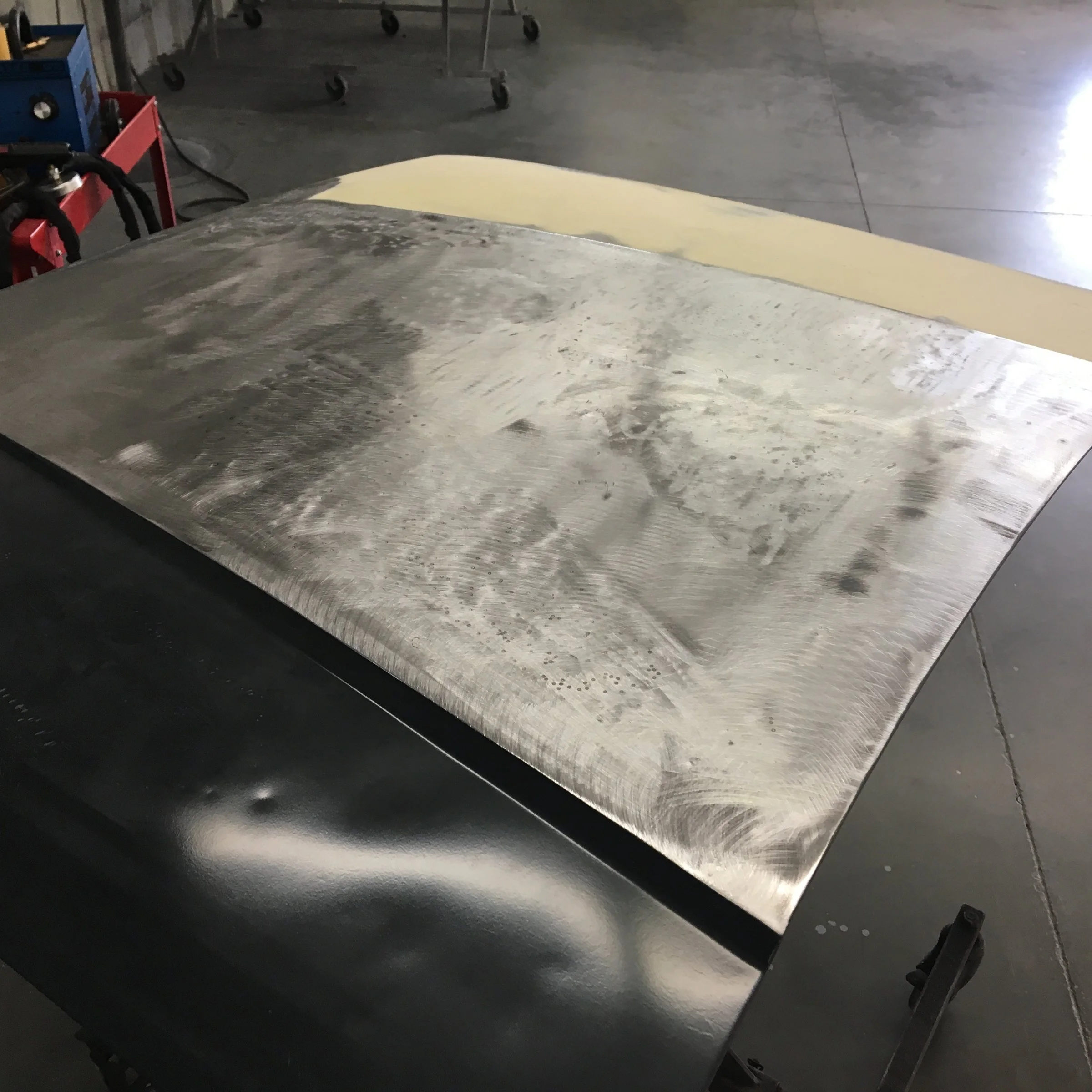

i finished pulling out all of the stretched metal in the middle of the hood today and spread out the mud.
Pictures are of the finished metal work and mud spread on the hood. Two colors of mud because the second gallon i got had a different colored hardener. works the same, just a different color.

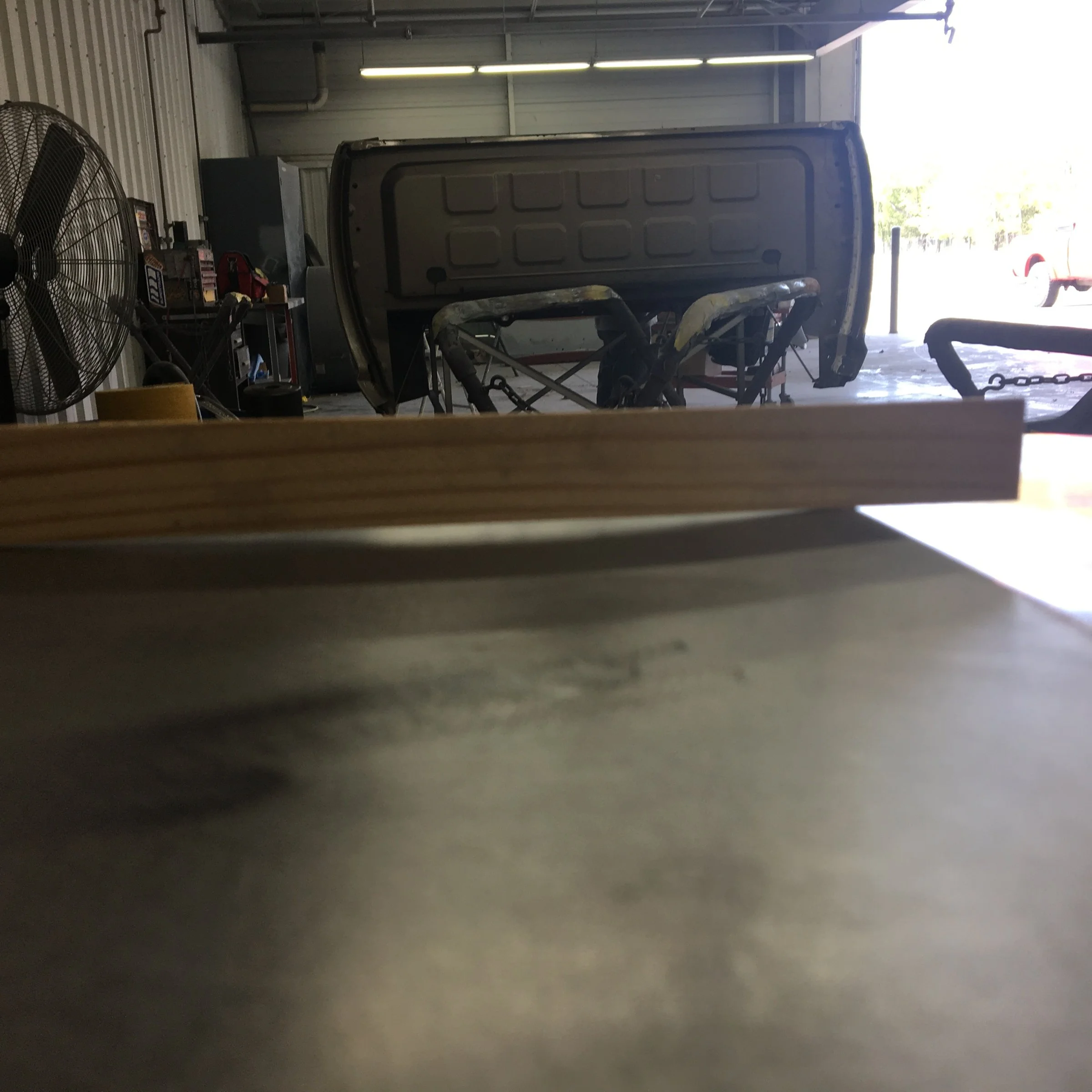

The second picture is a paint stick laying over the left side dent
/warp caused by the sand blasting. That is bad, i showed it just to show how far down the warping is. Look at your hoods and see the difference.
Yes, it's a lot of mud.:dammit: I want to put a GT hood on my car someday, so this one will last long enough. I did get it pulled straight enough that when i sand this down there won't be a lot left.
You sir, are going to make a lot of Dust :-)
Reactions: Davedacarpainter
So, you gonna block that by hand? Air file? Knock it down with a da then block?
Knock off the rough sht with a DA.
Air file.
Block that much bondo by hand!? Aahhh!
Once it starts to feel close to what I want, then I'll switch over to my hand blocks to finish off this first coat.
I had been rubbing my hand over that hood for a couple hours by the time I decided to put on the mud, so I think it was straight enough for one layer, but I lose sensitivity in perception of the feel of it after that long as well. Hopefully it'll just be a couple small patches that will need attention.
Then a glaze coat to fill in the pinholes that will surely be there in my work.
The second can of bondo I opened was a little older and much stiffer. It wouldn't spread real nice. But it was about 5:30 and I had to get to my son's football game. No time to go rob the bodymen of some of their bondo....
