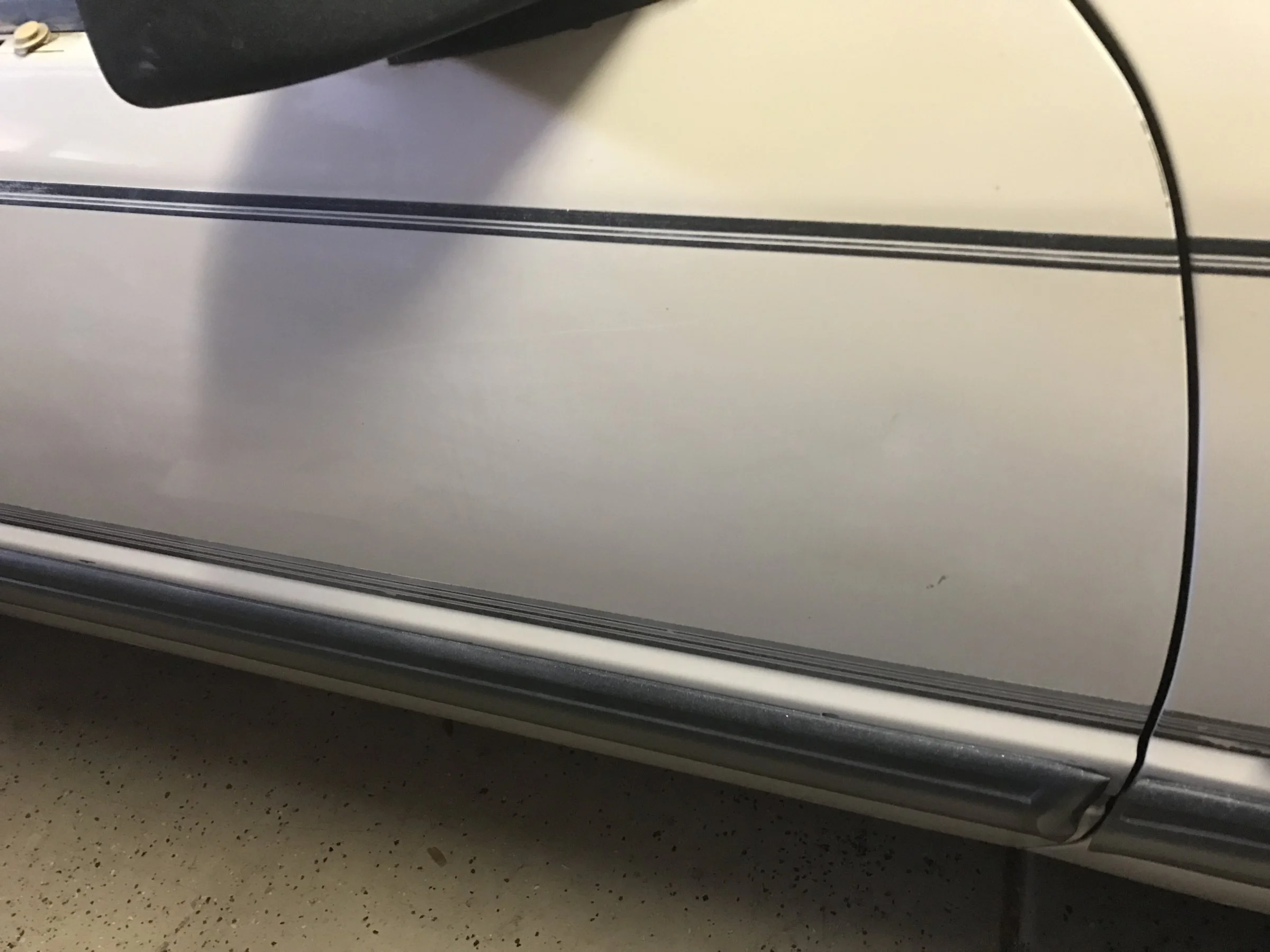

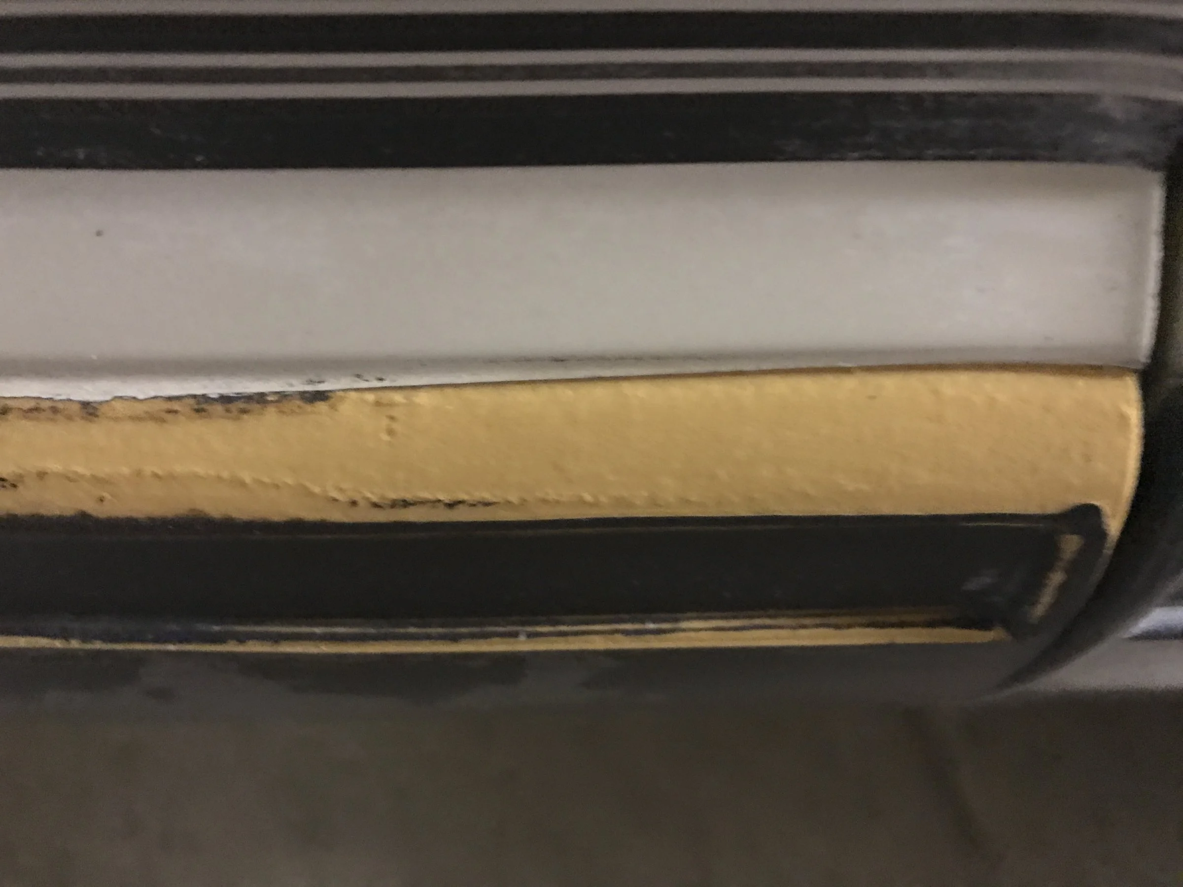

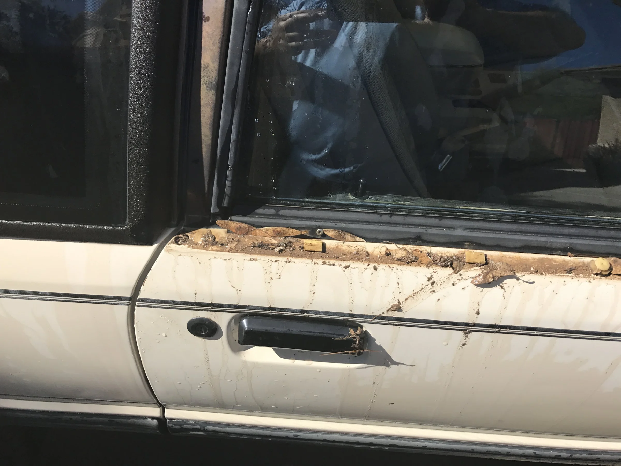

Post a picture of what you mean by, "the paint is all crap" if you would please.
This photo is just to show the clump of crap under that door molding. It was awesome. Going with new moldings anyways.

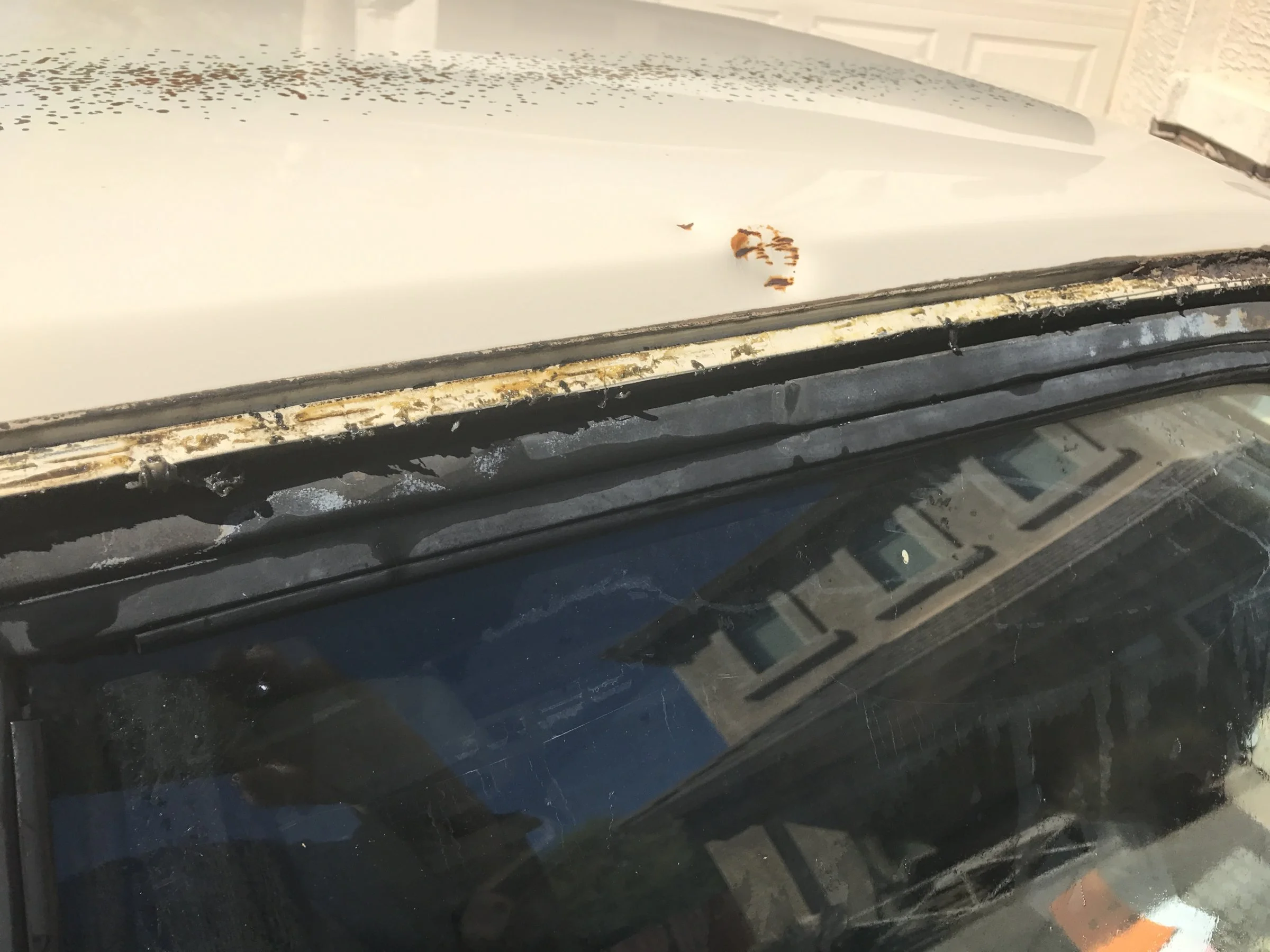

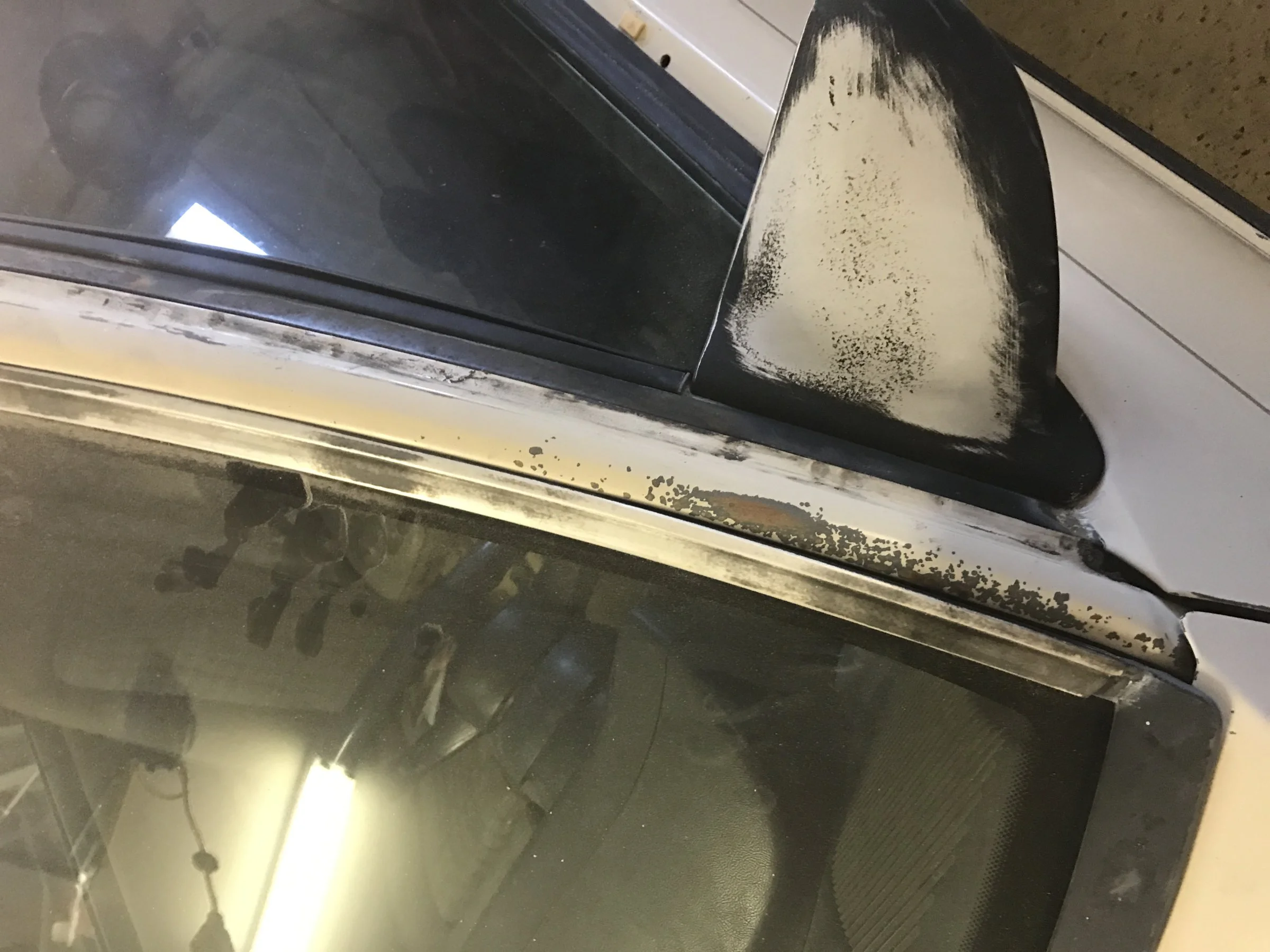

In this photo you can kind of see where area toward the center of the roof has a line of paint chipping or missing. it has areas just like this on several areas due to the intense heat here in Az and the car being parked for so long. When I hit the hood with a da some paint would stick and then there were spots where it basically flaked off. The primer underneath though took a good beating to get off which was surprising.
Yeah Jon, I would strip that roof if it were my mustang. If other areas are like that, get rid of the paint. Probably will just be the top surfaces, so, like the fenders, just strip off the top. There's no need to do the sides unless that goes down there.

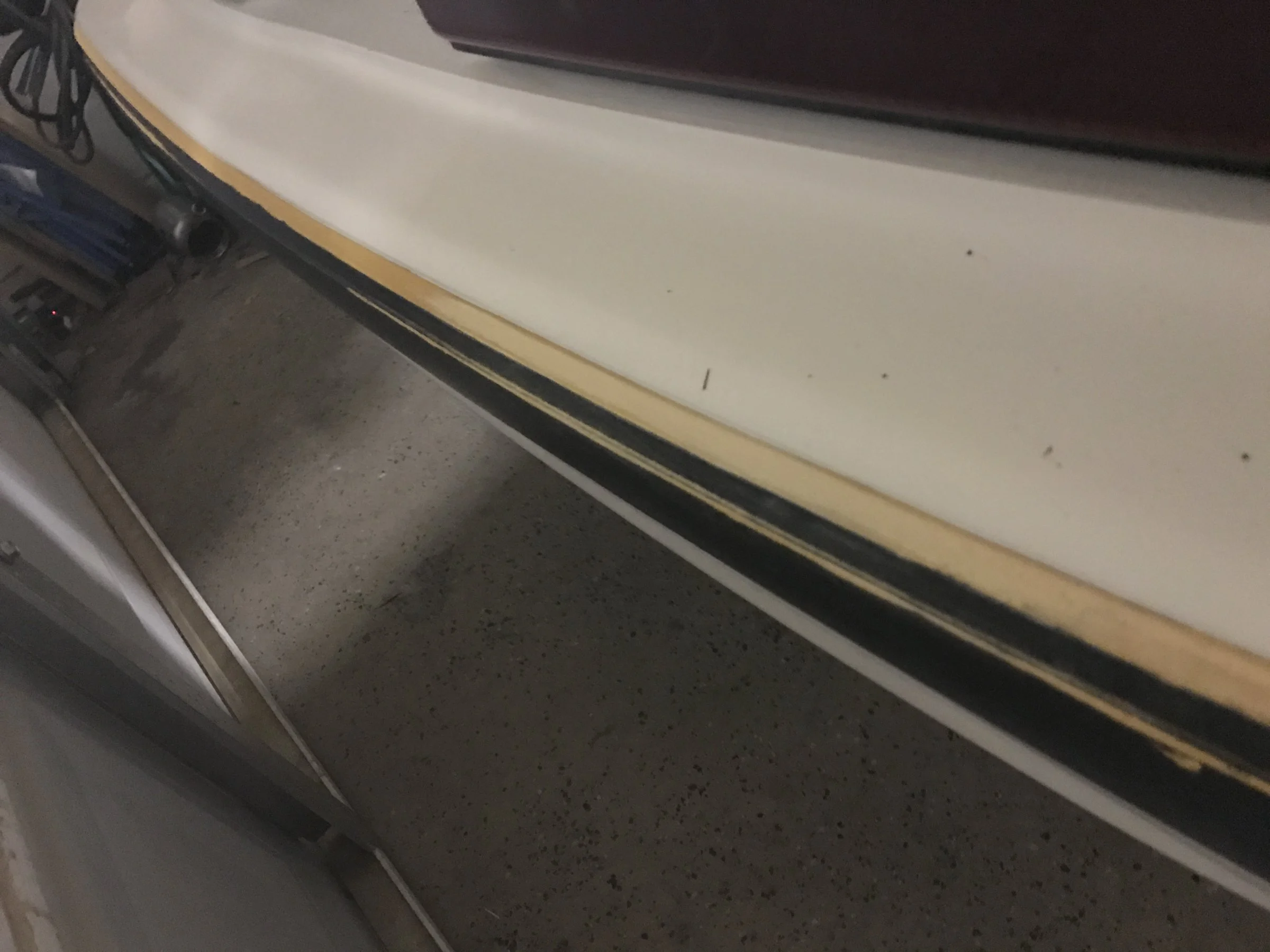

The other issue is these damn decals I tried to peel them off but they are so old and nasty and have to be scrape or sanded off which goes into taking them down to metal. Of course the sides have two stripes too and bottom.
You can see in the second photo how sun just ate these A pillars. Window moldings coming off this weekend.
Old stripes suck. Eventually their glue eats into the paint.
You'll want to strip the area where the stripe was and primer and block it or you'll see where they were when you repaint.
You can get a stripe removal wheel to take off the stripes. There are two kinds.
One is solid and is essentially like a big eraser. It's more aggressive and will likely eat into the paint.
The other is a stack of soft floppy disc.
You mount either one to a drill and run it along the stripe, they're really handy and quick. You can have all those stripes off in twenty minutes.
The a-pillar looks in great shape other than the paint. That's good. Just surface rust there.

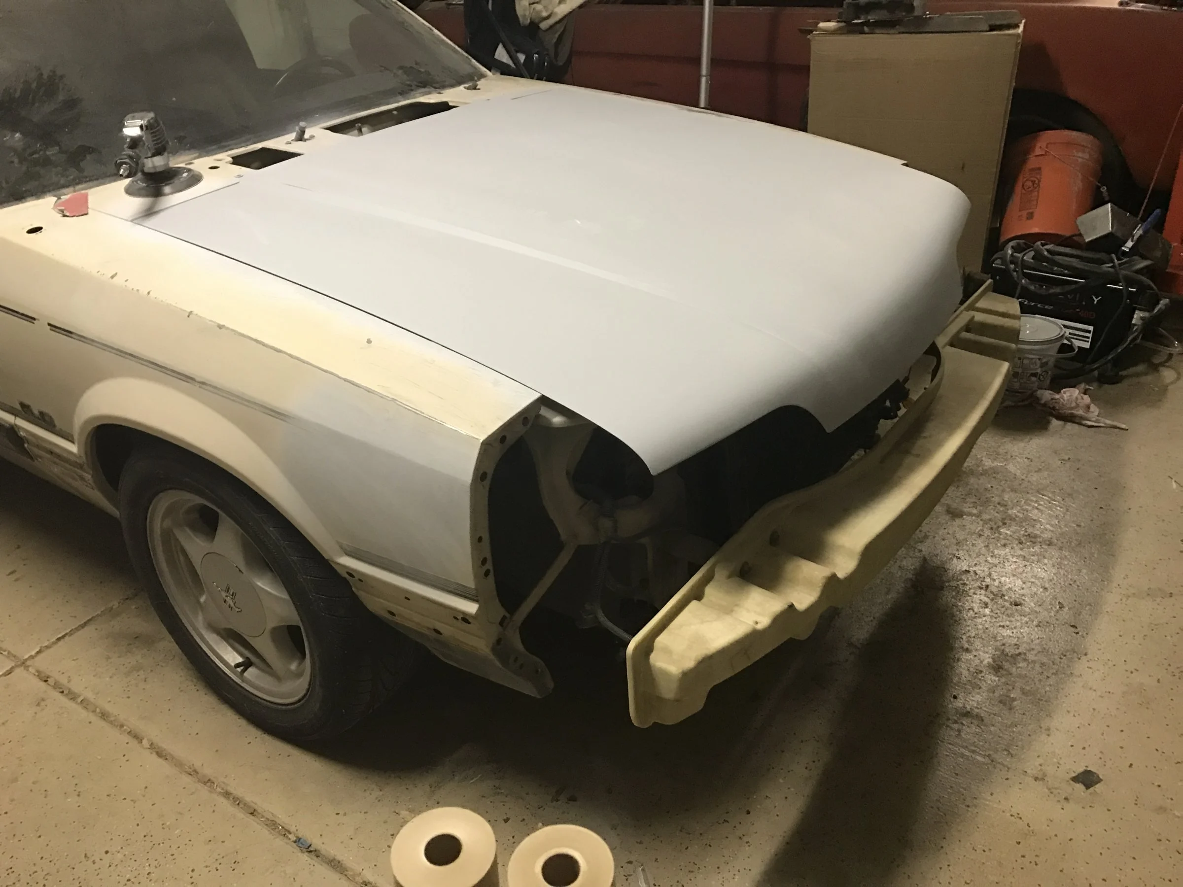

Finished taking a lot of trim off and to start working on both fenders. Arizona heat takes its toll on plastic and rubber. Both lower windshield trim pieces broke at the tabs. The rear bumper is pretty shot. Probably be better to grab one in decent condition and ditch the old one. Here is a pic of it:
All that yellow used to be black and sands down to a fine dust. Not sure it is worth saving and working.
