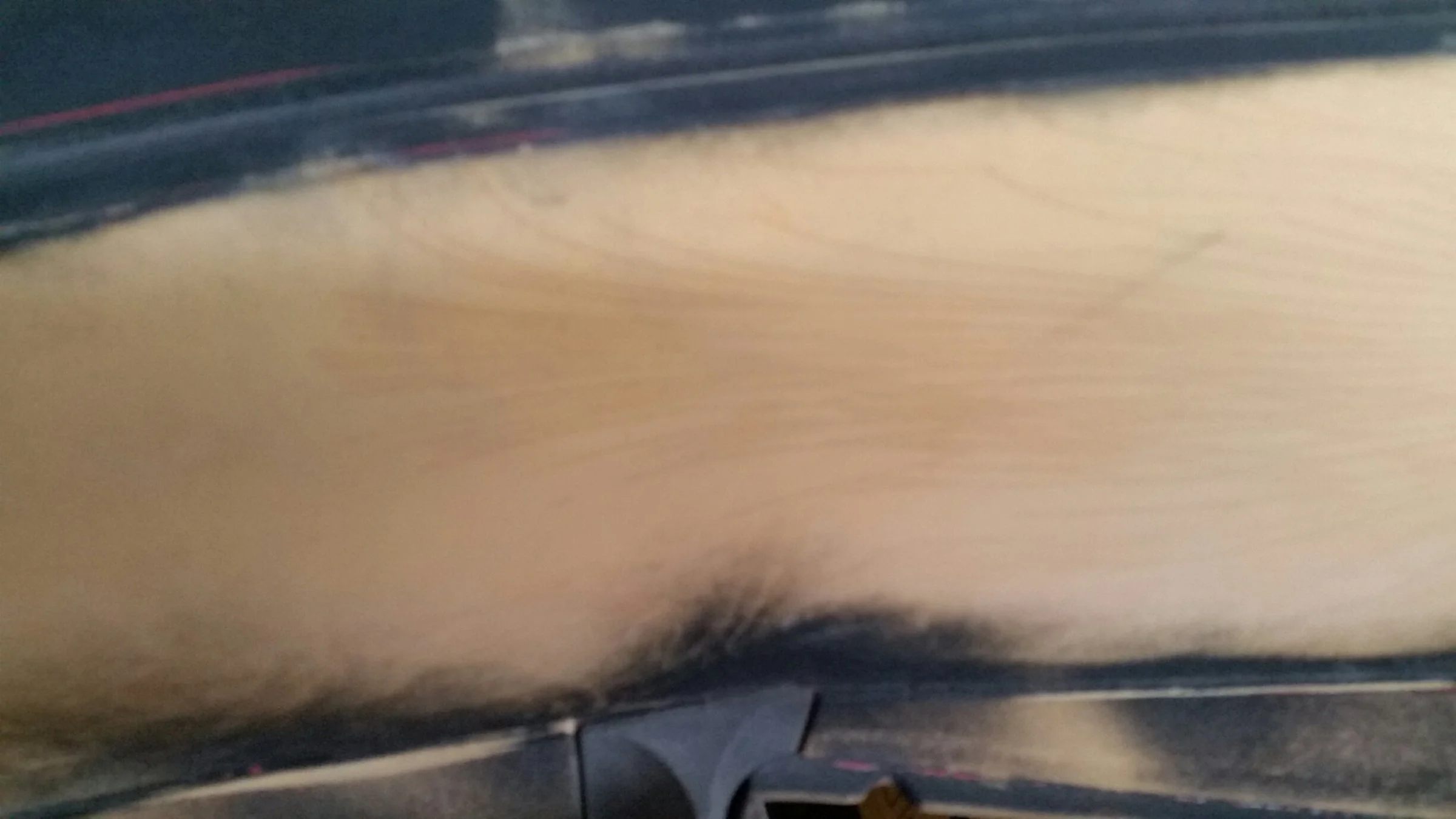

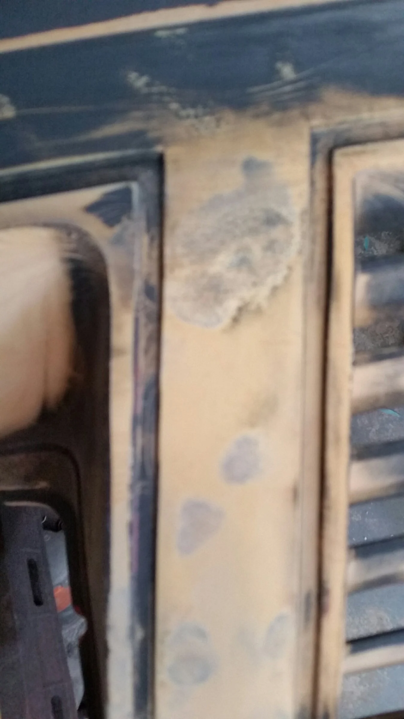

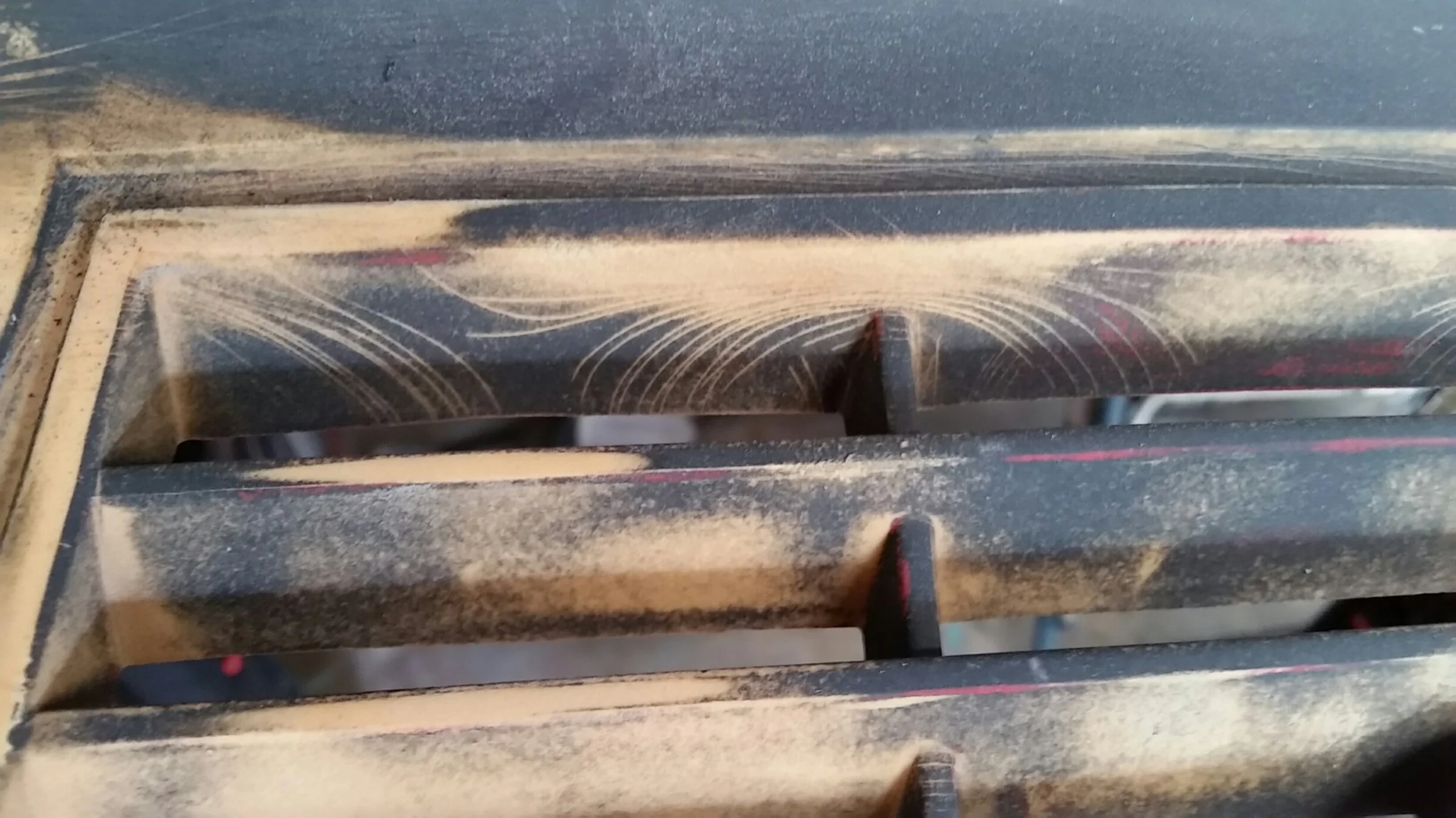

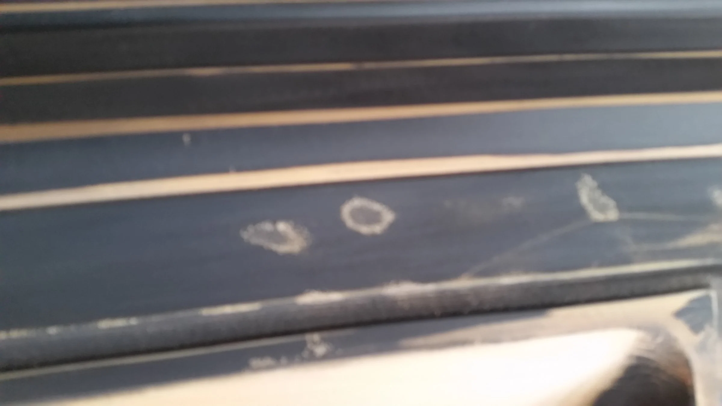

@Davedacarpainter, these are the best I could do with my retard-phone

@davedapainter, Most of them did not show up until I media blasted the bumper. I'm jumping on plane this afternoon, but should be able to do that this Friday or Saturday. I appreciate your help on this and the advice you've given to the others. Nice to know there's someone we can get good advice on, instead of opinions.

Sure Jim, if you ever need to talk through any repairs, PM me and I'll call you so we can talk through it.

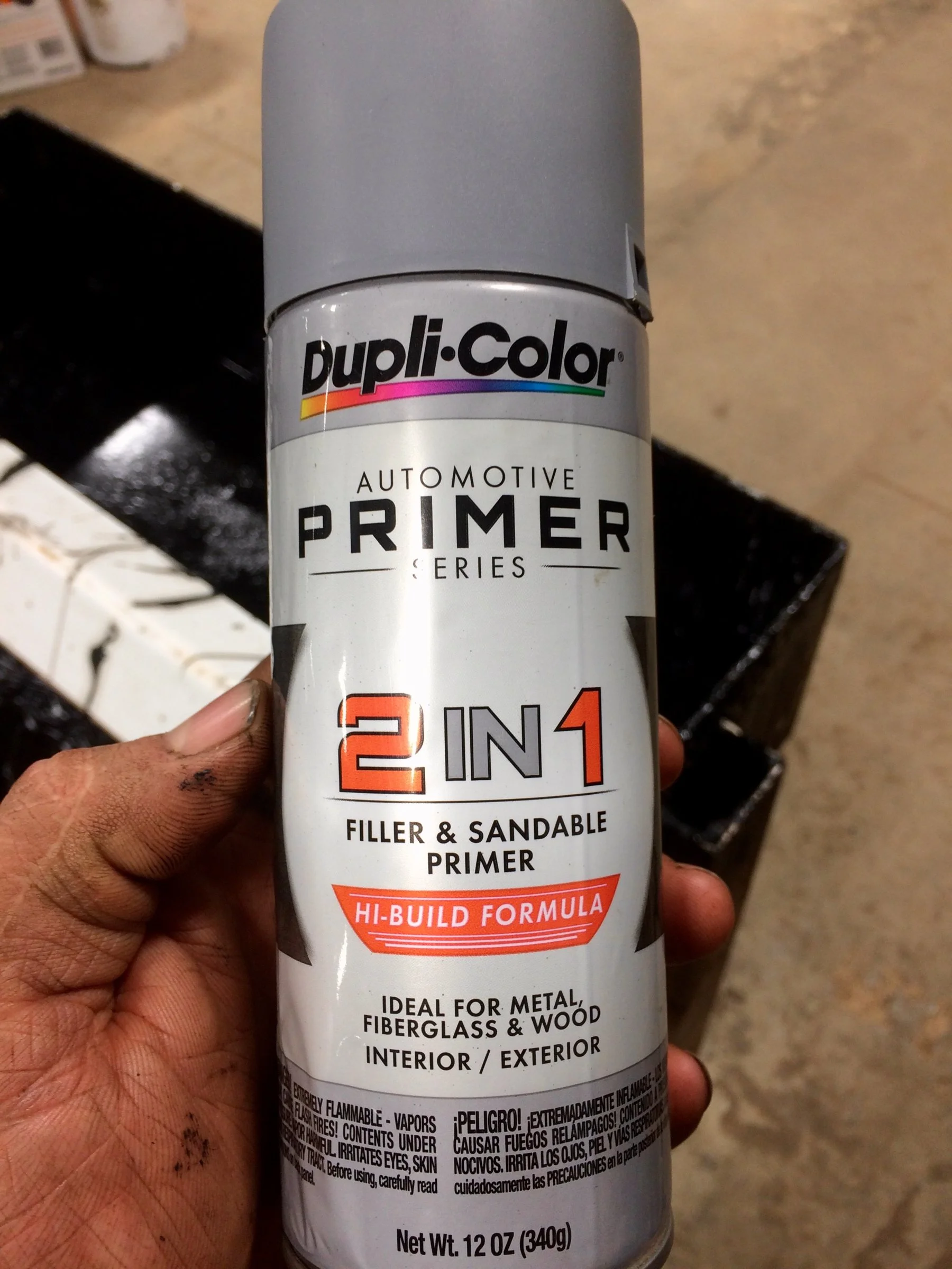

So it wouldn't be good to spray over bondo?
It would be ok except for the filling needs. If it's in a rattle can, it'll shrink up horribly.
