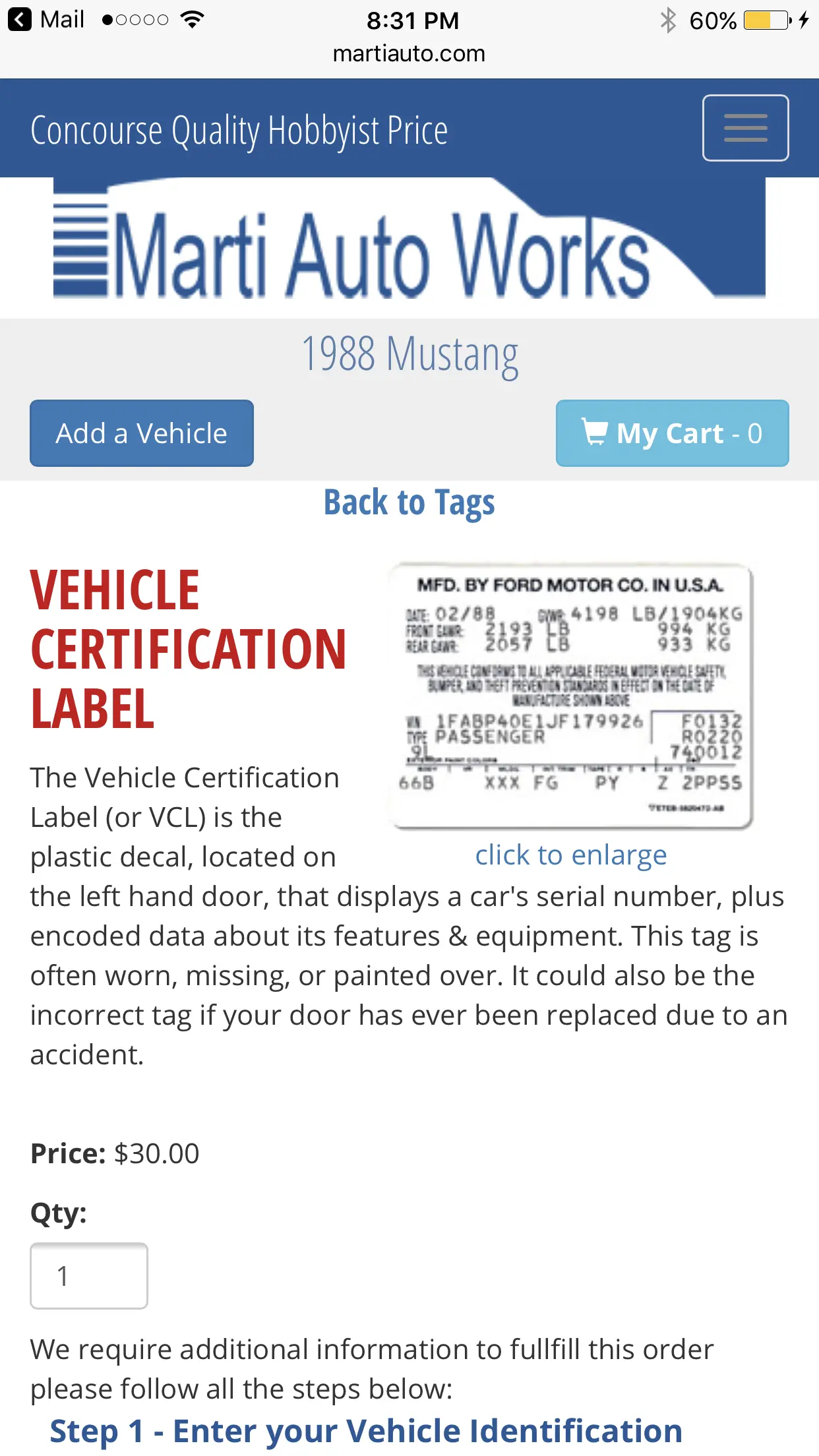

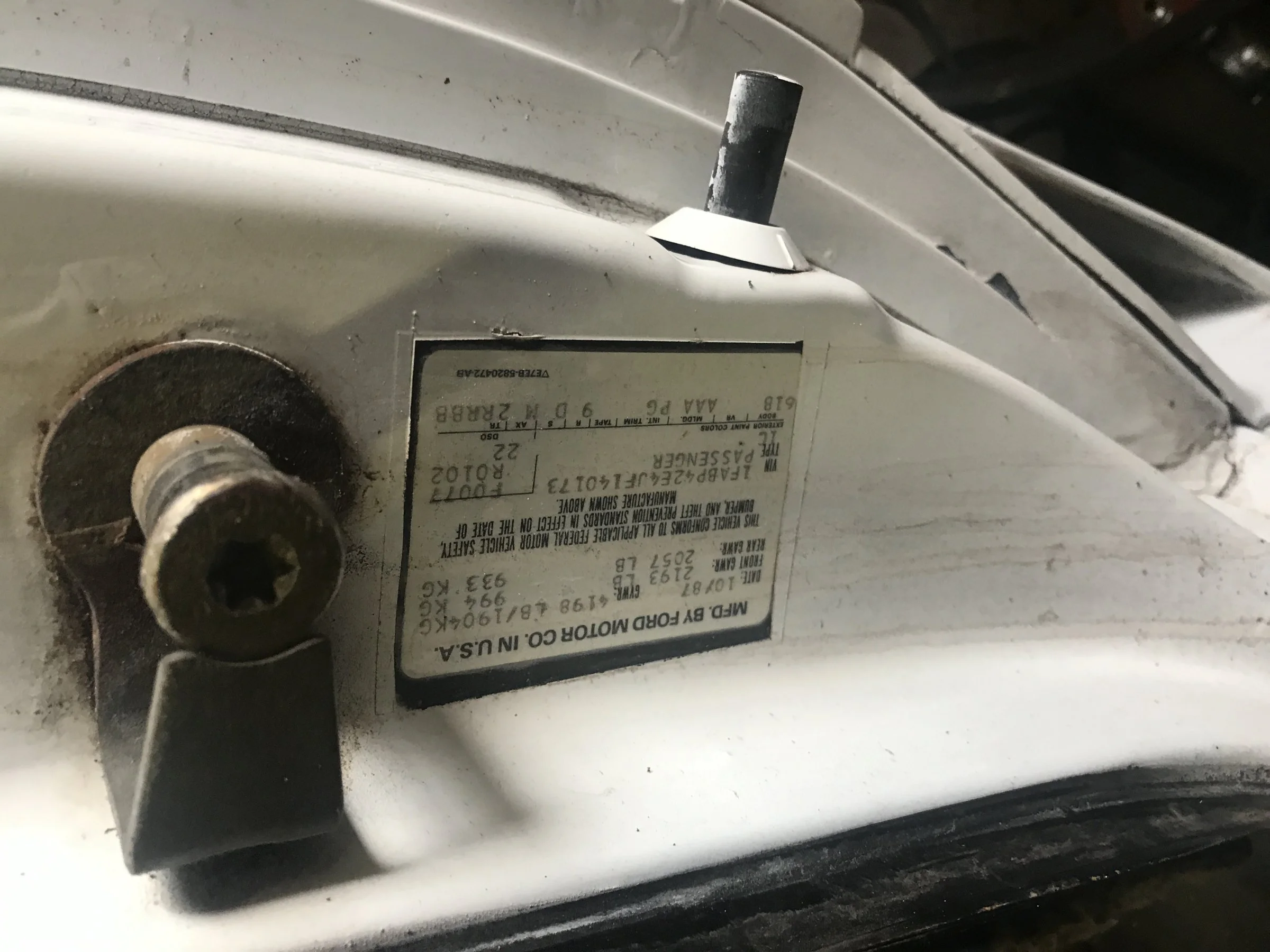

Hey Dave, any advice on saving my door tag? It was partly painted once already. Dunno if it's possible to remove and reapply or if I gotta find a replacement
in for answer on this as well

I know there are companies that remake ones for us at the bodyshop when we replace the panel they are attached to.
I'm not sure of their names though.
Does Marti make these as an option when you get a report?

Looks like

If you can pull it off it will show void
Marti has repros

Guess I'm adding a little more to the budget.

30 bucks isn't bad at all. I know the shop management whines when I need to take them off to repaint a jamb. The modern versions cost more.

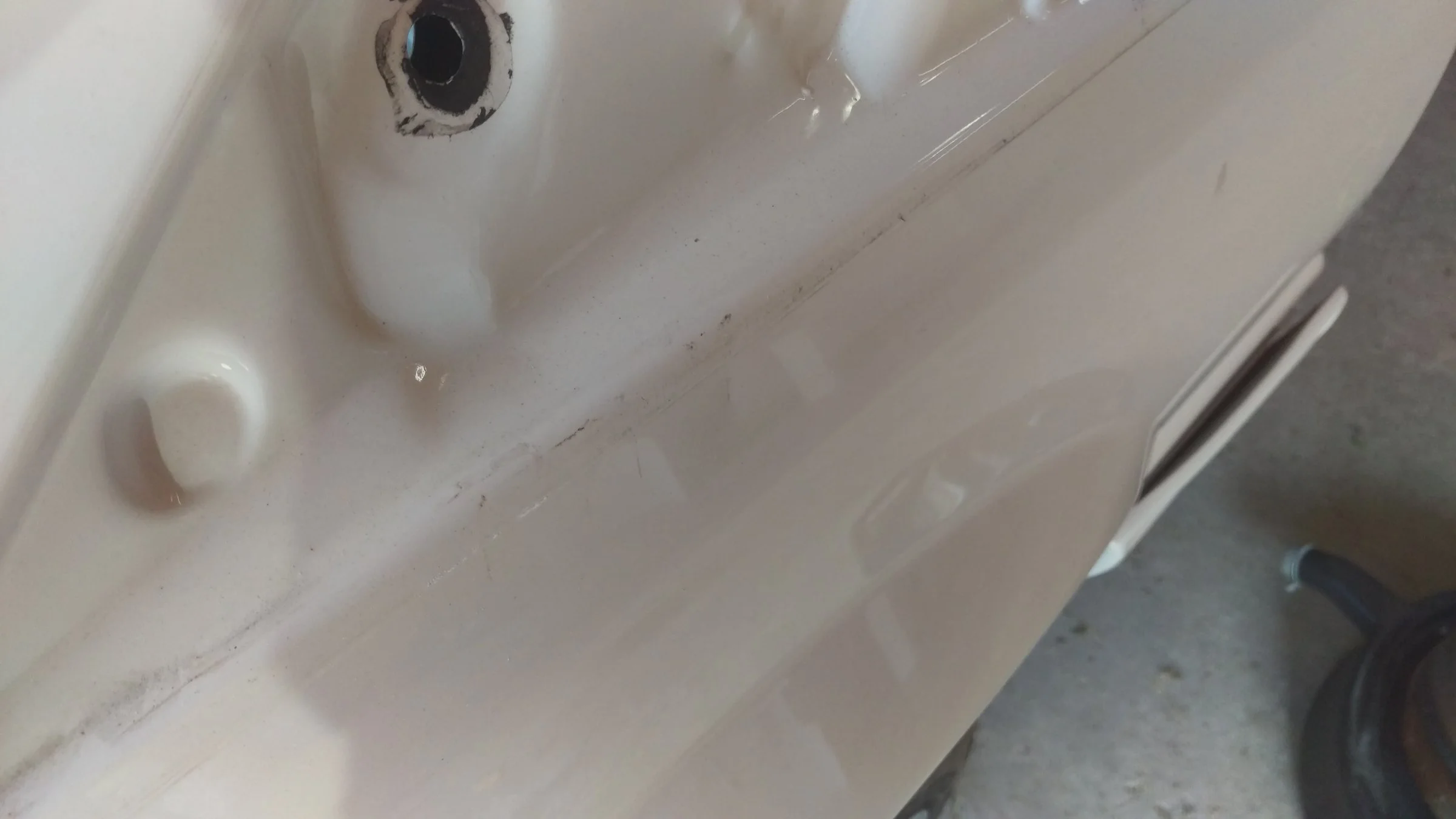

So for those of us hobbyist without a stud gun, how would you go around pulling a dent like this? (hard to see I know, small dent from prying with a screwdriver getting the quarter glass out).

What we used to do before the advent of some of these dent pulling devices is to drill a whole and use a slide hammer with a screw in attachment, then weld the hole back up.

That's about what I figured. I've got a rather large dent to fix in the drivers fender that I can get a dolly on (if I can't find a decent set of oe fenders), but no access to the backside of that little one on the quarter (and I really don't want to just bondo right over it, it is rather tiny though). Other than that the car is pretty much straight. trying to find the next thing I can do while I save for parts, and that may just be stripping the shell and epoxying it (since I have all the supplies to do that already)

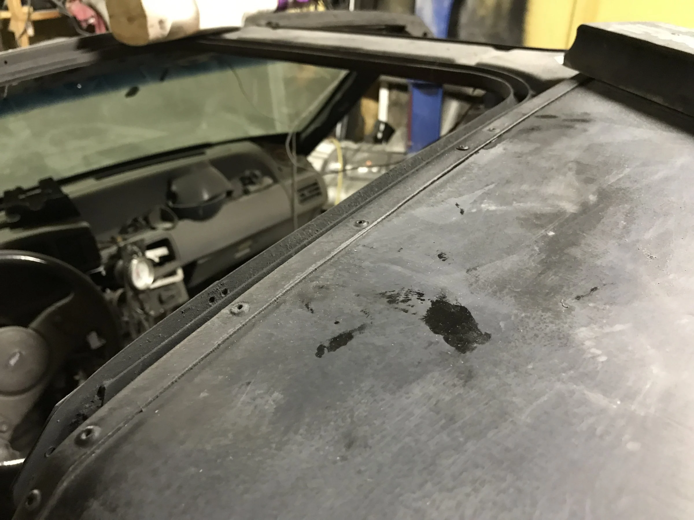

Here's one more for you Dave. Do I need seem sealer or butyl for where the t top frame meets the roof?
