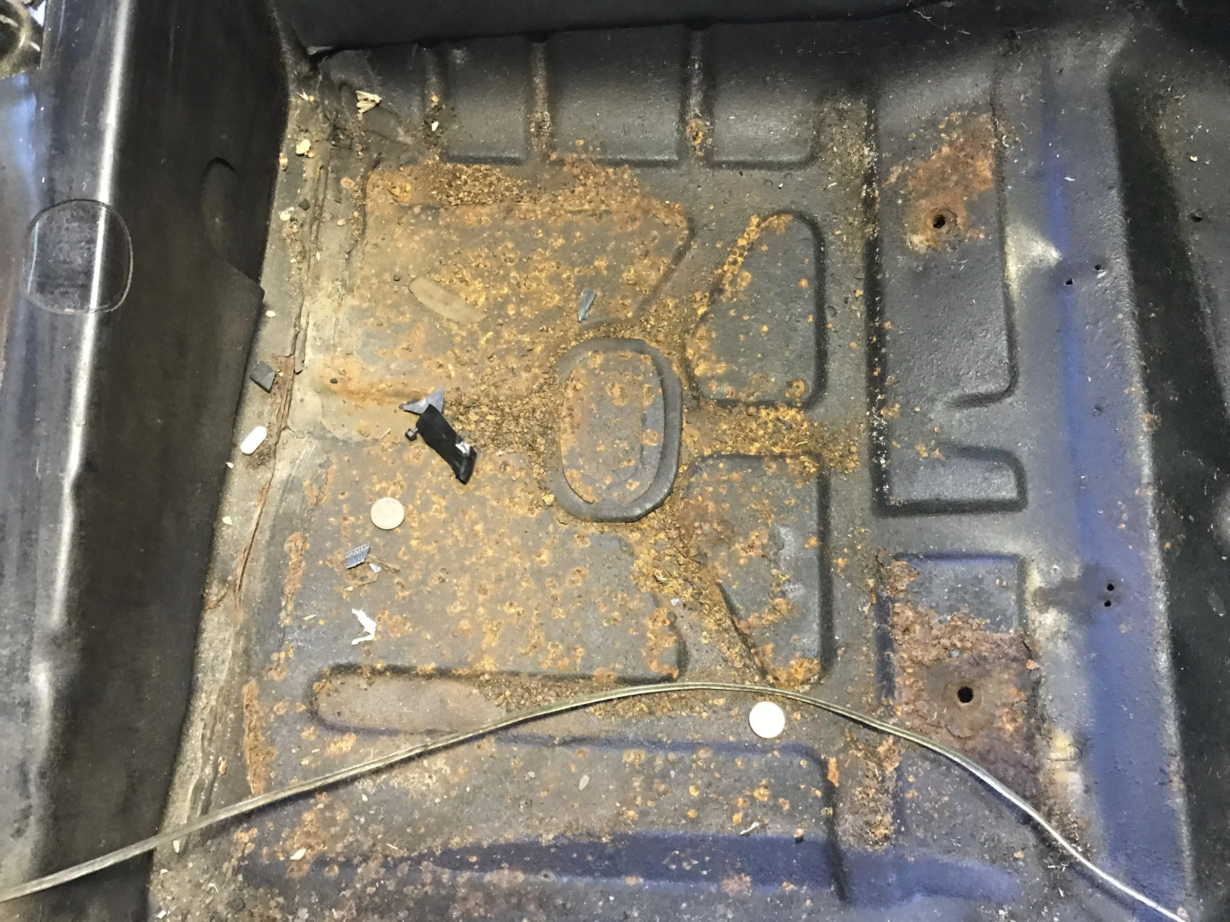

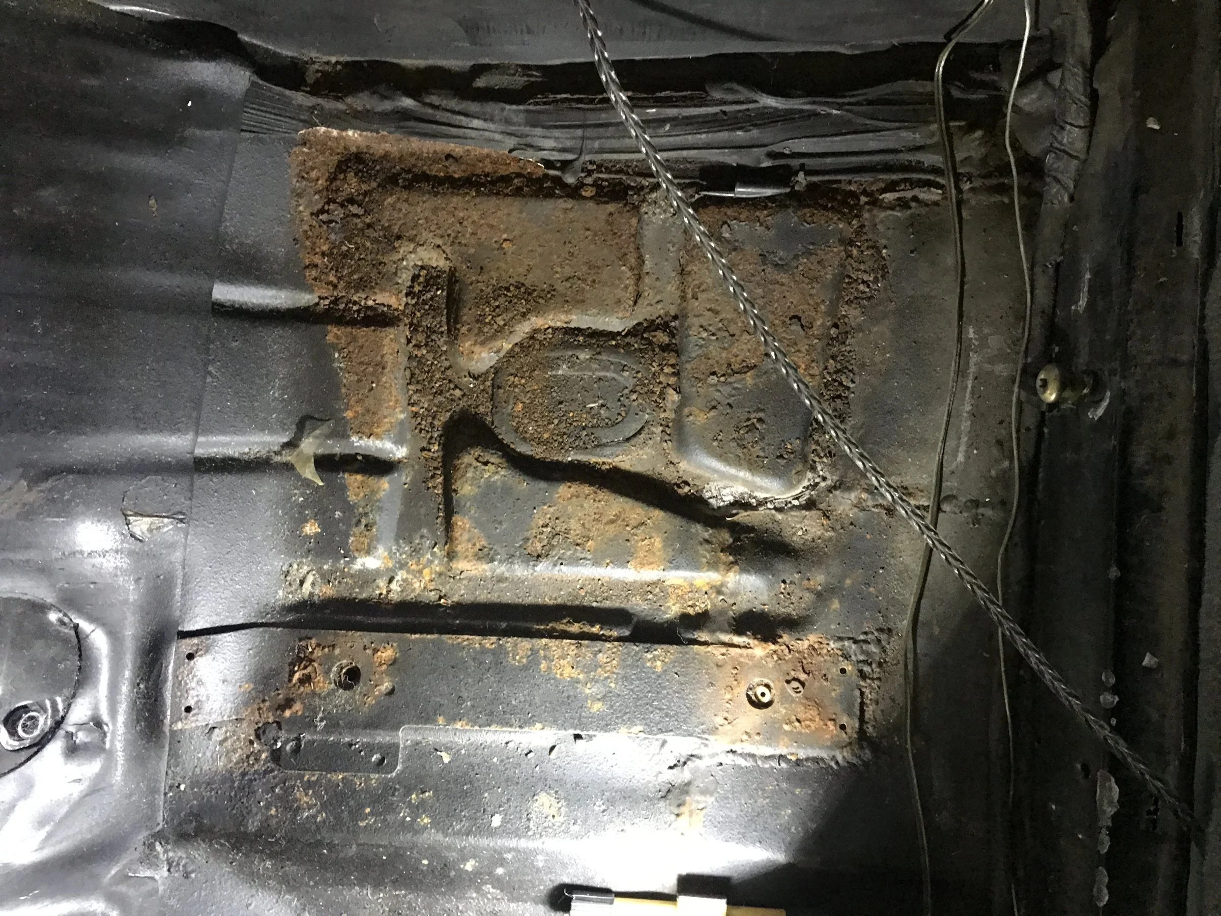

Hey Dave, found a small amount of rust on the floors of my t-top. Any suggestions for clean up before I dive in?
