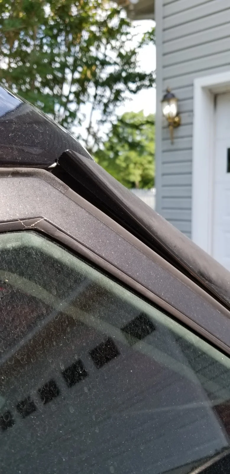

You could try a heat gun to reshape that. The problem may be that the plastic is drying out and shrinking up, it may not hold to the reshaped form. It’s worth a try though.

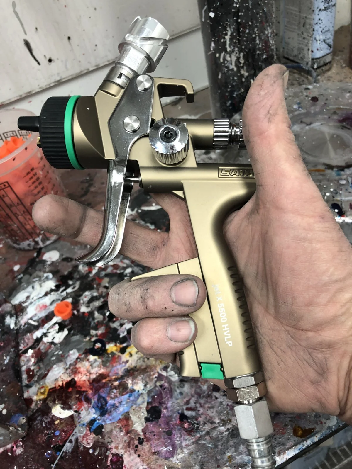

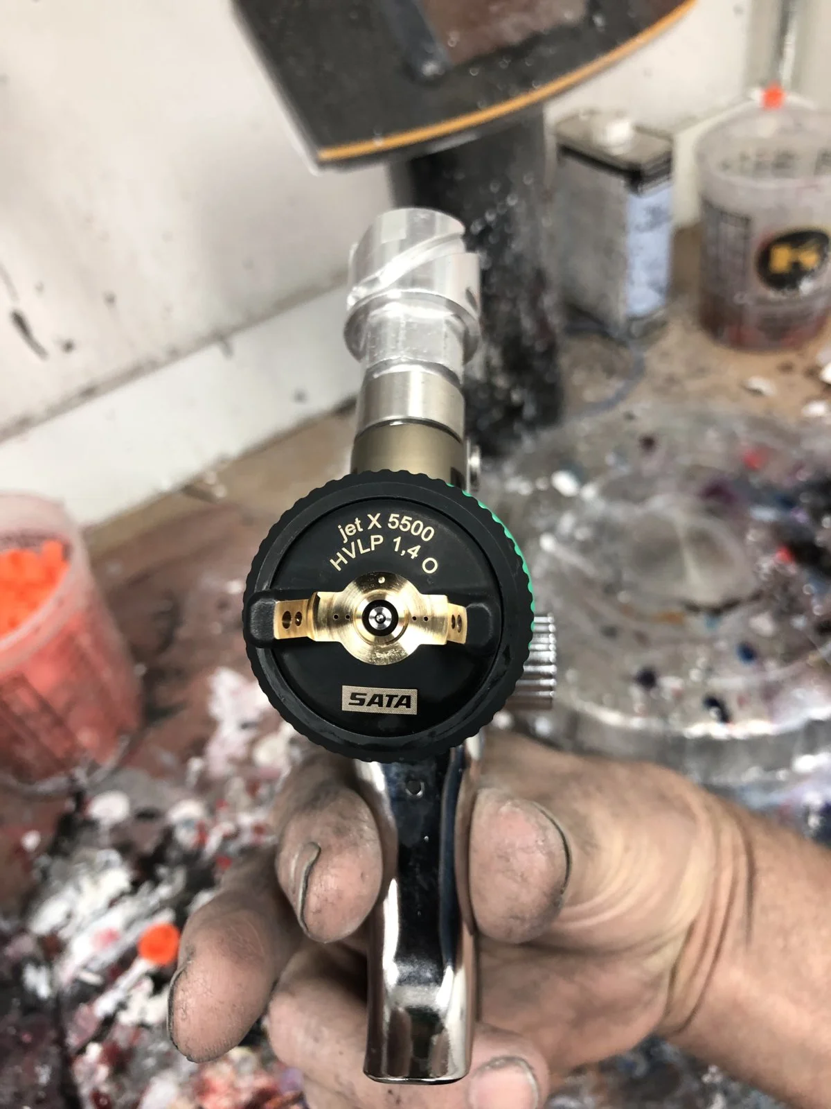

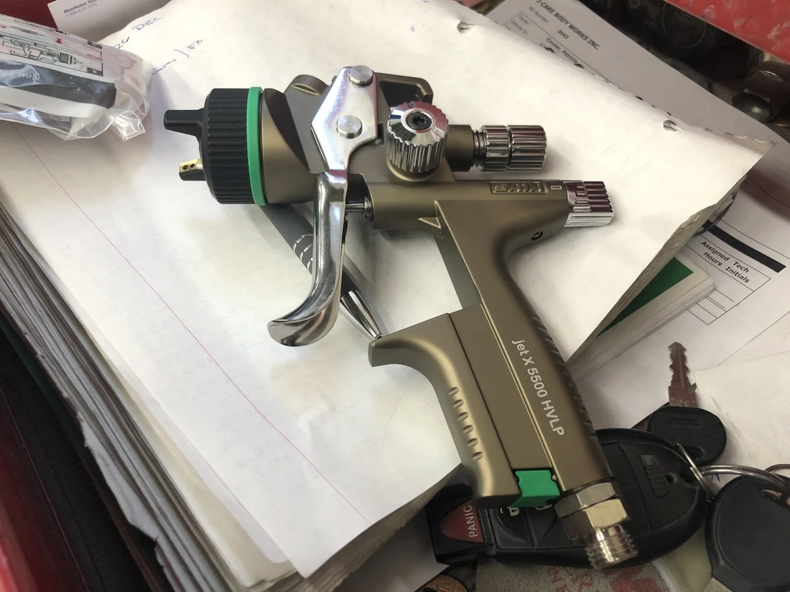

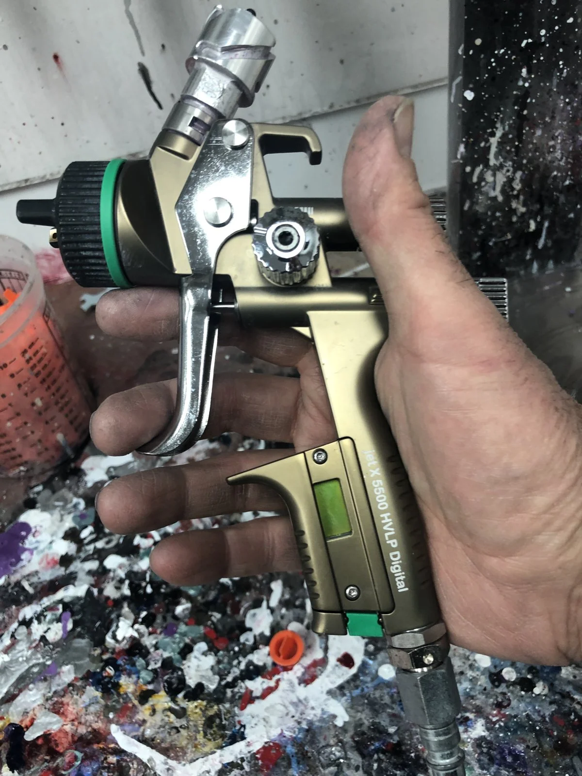

So I got a new paint gun.
I used to be a Sata man when it came to paint guns. Then about 13-14 years ago I switched to Iwata. I haven’t used a Sata since then.
Not that they were bad at the time. They shot about equal to the Iwatas. They just used a bunch more materials.
Just lately I’ve had the chance to use the latest Sata on the market. It’s a Sata 5500 with a 1.4 O tip. Plus, it’s an HVLP.
Sata’s first attempts at HVLP technology about twenty years ago were not terribly stellar. So I never looked at their stuff.
I tried this model 5500 with less than high hopes.
Boy have they improved! My paint jobs are coming out even smoother now. I’m very impressed. My Iwata’s are simply old technology now.
My boss gave me a brand new 5500 for Christmas! Woohoo!
Sata has changed things up with this new series. They offer both an “I” tip and an “O” tip. The different tips simply have a different spray pattern. “I” tips are great for base, and “O” tips are excellent for clear and solid base coats.
The catch? They’re expensive as hell! I guess not so much when the boss gives you one for free . Roughly in the mid $700s depending where you buy them.
Now I got to figure out how to buy one more for base coats. Maybe two more really. An “O” tip for solid base coats would be best.
Anyhow, pictures.

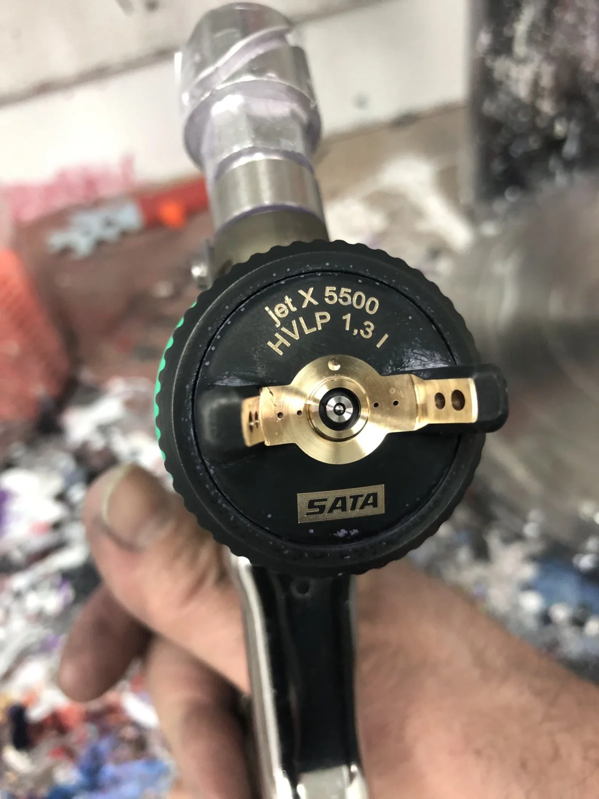

I’ve become so enamored with my new clear gun (that Sata 5500 above) that I had to try the 1.3 I tip I mentioned above.
Holy cow it’s a wonderful gun! It shoots metallics and pearls so well. Even large, difficult metallics spray with next to zero mottling. EXCELLENT gun.
I had to buy my own. This is now the most I ever paid for a new paint gun. With the built in air gauge it cost $950 with tax included.
Since this is what I do for a living, I decided what the hell. It makes me appear to be an even better painter.
I ponied up the extra couple hundred for the digital air gauge since the gun shoots solids best for me at around 27 psi and metallics and pearls at around 22-23 psi. It’s worth it when you use it dailly.
