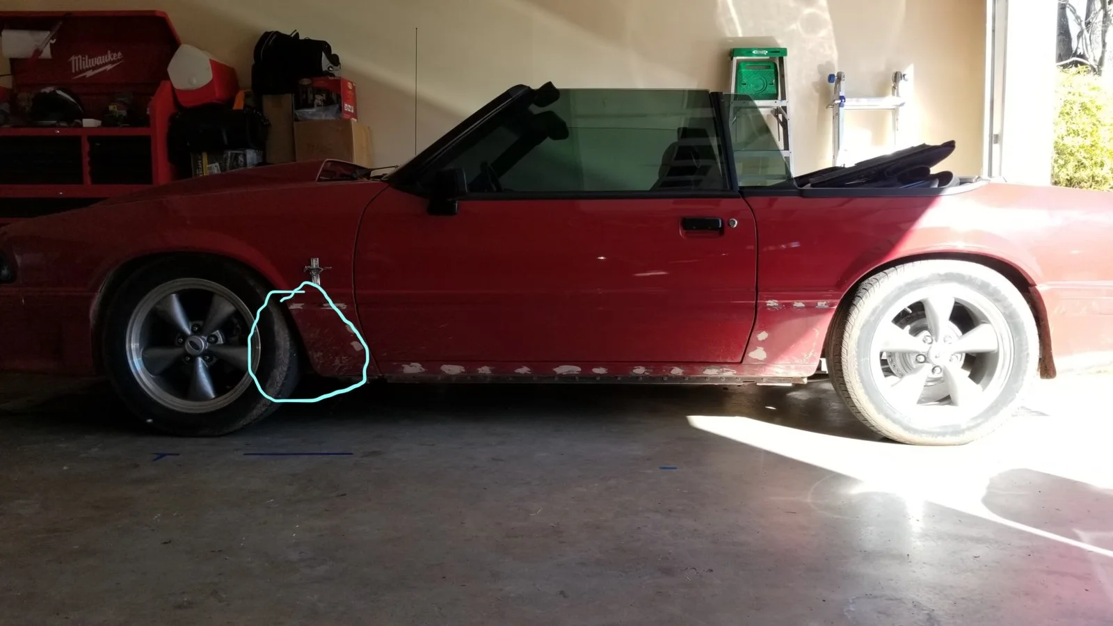

Reason for asking is my recently acquired '88 GT 'Vert had the ground effects removed and the spoiler/luggage rack removed and one of the POs tried to body fill the holes. I'm in for some work in that area.
I''ll have to find and replace the ground effects and the spoiler/luggage rack, but don't know when that will happen so want to make sure I take care of those areas until then. I'll get pictures in the sunlight tomorrow. It's stored in my garage, fortunately, so no direct sun/rain.
The rear bumper has the clear coming off of it, but otherwise the paint really looks good on the car. I don't know if it was resprayed at some point or spent nearly all of it's life indoors - is there something I can look for on the car to show evidence of repainting?

You say the clearcoat is coming off your bumper. This is technically delamination. Due to damage over an extended period of time from UV radiation clearcoats will peel, or delaminate. It's simply caused by the underlying base coat being broken down by exposure to UV light from the sun. Essentially the sun changes the base coat into something different from what was initially applied by the factory. When this happens, the chemical bonding that was there in the beginning between the basecoat and clearcoat is severed and the clearcoat begins to flake away. If this happens, you're stuck, the panel must be stripped of all paint. I'll explain that in more detail if you want.
Evidence of being repainted? Geez, lots of things.
Look for obvious variations in the orange peel from panel to panel. (orange peel is simply the texture of the smoothness of the paint) If it suddenly changes between panels, there's a good chance of a repaint.

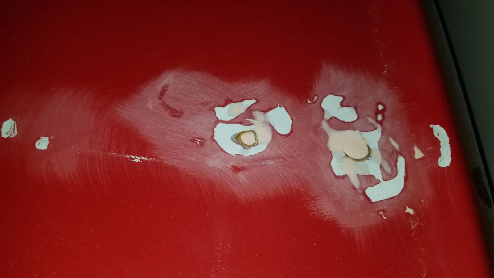

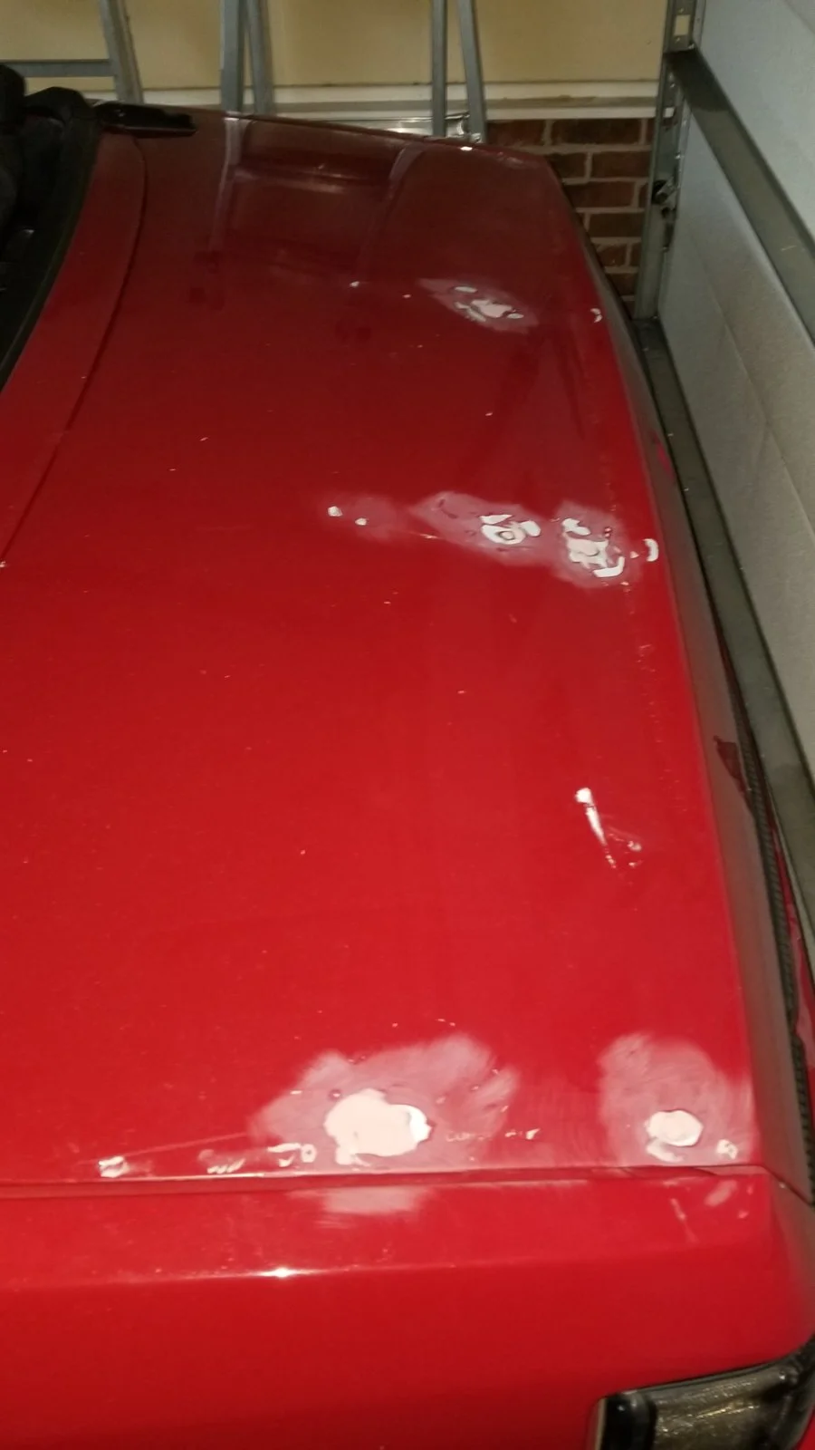

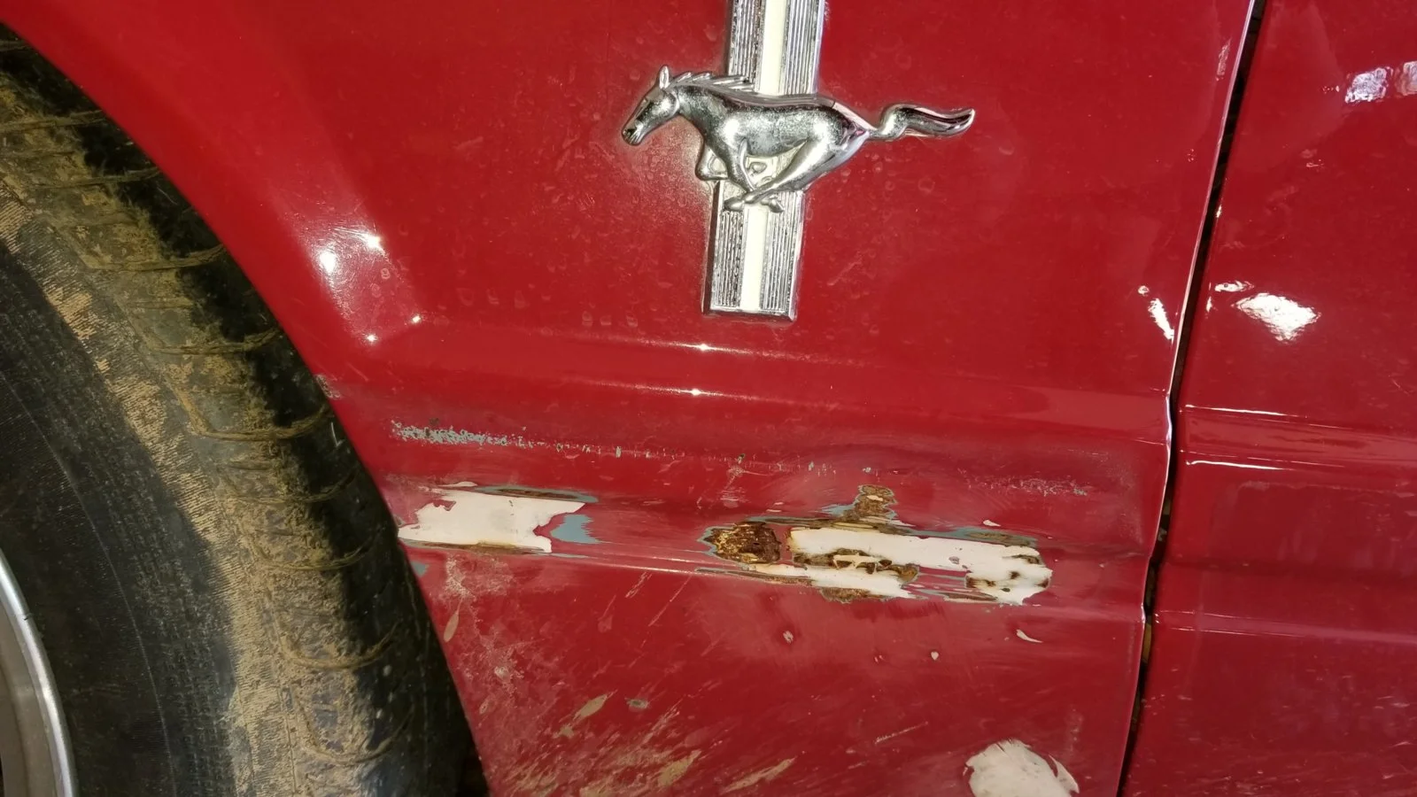

If it was repainted there will be a reason for it, like damage from a wreck or maybe even rust repair. You mentioned a PO had tried to eliminate the GT ground effects. That will take painting.
Look for straight line scratches that's look to be under the paint. That probably means there is filler underneath.
Post pictures when you can and I'll tell you what I see from the picture.
