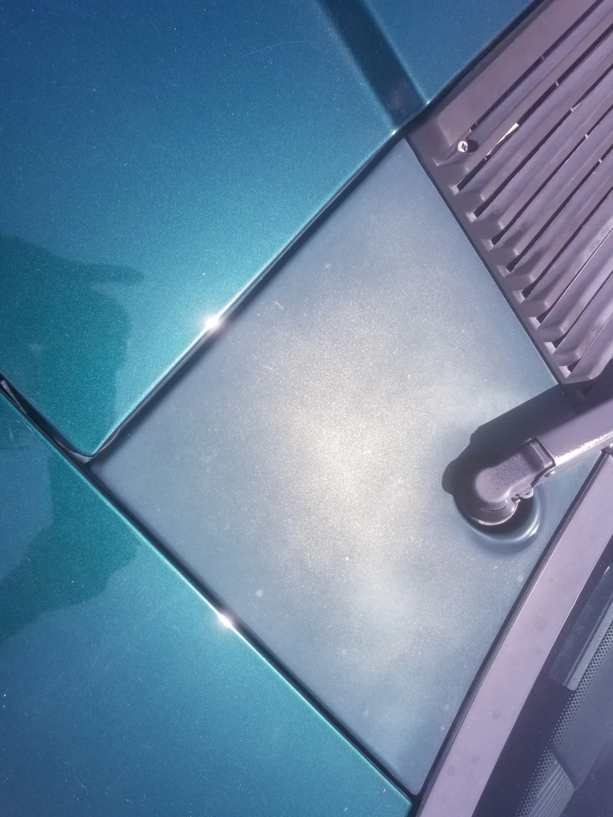

Rattle can? No, it’ll look like poo.@Davedacarpainter, I've got a couple of questions. I have no paint equipment or experience at all except for repainting an old rusty freezer 20 years ago. I really need to put some ppaint on the cowl of my 90. It's a 7 up car and the hood and front bumper were resprayed some time before I got it. The rest of the car needs compunding, polish, and wax mostly. So what's the best, non-professional way to do this? I can remove the trim and tape everything off, but will a rattle can be good enough?
I do not yet have a buffer.Rattle can? No, it’ll look like poo.
Post a picture of your cowl for me.

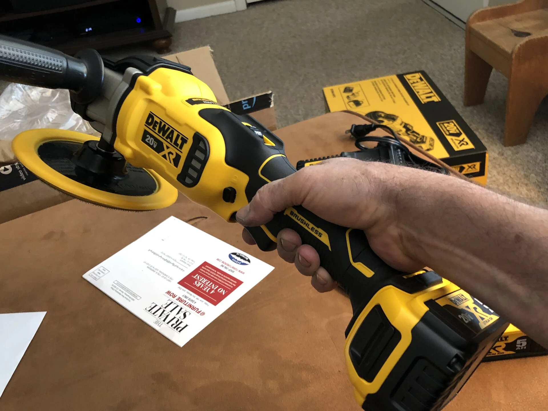

I’ll be ordering a Dewalt cordless buffer. Time to cut the chord.
When I get it, I’ll give y’all a review.

Here's the cowl.

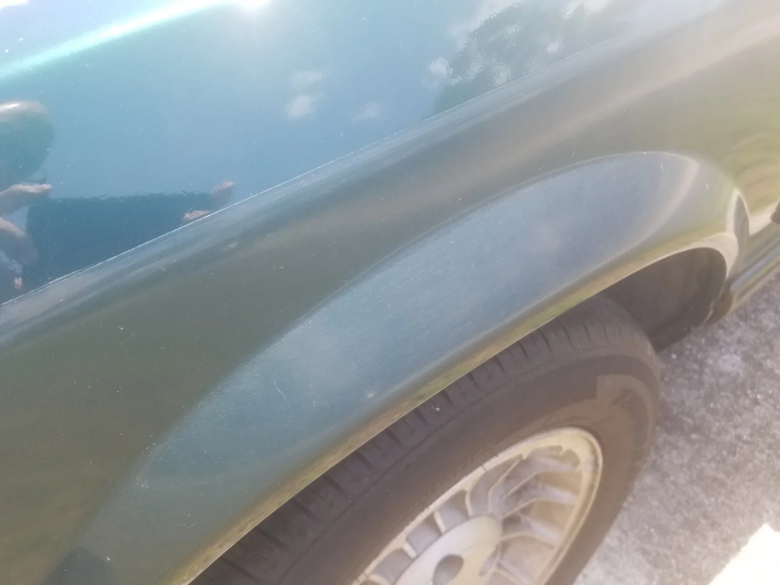

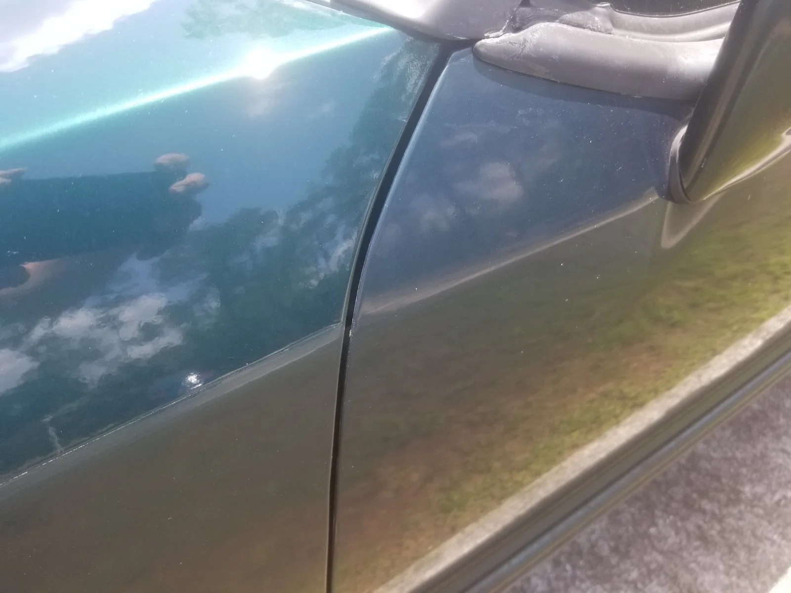

Here are a couple of the driver's side. You can see where the pin stripe used to be.

Oh, green comes up from the cowl. I know it will need to be painted, I just don't know a budget way how.Ok, two separate issues to address.
First, your cowl panel. Sometimes it’s tough to make a call from pictures.
I’m not sure if the clear coat has just hazed over the years, or if it’s delaminated and is gone. Take a small amount of rubbing compound and use a very soft rag to polish a small area of the cowl. If the rag comes back with green on it fairly quickly, it’s either a single stage paint job or the clear has come away from the base. Do the small compound test and tell me what happens.
As for the lines from where the stripe was? You’re a little screwed here. A painter masked off at the stripes before and painted the upper area. That’s not tough to fix for me......that said, you would have to repaint the fenders, doors and quarters (if it’s all been painted that way).
A ”budget way” to paint the cowl, hummmmm.........How close are you to Oklahoma?Oh, green comes up from the cowl. I know it will need to be painted, I just don't know a budget way how.
Now that you mention the paint, I can see it clear as day, but it's just the front quarters. The hood was reshot at some point, that I know. I found overspray under the headlight lens when I was negotiating the price.
