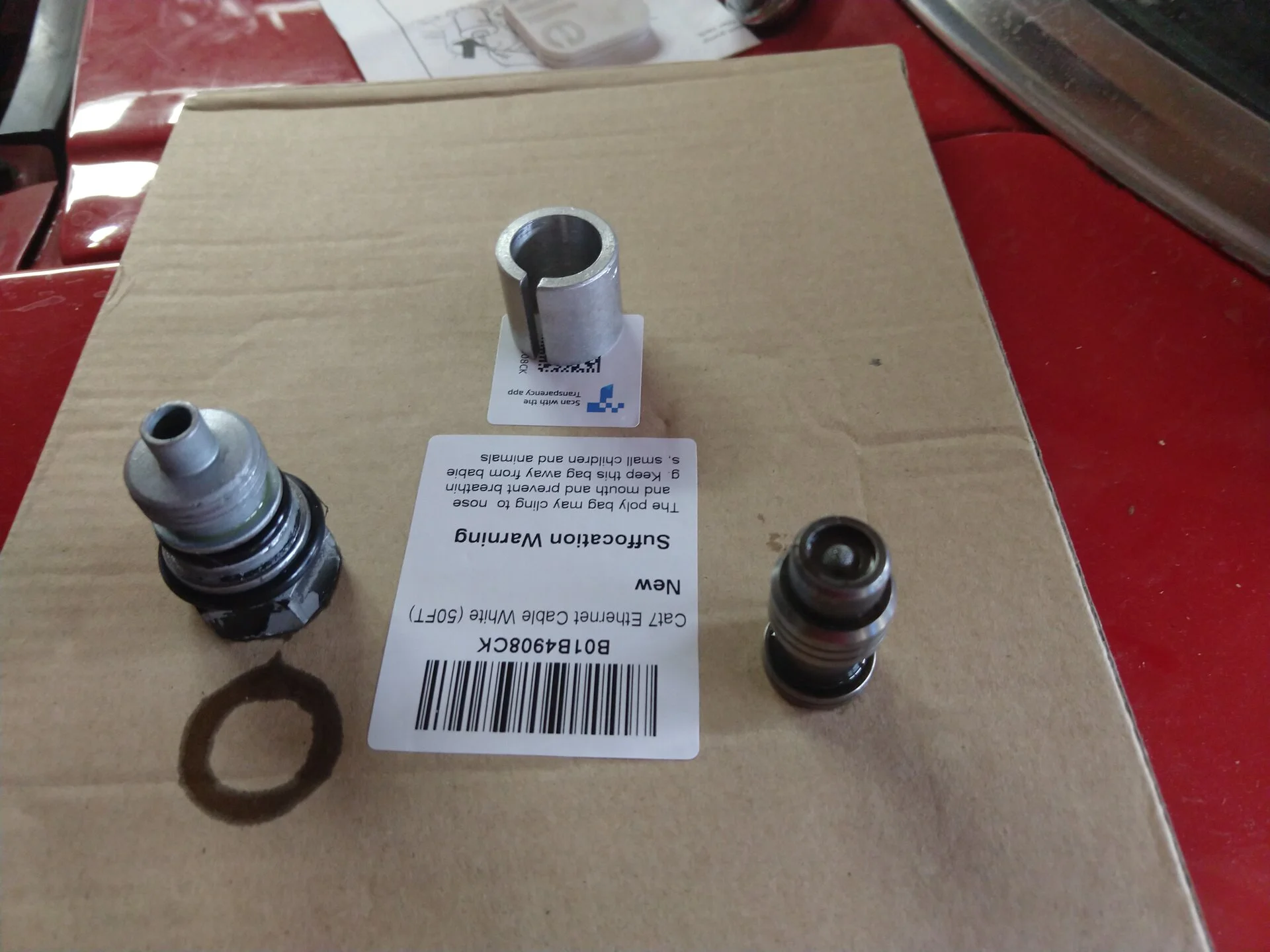

We pulled the flow regulator out of the pump... didn't want to come initially, but running the motor for about 10 minutes loosened it up.
However, it isn't immediately clear where to stick the shims.
The instructions (image attached) state that there is a 7/16" nut in the assembly, which needs to be removed. Instructions linked here: https://static.summitracing.com/global/images/instructions/mch-p306.pdf
There was also a graphic included with the regulator which I can't find for the life of me, I'll post when I find.
The problem - I cannot find a 7/16" nut anywhere, and thus don't know where to put the shims. Image of parts here:
In any case, the guts of my power steering flow control valve/high pressure output all seem to be exactly as expected (matching generic diagrams like this: https://slideplayer.com/slide/6119738/18/images/64/POWER+STEERING+DIAGNOSIS+AND+TROUBLESHOOTING.jpg). Where do I find this 7/16" nut? The flow control valve and output fitting don't appear to come apart any further. We definitely tried.

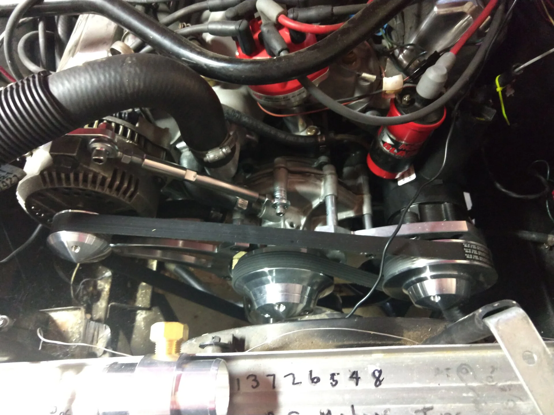

All - I have the pullies installed. Looks great (waaaaay better than the fugly serpentine setup I pulled from that junkyard). Images attached.
