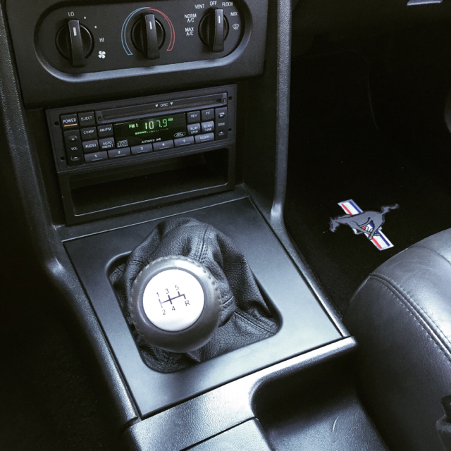

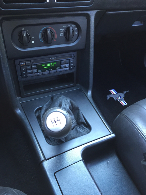

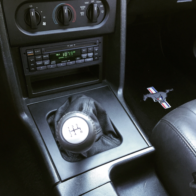

The factory radios suck. I never listen to mine, as the car is not a DD. If it was a DD I'd need to invest in a good stereo.
For me, paper speakers are fine. I actually spent $$ finding a set along with putting in a 1993 CD player and amp. Sounds a tad better than the original 1988 radio/amp. A $25 Bluetooth adapter from Amazon lets me play my phone through it.
In terms of quality of sound....eh. Don't expect much. I just listen to the exhaust really.

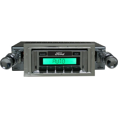

You can always explore this avenue:
http://www.classiccarstereos.com/ford-radios.html
Replica of a 72-79 Torino head unit. There are others (of course) but something like this with Bluetooth or an AUX jack in it, is probably all you would ever need.
I like this one:
and this one:
1971-1989 Ford Galaxie USA-630 Features:
  • AM-FM Stereo
  • 300 Watts (4 x 75 Peak, 4 x 45 RMS)
  • Electronic Tuning & Volume Control
  • USB Port
  • Ability to add Bluetooth with optional BluKit accessory
  • Direct iPod Connection & Control (Classic Wide Connector)
  • Direct CD Changer Control
  • 2 Channel RCA Aux Input for iPod or Satellite Radio Tuner
  • Alpha Numeric id3 Display for MP3/WMA (USB)
  • 4 way fader
  • L/R Balance
  • Digital Clock
  • 12 FM and 4 AM Presets
  • 4 Channel RCA Pre-outs for an external amplifier
  • Bass & Treble Controls
  • Power Antenna Lead
