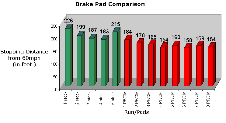

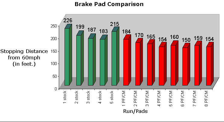

OOPS! I said 70-0 not SIXTY
You want to know what your car will do the 60-0
Oh and take that 70-0 that I refer to and use a car with the m2300K brake package with the stock pads, you get 109 feet. Add some good aftermarket race pads and you will be under 100 feet from 70-0.
I am happy your pedal feels good. it should since you dont have a lot of cash to sit on after paying your ASE mechanic for his overpriced services. But there is no way you will convince or prove with real data that a stock fox3 mustang will outbrake a 99+ GT or any brake upgrades to the car.
