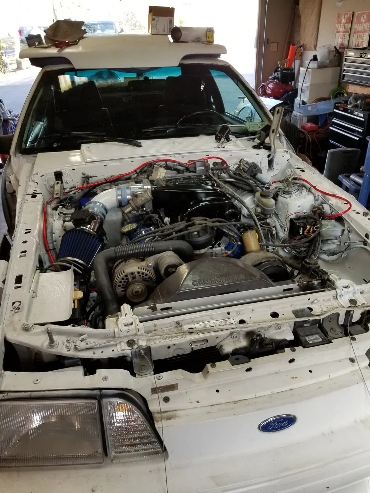

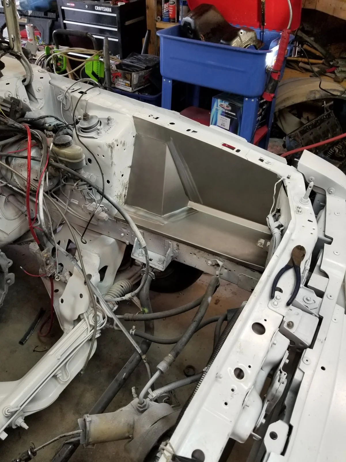

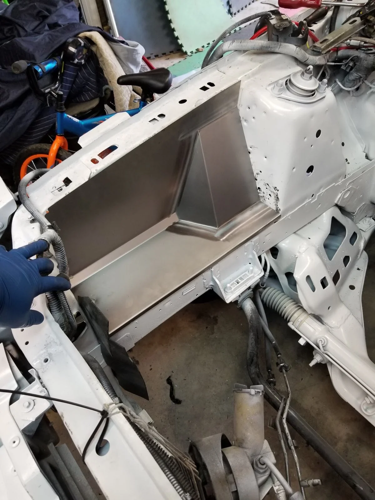

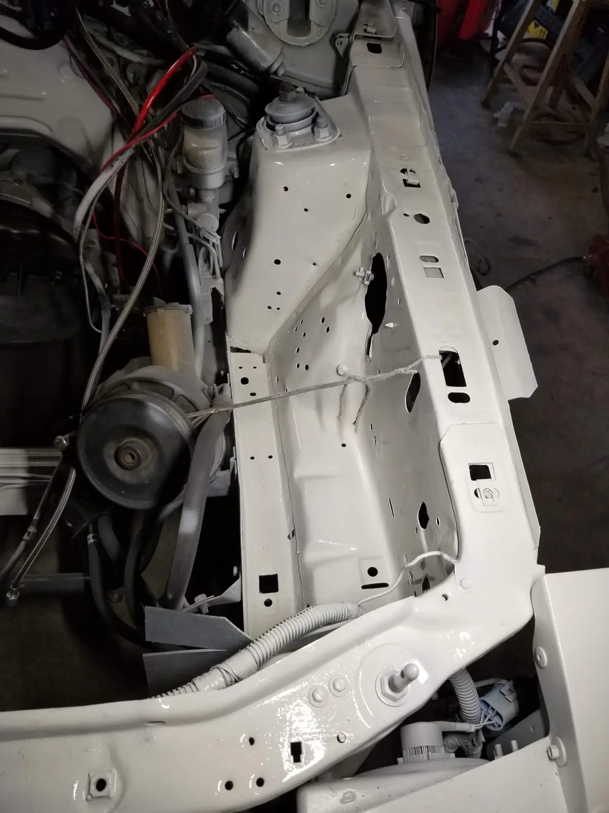

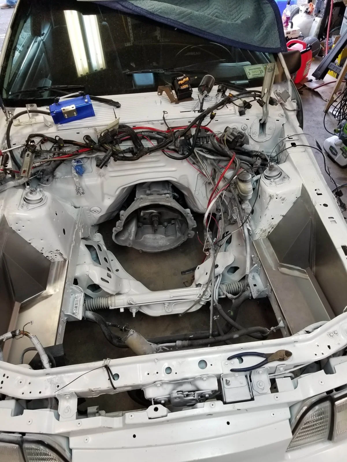

Looks good, but why didn't you mask the steering rack, back of the headlamps, wiring off, etc?
Well most of that stuff isnt going to be there when the motor goes back in, gonna get 1 piece headlights, new steering shaft, I honestly painted the steering rack because I just didnt feel like masking off something people wont really see when the engine is in and it's not a show car. I know its lazy of me lol

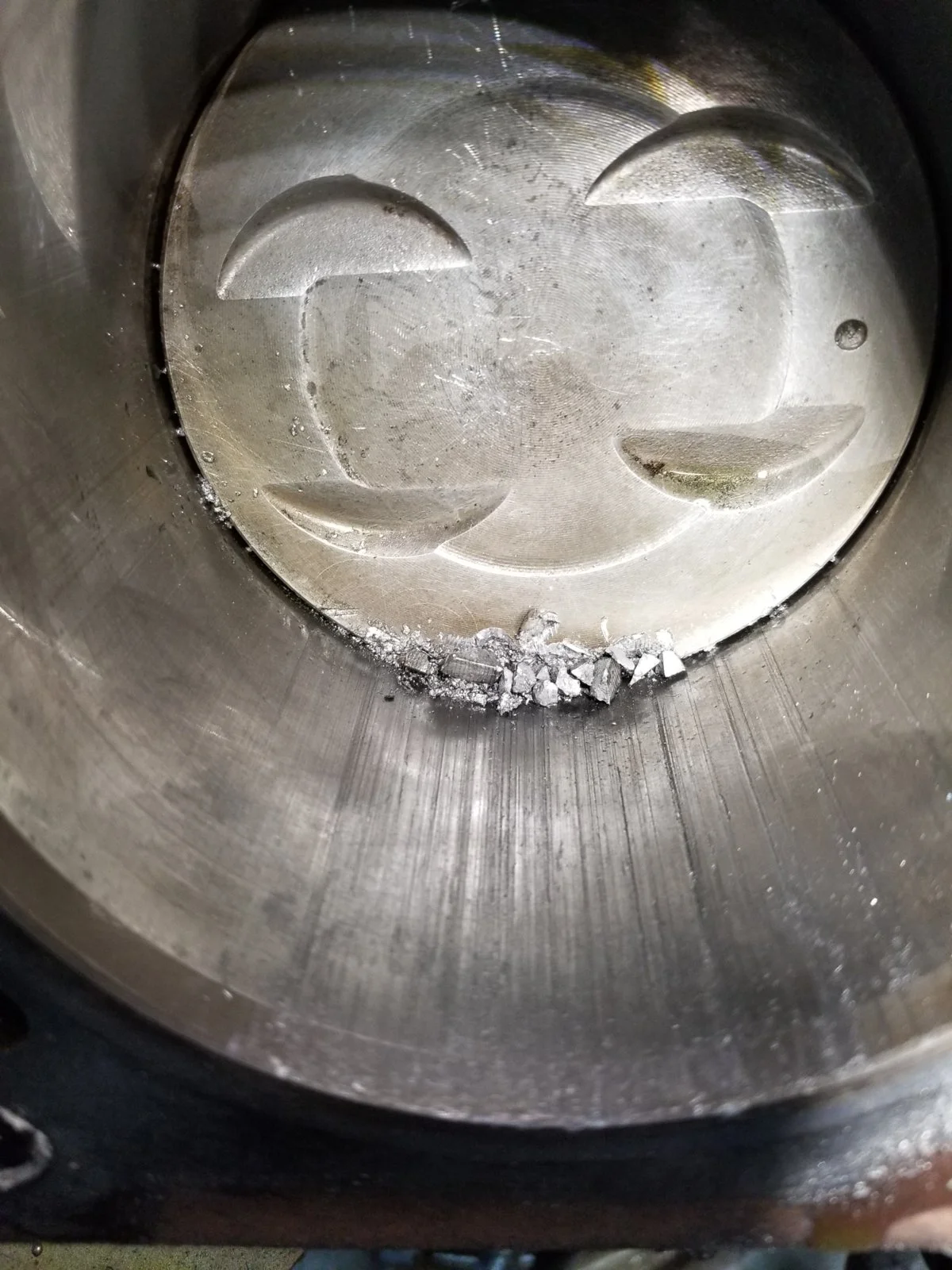

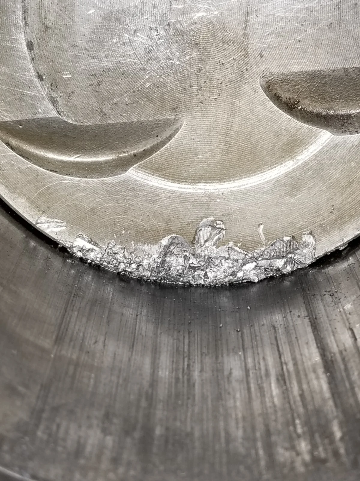

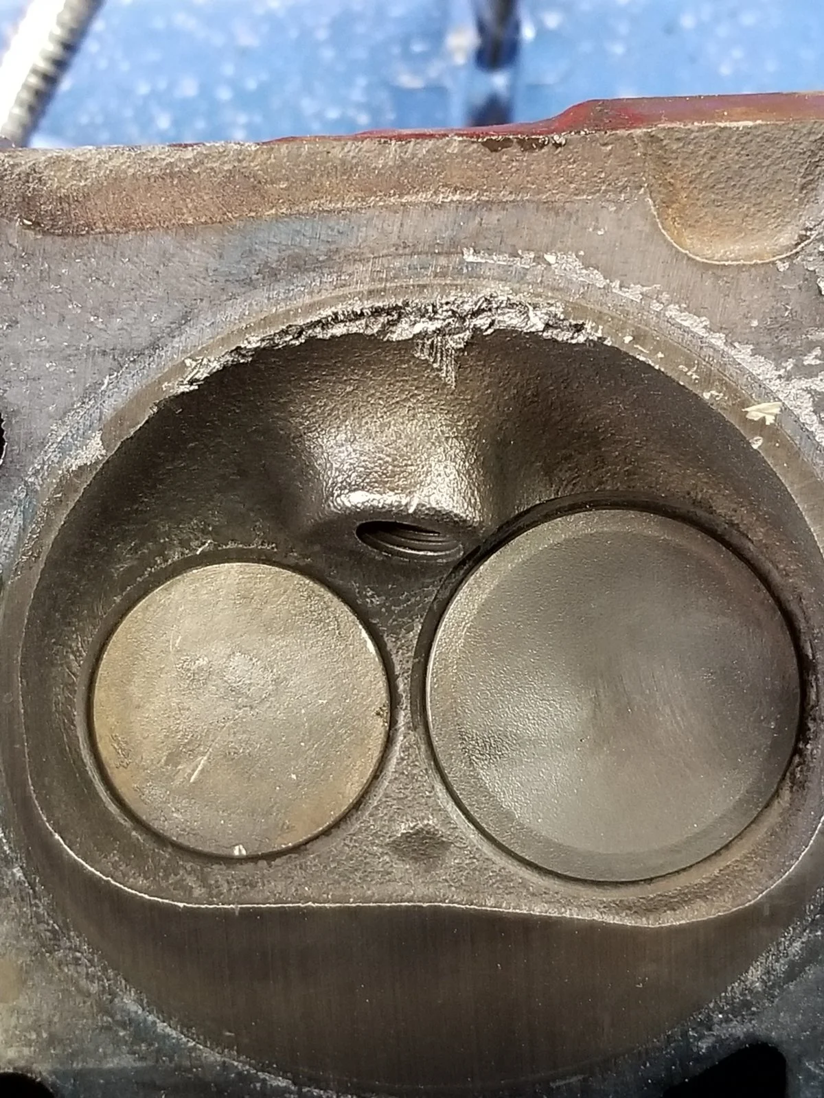

The only reason the engine is out is because after I got done putting on all the new parts ie. Gt40p heads, b303 cam, new lifters, double roller timing chain and sprockets, trickflow r upper and lower, long tube headers, ac delete, smog delete, water pump, power steering relocation bracket, wide band o2, 30# fuel injectors, 80mm maf, 75mm throttle body, egr spacer plate / egr delete, cruise control delete, after alllll that, I broke a piece of metal off in number 1 cylinder somehow, and destroyed the piston and cylinder wall. The engine is currently at a machine shop getting resleeved so I can put it back together again.
Here's the damage , I was alllll done
If you don't mind being considered lazy...or sloppy....run with it.
I guess because it's not a show car, you'll never open the hood at a Saturday night cruise in either?
The rack might not be that visible, but everybody's gonna see the master cylinder that is half white, the caster/camber plates that aren't completely painted, the power steering hose that isn't black anymore, the cloudy white overspray on all of the accessories, and brackets, partially white hood pins and all of the wiring harness that has overspray all over it.
And the texture that's on the upper radiator saddle...is that the dirt that got painted over?
It boggles the mind to think that somebody would spend money on aprons, and spend money on paint ( for whatever reason) just to ruin the final outcome because it took too much time to do it right. It's one thing when somebody posts a pic of something that came out "less than" because it was the best they could do,....it's entirely another when somebody posts a pic of the same "less than" because they just couldn't be bothered.

Thought it would be worth mentioning, power steering pump will be replaced along with the lines that are leaking, brake master cylinder will also be replaced with the rear disc brake upgrade, caster camber plates will be replaced when i put in my springs , shock and struts, steering shaft will be replaced as well as headlights. Its ALLLLLLL stuff that's coming out anyways which is why I didnt take the time to tape it off. Its not because I cant be bothered , it's just I dont care much for getting overspray on parts I'm going to throw away to begin with.
Reactions: General karthief
Thought it would be worth mentioning, power steering pump will be replaced, brake master cylinder will also be replaced with the rear disc brake upgrade, steering shaft will be replaced as well as headlights. Its ALLLLLLL stuff that's coming out anyways which is why I didnt take the time to tape it off.
Hey it's your car..you do you. Seems to me it'd have been way easier to just mask everything off rather than replace it.
And despite the statement where it's allllll gonna be replaced, I'd imagine that you aren't going to be replacing the painted wires and socket assemblies, or the upper saddle with the new mystery texture now buried underneath. A lot of us have went through a engine bay cleanup and detail, a few more have went on to do a full engine bay smooth. So everybody that has undertaken that project knows what is involved in the process.
The shiniest of engines isn't gonna hide the lack of detail everywhere else. Just sayin.
