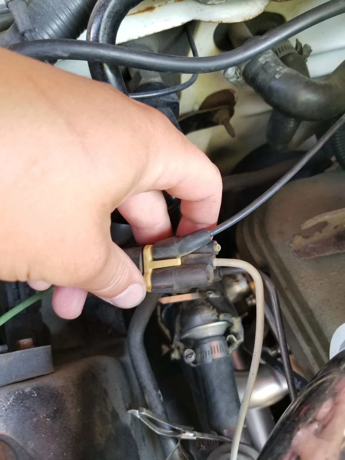

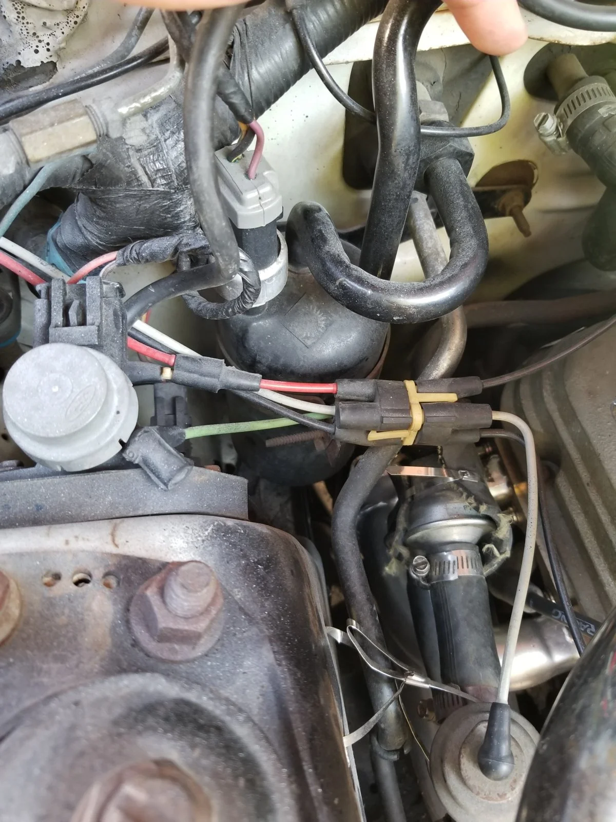

Hey guys any help with these vacuum lines would be awesome, I have no idea where this green one goes and it looks like theres a white one that's just broken and I cant find the other side.

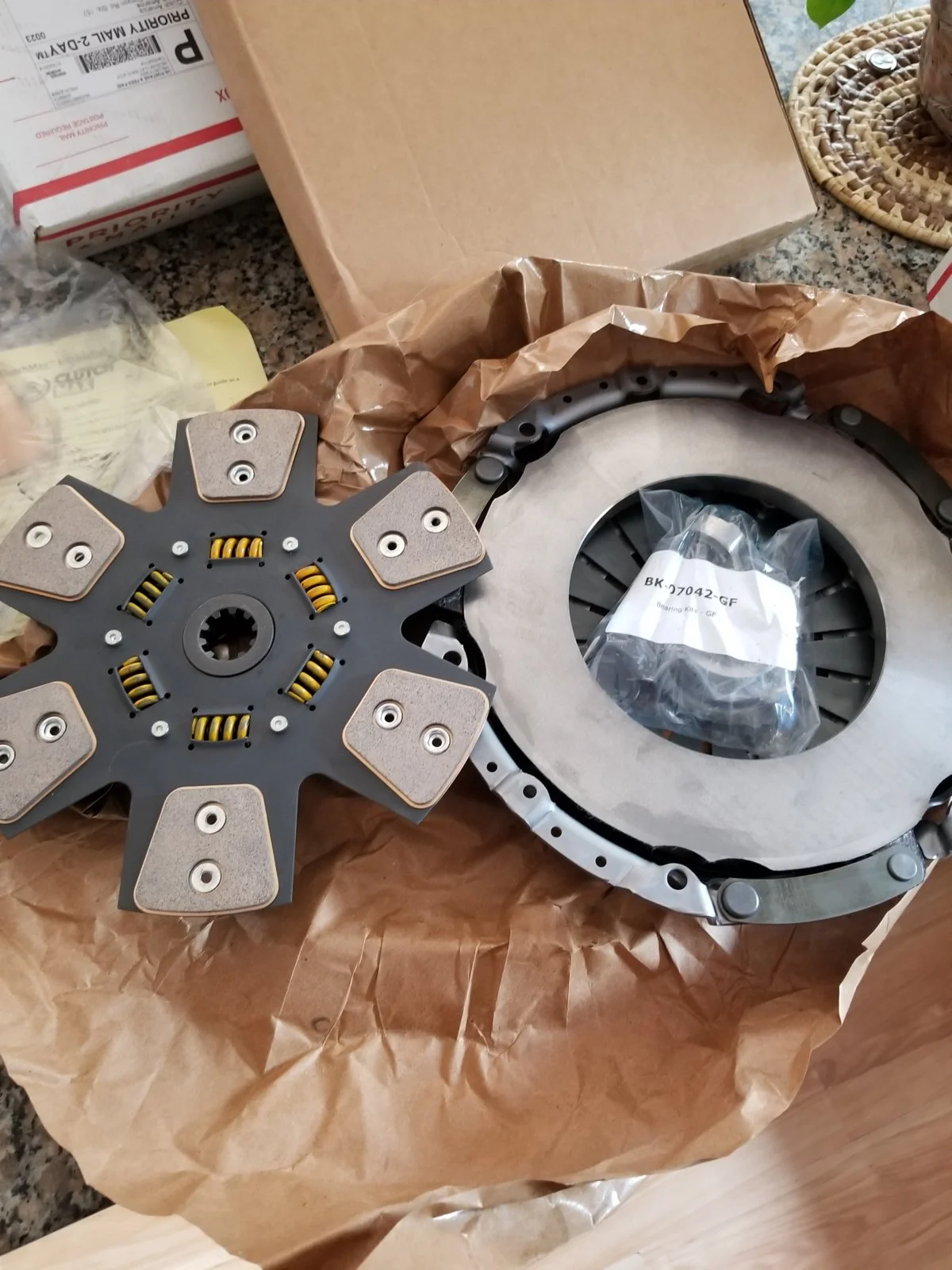

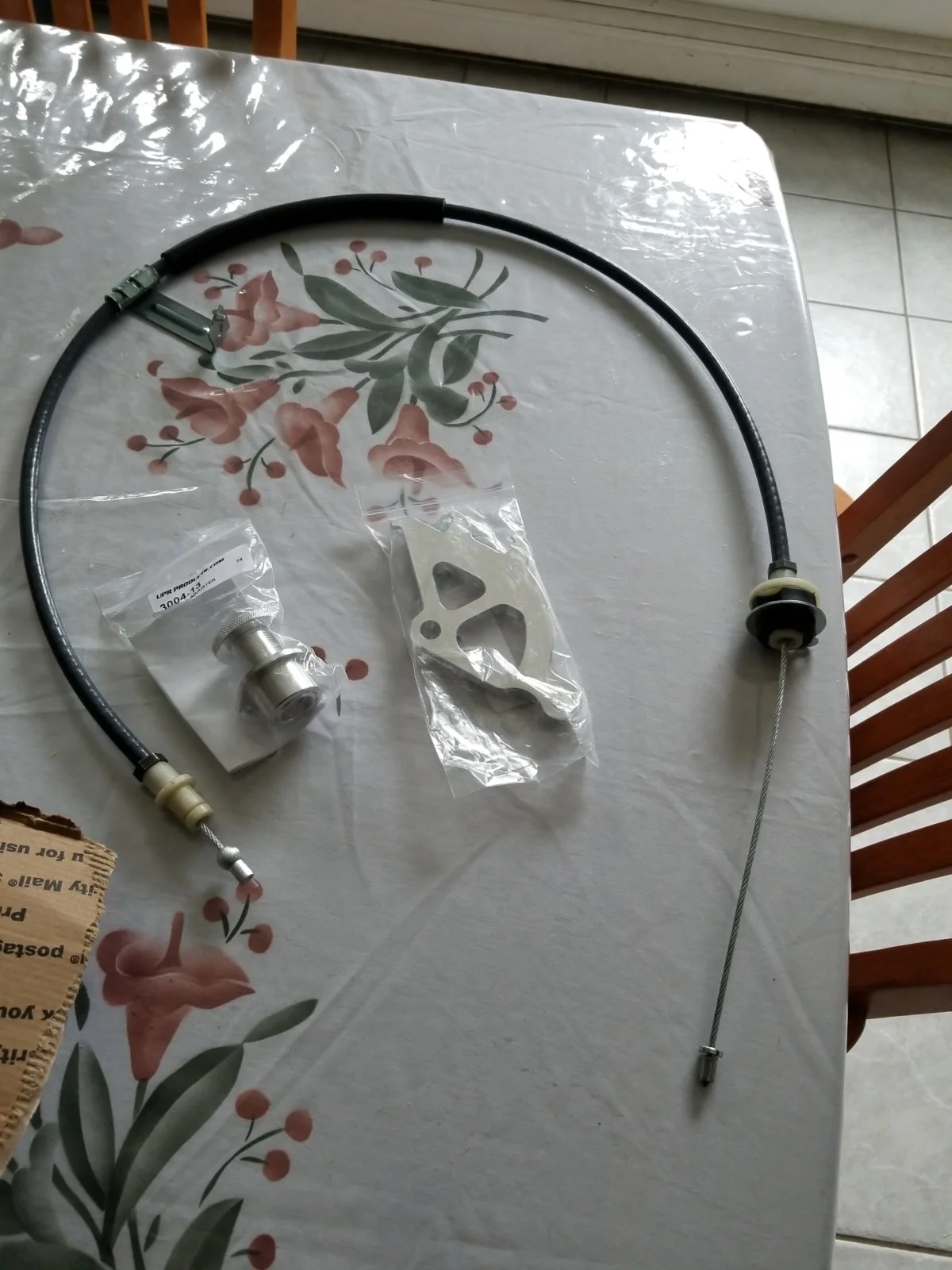

Goin back in, new clutch , clutch cable and firewall adjustment with quadrant. Also picked up 4.10 gears, that's a bit outside of my skill set, gonna have someone do that for me
