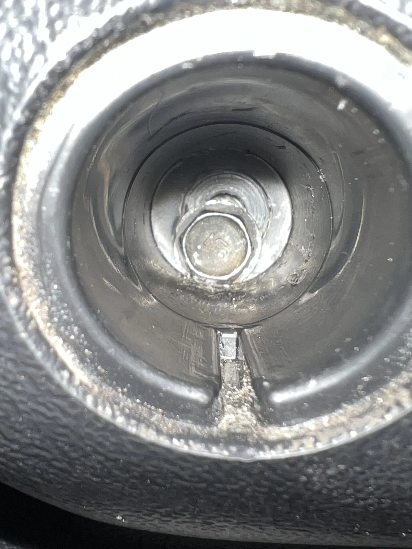

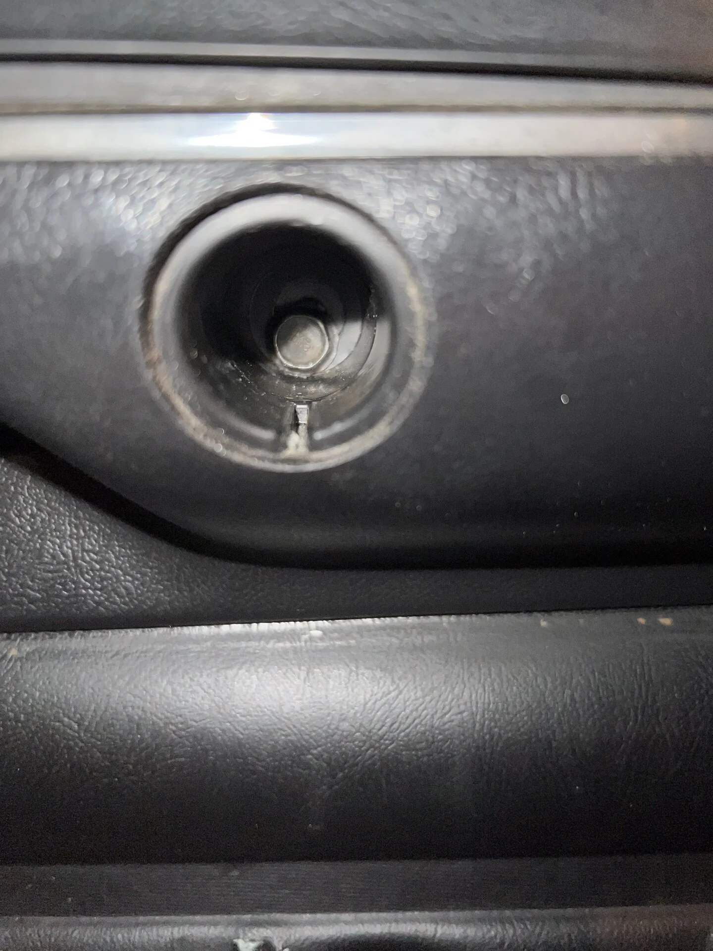

I think I’m over thinking this, but how would one get this bolt out?
Previous owner put it back in like this and cannot get a socket it on it.
Tried different brands, non are thin enough

Maybe cut a socket? I do not think drilling it out would be a pain.
Needle nose to thick smh
