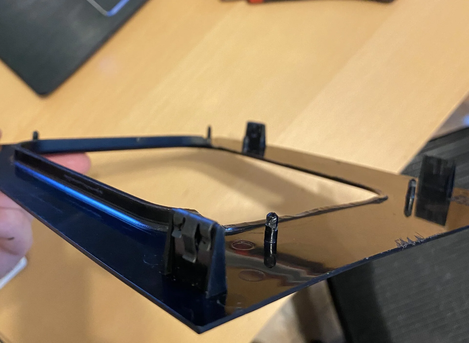

I modified the shifter bezel to fit better, but still thing the trans sits too high. The LMR boot feels too short, when I shift into odd gears the back of the boot pulls the bezel up. It’s a brand new t5z, used tri-ax with new ford crossmember and trans mount (big hump on passenger side).

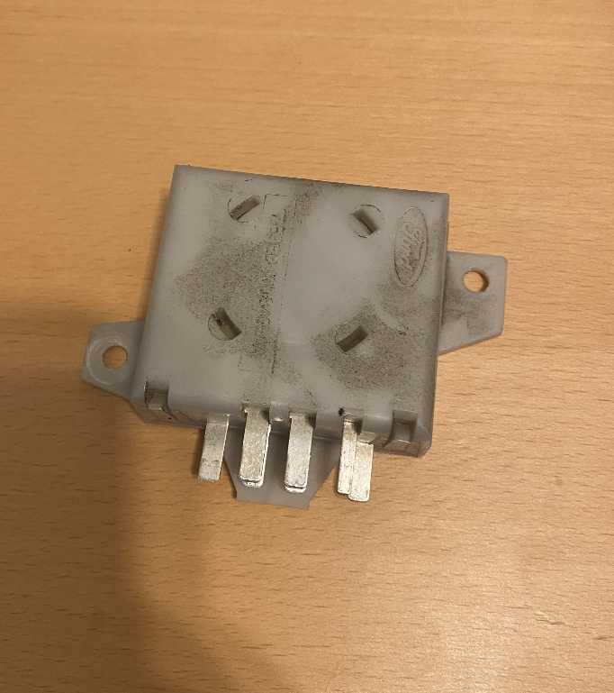

1. Fixed the door chime. Mine was in excellent condition, just a little dirty and the foam ring was shot. Cleaned it up, and used this stuff cut to shape. Great sound now.

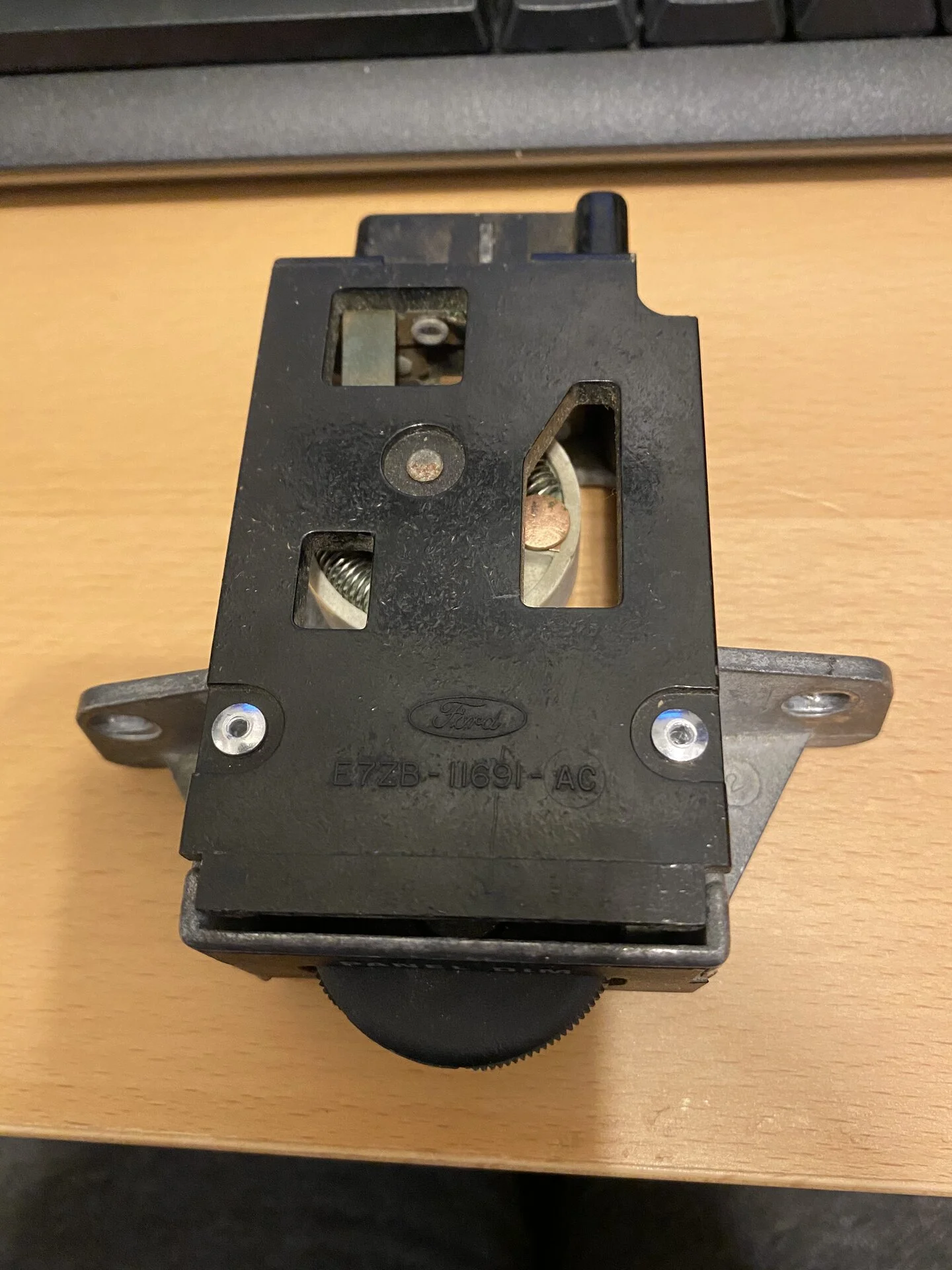

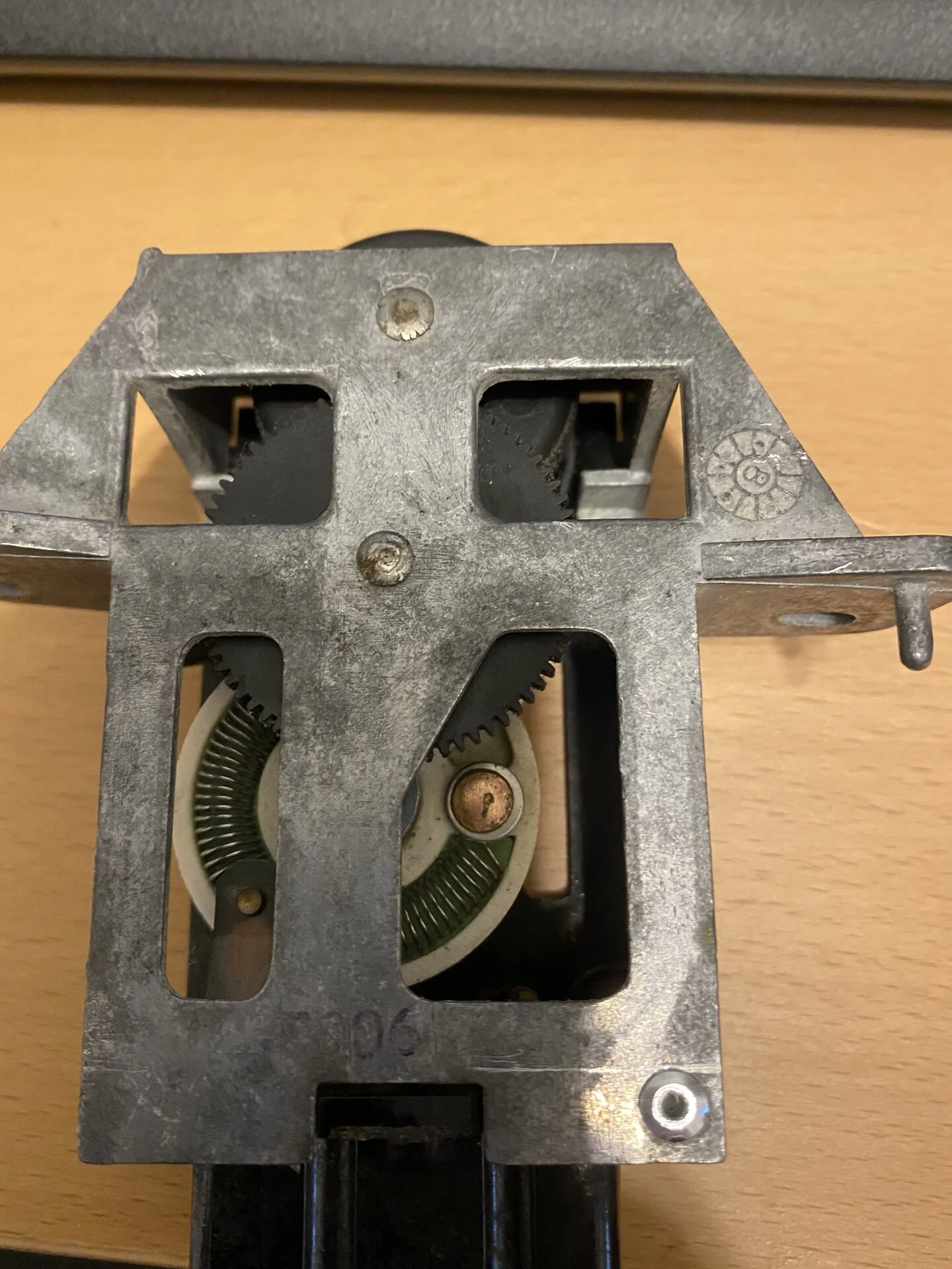

2. Cleaned up the dimmer switch. This was sort of fun - drilled out three rivers, and the metal/black plastic halves come apart. I gently pulled the white wheel out from the two prongs resting on the spring. Cleaned everything, removed some corrosion build up on the contacts, added a tiny bit of lithium to the gear mesh, put it back together using some ⅛” rivets. This will go in when I fix the dash lights.

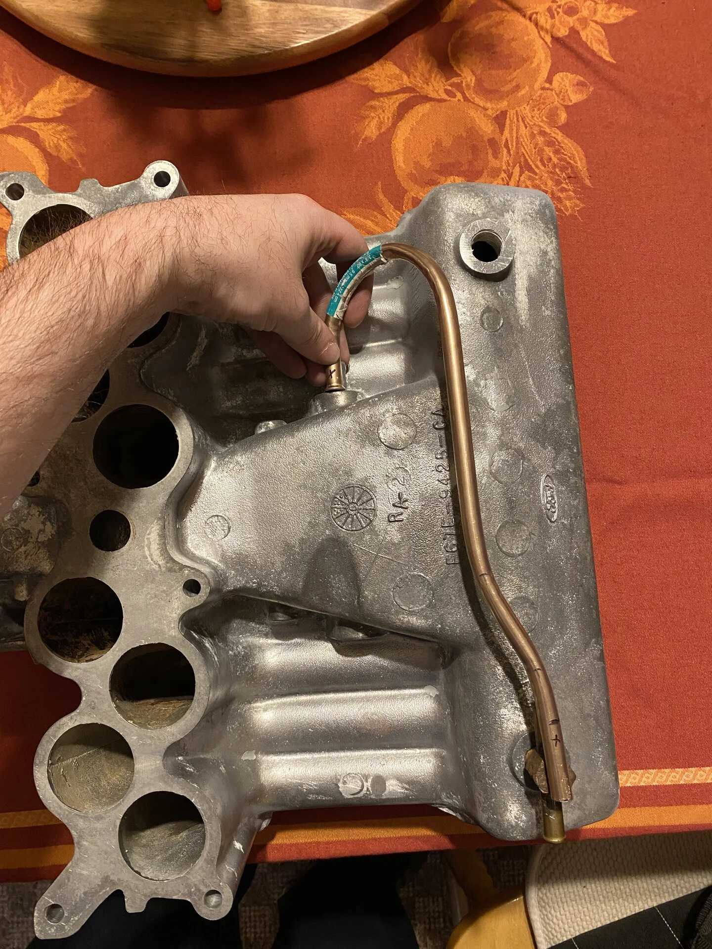

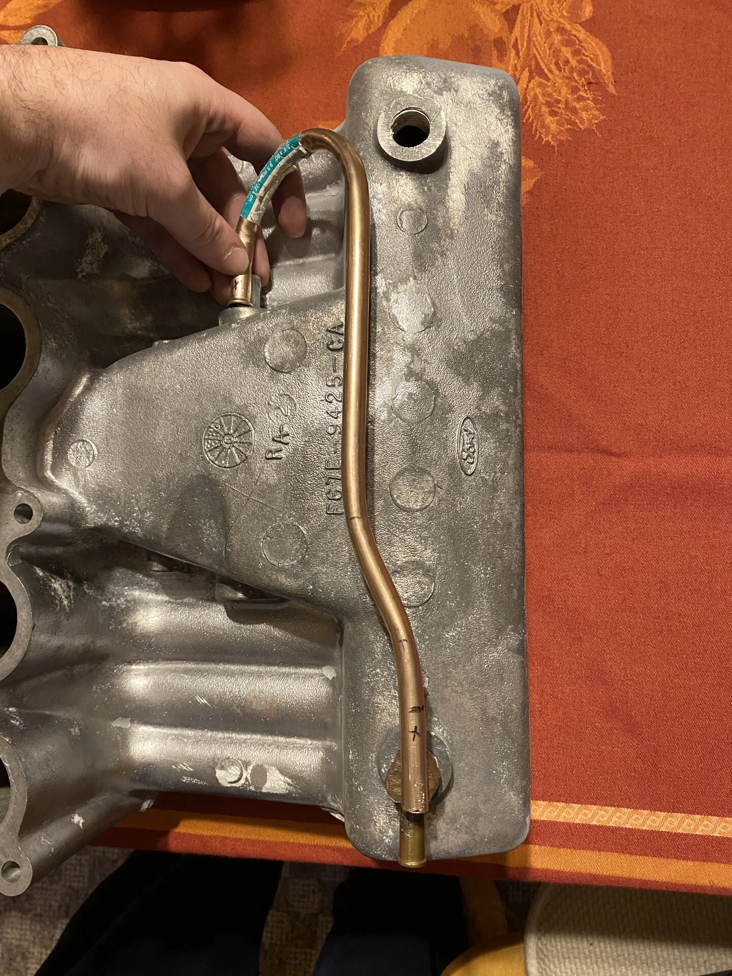

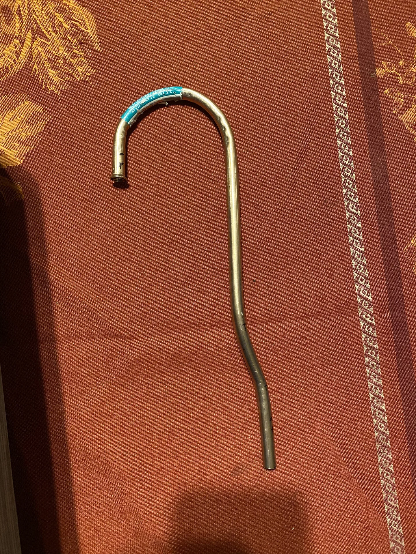

Grabbed some 3/8” brake line and a tubing bender on clearance to make a PCV tube for my explorer intake. Length is rough cut (and flare although not sure it’s necessary) so still need to fine tune, but happy with the results:
I’ll use this in lieu of the stock rubber tubing (which I preferred since it’s molded to shape, but those seem to be long gone).

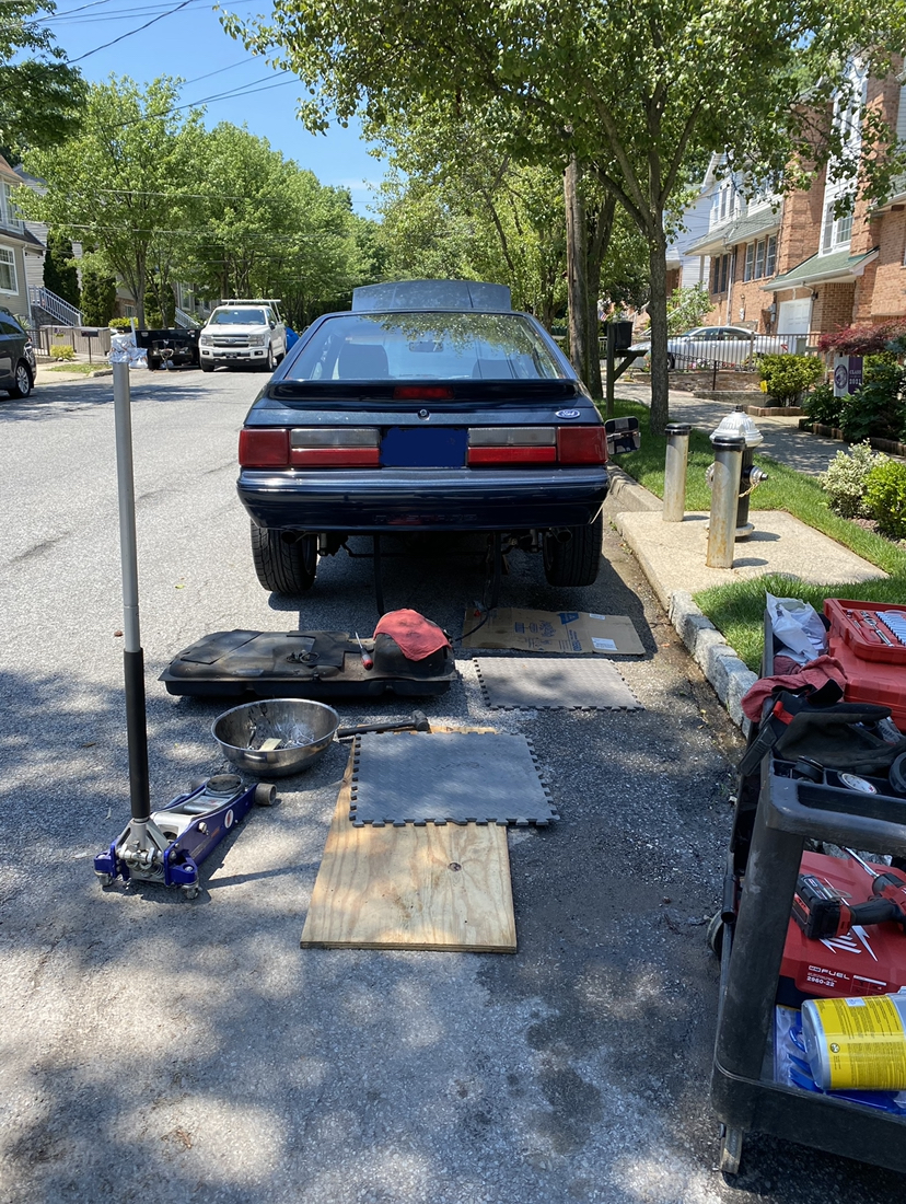

Finally fixed the hard start problem. Prior owner put in a cheap Bosch fuel pump that had a tiiiiny little pickup opening (underneath, with sock off, was about 80% blocked off by design and only a small mesh opening to pickup fuel). It also wouldn’t hold pressure when turned off, so had to prime 2-3x to just start the car and often still hard started. Walbro 190 swapped out and starts up great. Waited 24hrs, barely heard the starter engage before the car started.
Yes yes, working in street in front of a hydrant... we chased the shade on a hot day. Once my move is done I’ll have a garage to work out of.
