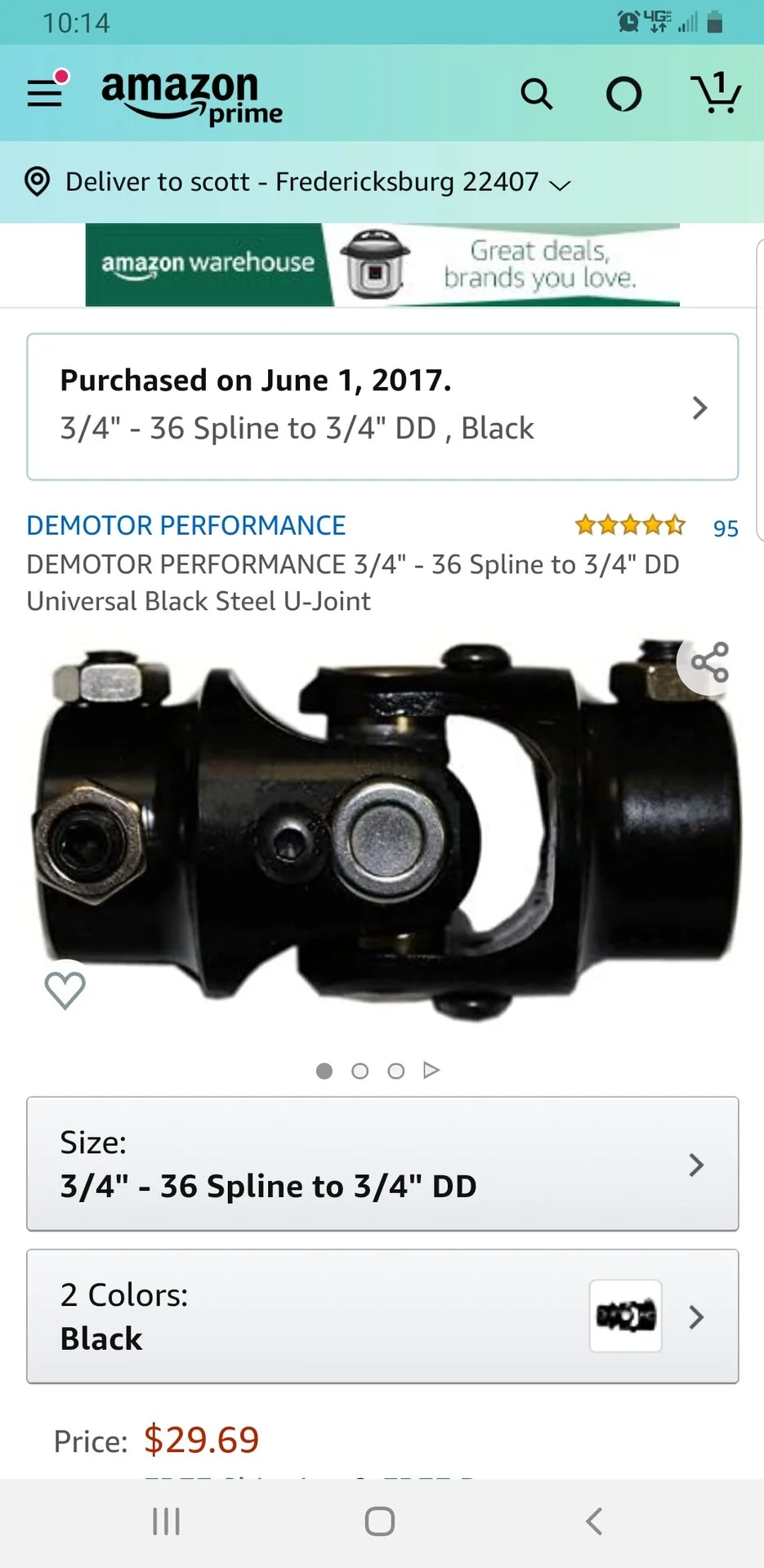

I used a universal u joint from Amazon. It was a 36 spline DD ( or double D ) 3/4 inch. I removed the rag joint bracket with a hammer. Do like PeeWee Herman and just beat it off. I had the shaft machined to DD because the factory one is round. You could get almost the same result with a grinder and patience. Removing a little at a time until snug fit. The hold down bolt hole was marked on the machined end and a hole was drilled to accept the pinch bolt. Very easy amd very cheap. A bunch of guys here do that and get them welded on. The other 36 spline end will slide right on the rack.

I knew I was bolting mine on so did the DD type so it would be serviceable. Actually thought my turbo header overheated the first joint and order another to replace it. Found nothing wrong with the previous one. Replaced it anyway. I'd never use the 3/4 smooth one unless I was getting it welded. Even then I'd prefer the the DD one.

Nice. What is DD? Noticeably different feel? Getting motivated from this thread. Might have to do it this weekend. What is it, like 4 bolts shaft comes off easy?

One nut/bolt at the top by the firewall, set screw at the rack.
You'll need to loosen the to large bolts holding the rack and slide it forward a bit
for removal and install.
DD refers to the shape of the universal joint opposite the spline side.
