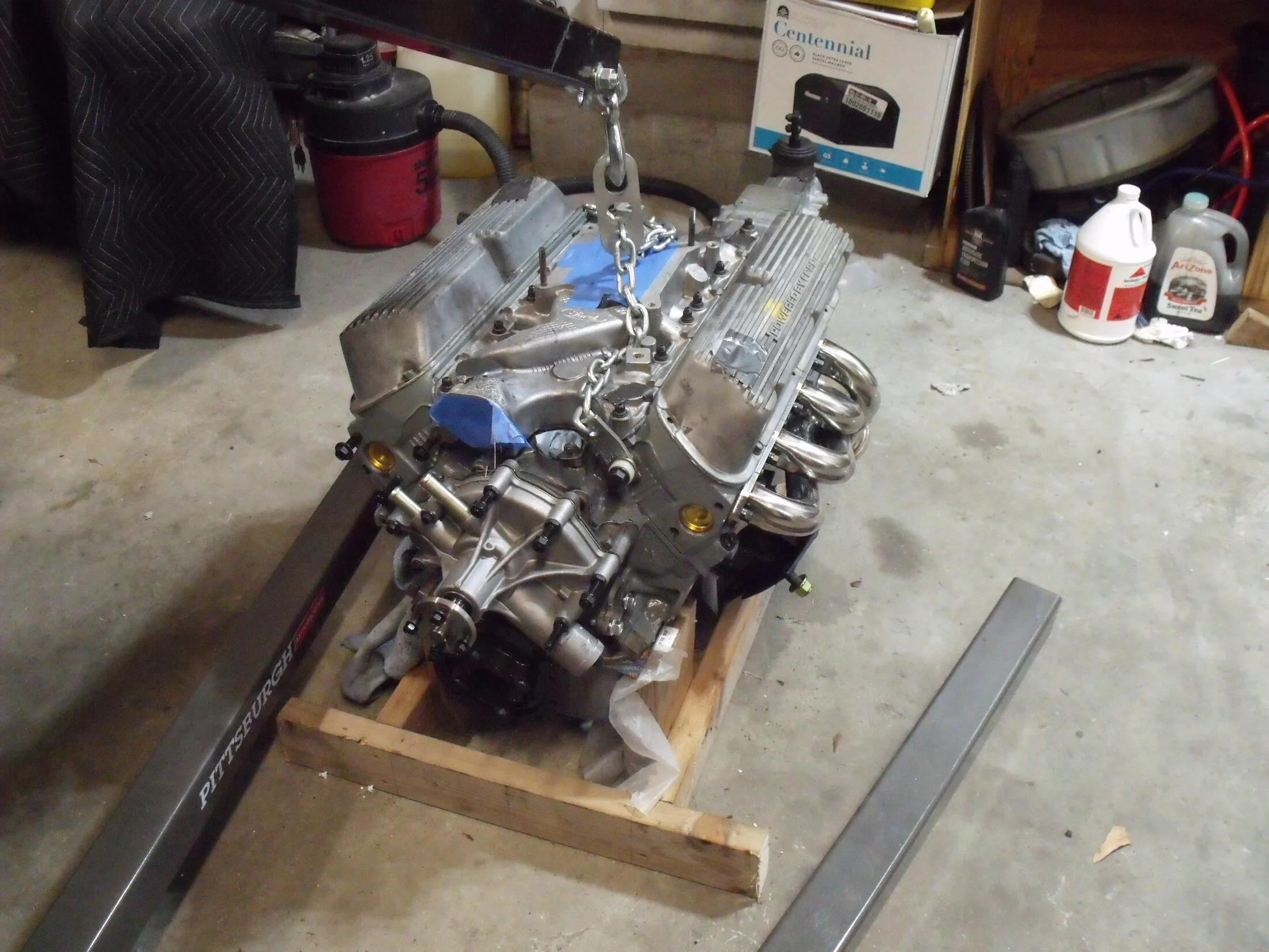

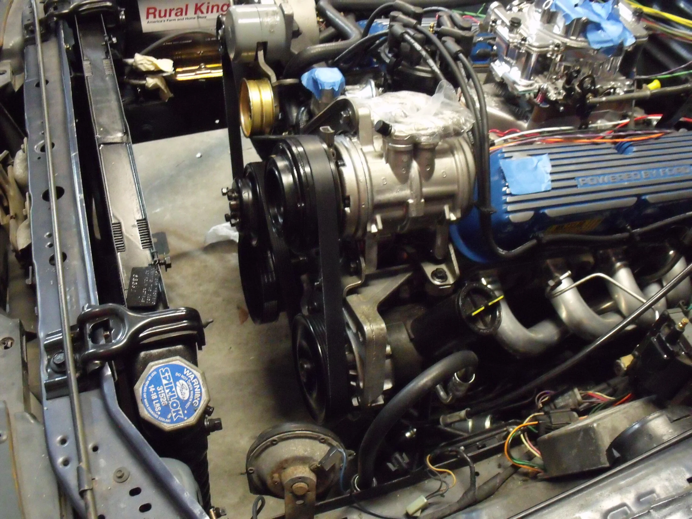

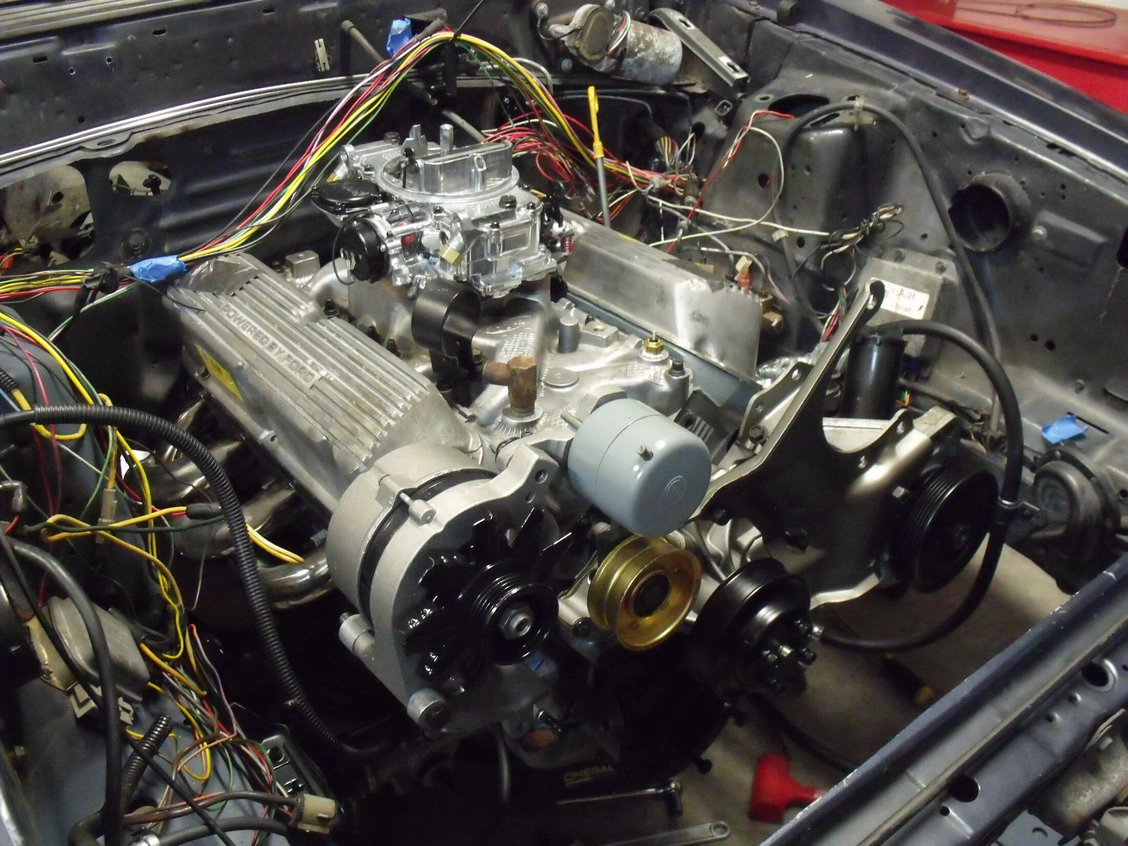

I don't think this is what your looking for but these are all of the stock brackets from my 83 on a 98 Explorer engine...
Everything was bolt up.... New water pump from Rock Auto...
