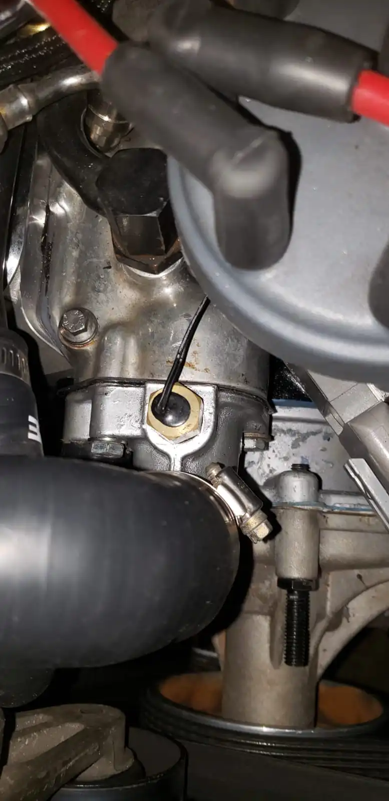

I'm running the sve dual 12 electric fans with there 3 row rad and controller. The fan control temp sensor is in the water neck with a bung and that's is were the Holley reads it temps at. At one point the was one notch away from Max on the dash. When the Holly is reading 200 at the water neck. Dash gauage is reading 1 notch away from balf. The car has a 180 thermostat. The issue I'm having is while driving the fans don't seem to be really cooling and temps just creep more and more.
What is the temperature set point to trigger the fans?
Do you mean in the t-stat housing? If so, before or after t-stat?
Can you manually trigger the fans to know they have not blown a fuse or something?
Do the fans have a shroud?
To be honest, when driving, there should be enough air flow to not need the fans (if you have the lower and side rad deflectors)
Pics always help.
Yes the T stat housing. Fans are triggered to come on at 184 F and shut down 179f. I have a manual switch as well and it confirms they are on. The fans have I shroud. But to test I removed the fans from the shroud and mounted them to the rad with a Hayden kit to free up some real estate. The shroud thaf came with the sve kit covered the whole back side of the rad

With a modified engine, do you have a wideband hooked up. You may be running lean at idle which would cause the rapid warm up. Not an issue, but something to think about with the tune (does the lean condition remain at greater RPMs).
Based on getting temp reading from t-stat housing downstream of t-stat should give accurate reading to your ECU of what coolant temp leaving the engine is. With set points as low as you have them (fans on at 184, off at 179) looks like you want a cold engine. Remember the stock ECU wants engine around 190-195.
So if your fans are actually coming on at 185 (at the engine) and you are still getting hot, then you are either not drawing much air through the rad (by the fans) or coolant is not flowing enough through the rad to be cooled sufficiently. If you open the rad cap and watch as you start up the car, can you see coolant flowing out of the tubes into the rad tank? If not flowing well, you may need a rad flush.
Another thing to look at is, when idling, is the lower rad hose collapsing? This would restrict the overall flow in the system as well. With a stock water pump I wouldn't expect this to be the case, but it can still happen. I know some have a metal coil in the lower rad hose to prevent this collapse. My car does not have one.
I have a wide band. The car at start and ideal jumps 14-15 afr and about 12-13 when driving. At start up the coolant doesnt rmove at all. After about 5 mins the level will drop and you can see the coolant flow then. I have the lower air spoiler. The car doesn't take coolant from. The over flow of that matters.
I used those lisle funnels to bleed the cooling system. Other thought I'm having is a bad rad cap?
The rad on the passenger side is warmer then the driver side when I check with a laser gun
Doesn't look like it's afr realated.
Those funnels usually work pretty well, I've used them to bleed reverse cooled systems with pretty good success.
Having a good radiator cap is a cheap investment , if the current one is suspect I would replace.
When engine work was done was the water pump replaced and if so was it replaced with the correct reverse rotation pump ?
That would make sense as hot coolant enters on the passenger side of rad, should get cooled as it passed through the rad, so driver side would be cooler.
That would happen when the t-stat opens, thus starting flow through the system. Once the flow starts and fluid level in rad tank drops, I usually add more coolant, essentially topping up as air continues to burp out through the rad tubes. When coolant stops going down in the tank, you should be good to go. Overflow tank will catch the rest.
Out of curiousity, what were the temps you were seeing with the laser gun (thermo gun).
I have a stupid question. If I'm putting a napkin to the front of the rad should it sick it towards it or blow it forward? When I'm placing a napkin in front of the rad when the fans are on. The napkin is pushing it away and not ducking it into the rad
