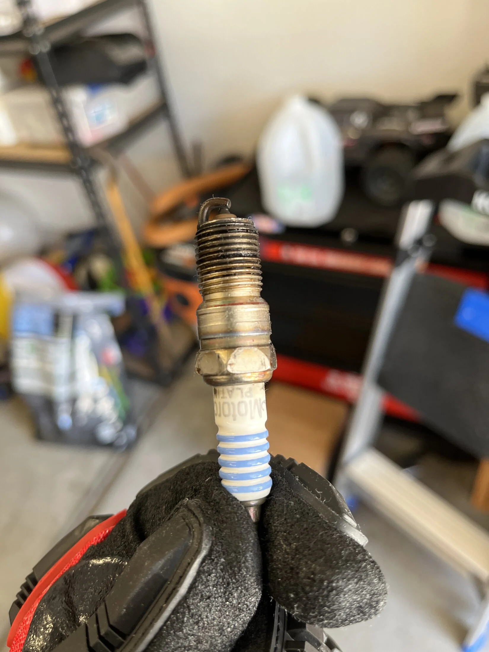

Here it is. Didn’t notice any cracks in the ceramic
WTF on that gap, rather lack of?
that plug looks a little wet?
red5.0fox
Dec 1, 2019
190
25
38
Hope Mills, North Carolina
May 2, 2024
#196
  • May 2, 2024
  • #196
Not kidding, unless something weird happened, I gapped all of these to the oem gap. Maybe the tool sucks or something as I used the keychain one, but I did gap them the way they should be. Also, in the photo it does actually look way closer than it really is.

Those are the wrong plugs.....
There are two versions of spark plugs, one set designed for the really large gaps and another designed for the smaller gaps of .035 and such... You need the smaller gap plugs...
red5.0fox
Dec 1, 2019
190
25
38
May 3, 2024
#199
  • May 3, 2024
  • #199
I don’t think they’re the wrong ones. I specifically bought these because they were the right ones. Hence them being motorcraft. Maybe I found the wrong plug gap online, but I don’t think it’s got anything to do with the plugs.
