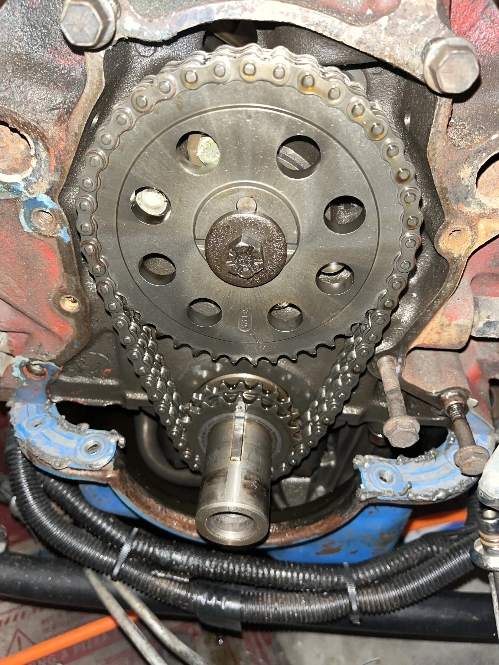

Little update. Timing chain just got here, getting it ready now. I have noticed according to all videos, there is supposed to be a timing mark on the top of the bottom sprocket, and on the bottom of the top sprocket when lined up correctly.. when my key way is at the 12:00 position, the top sprocket timing mark is all the way at the top. Shouldn’t it be on the bottom end? You can see the tiny hole or mark at the top of the photo.

The crank rotates twice for every rotation of the cam. You just need to rotate the crank another full turn.
That wasn’t your issue. Remember, you verified it by checking for TDC on cyl 1 of the compression stroke. Right?

This is how we all have learned....
Some aftermarket timing sets ( chain and gears package) come with more than one way to set them up, standard, advanced or retarded...
For the most part, just match the dot to dot when installing.... One tooth off can lead to a poor running or starting engine....

No, not if you aligned it dot to dot.
TDC is TDC, the camshaft is going to determine if that’s TDC on the compression stroke or the exhaust stroke.
So if you put it back together dot to dot, it is correct now.

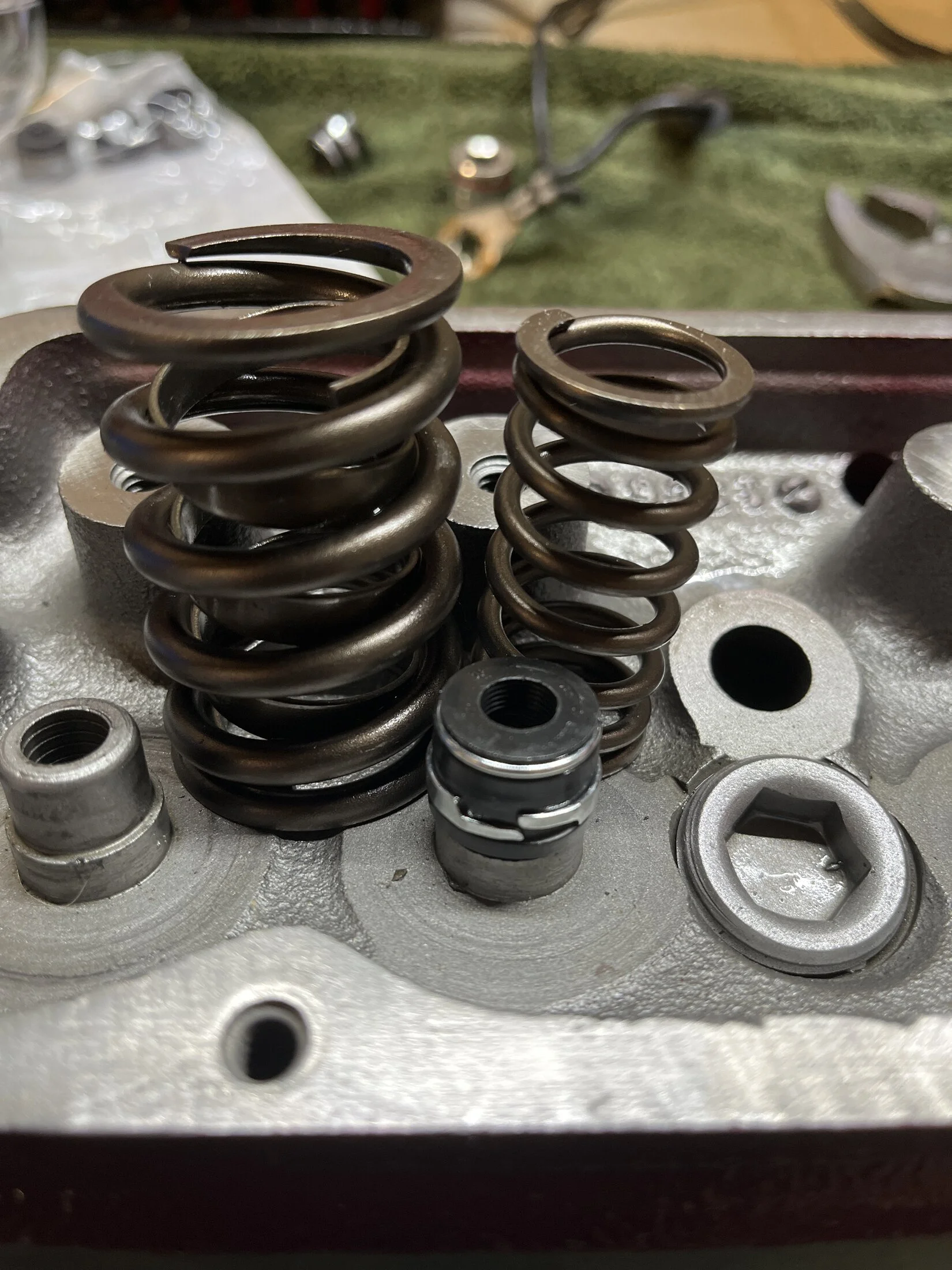

Final question for the moment.. I have dual valve springs (one small spring inside of a big spring). These came on the heads from the previous owner. I got the valve stem seals and it does fit over them, but it’s super tight on the seals. Is this a worry? I’ve had some tell me I should just remove the smaller spring, but I’m relatively sure they were installed due to an aftermarket cam.

Does the new valve stem seals look the same as the old ones. There are different styles for different situations.
The inner spring is really a dampner, I would reuse it unless you’re going back with a stock camshaft.
That’s what I figured. I got the trickflow VSS that are for “dual springs”. The inner spring is just super super tight around it, but it does fit.
