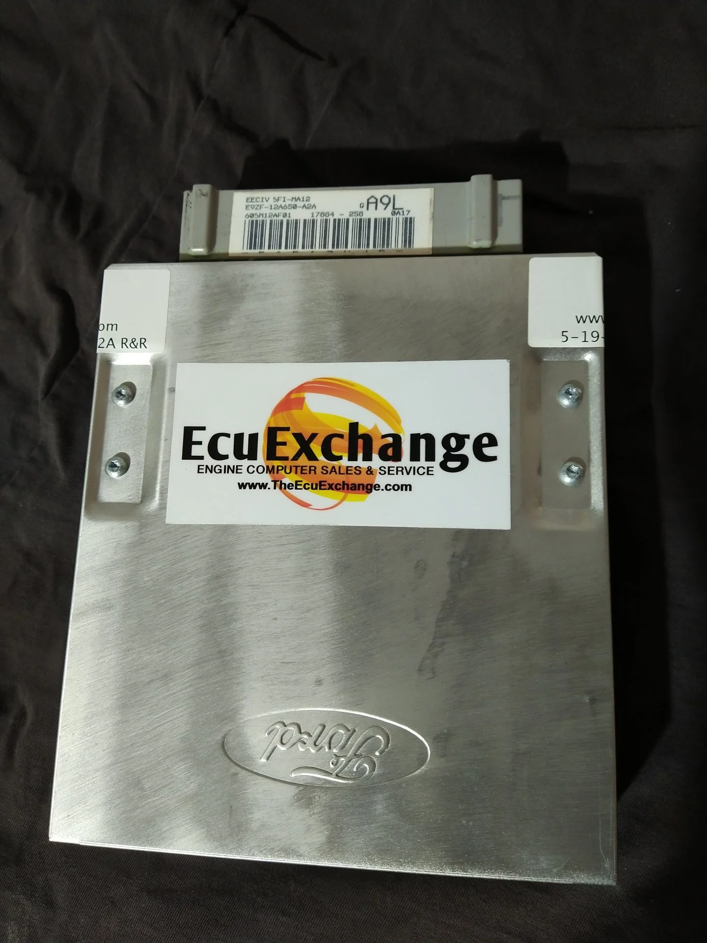

$129...not bad and they get it right.
Yep....I had 3 computers repaired by them . All worked as intended afterwards and not so as intended before......LOL
When I did business with them they were in Florida...Now theyre based out of Georgia as I have to send another one on on Monday morning for repair.....
