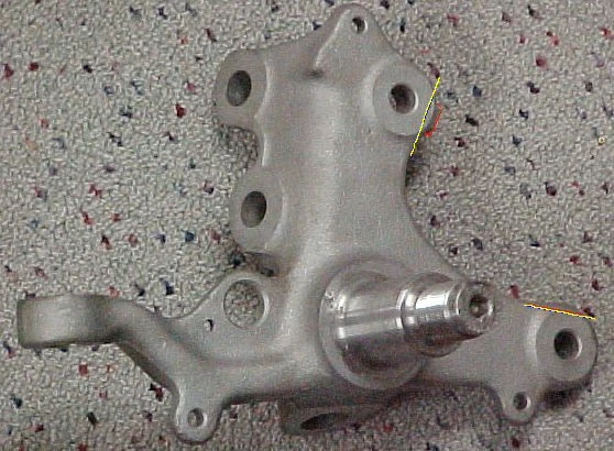

Hi there. After many years I’m ressurecting my first car I owned 1990 GT. I need some help with the 5 lug conversion. I know thousands here have done them. I have a perfectly running 97 GT donor. Dude wants $500 for it. I can make that back after parting it out. What i need to know is which parts I need to save for the 5 lug conversion to my fox? I’ve read that the 97 spindles won’t work (without adding a new k member)

Grab the spindles anyway, they have value on ebay

Spindles (although you should really find 94/95)

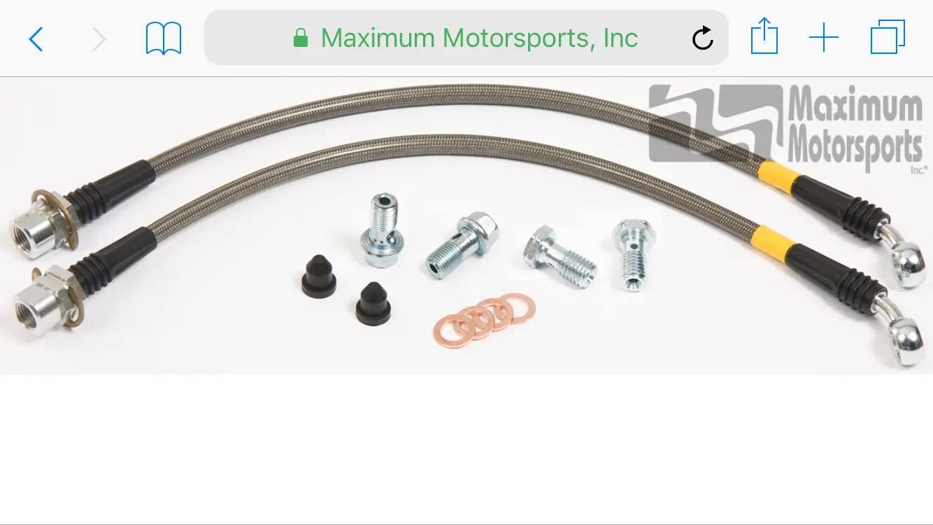

Lines

Lines

To fit the 99/04 GT PBRs on 94-95 spindles you need to clearance for the pistons slightly. Not a huge deal and you'll see what I mean when you go to bolt them up
Yup. I read a thread last night where dudes setup wouldn’t work. At the end, the piston was catching. If I want to run wider tires I should probably ditch the sn95 axels and run Fox length? And if I do that, I need a new bracket from??
