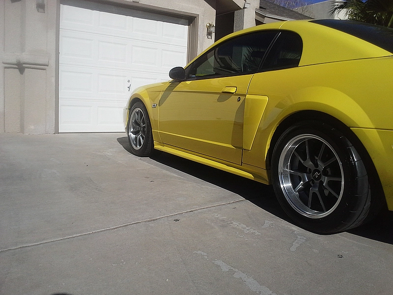

I have FR500's and a ZY car. I have 17x9 fronts and 17x10.5 rears.
275/35/17 front, 315/35/17 rears

Looks great! Any rubbing issues anywhere? And thankyou for the pic and reply.

No rubbing whatsoever
