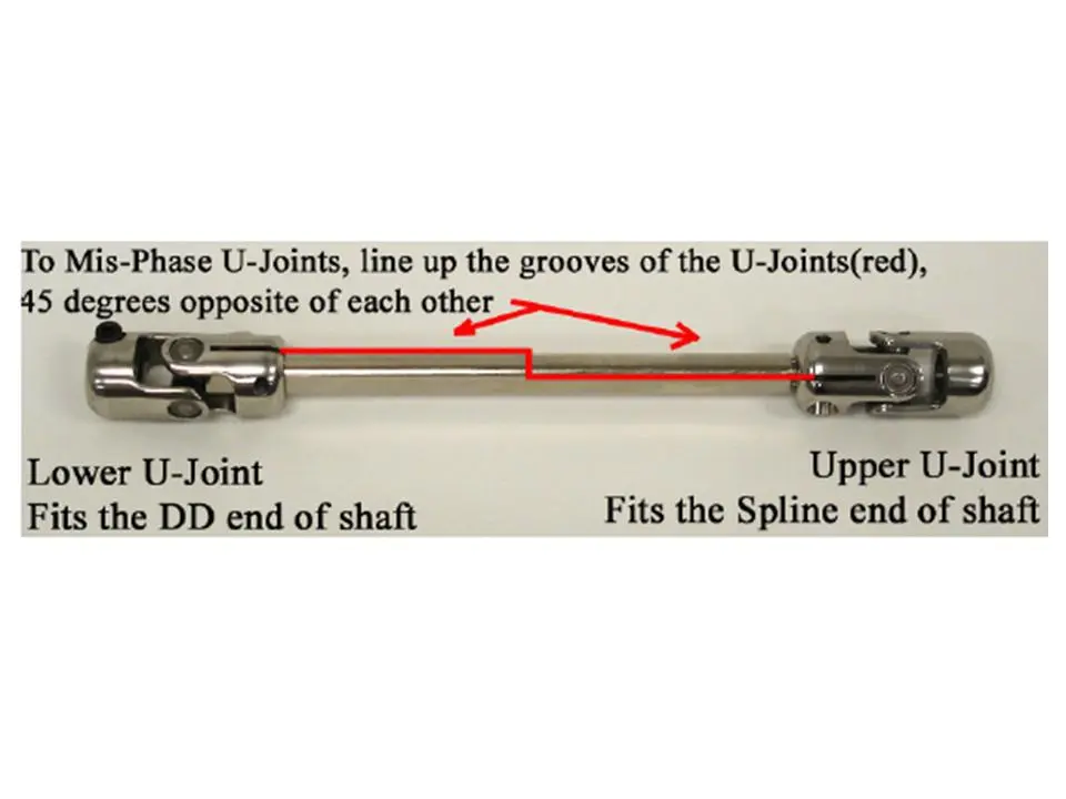

I installed a Unisteer r&p, not FR, but the same physics should apply. Unisteer was very specific about orienting the u-joints, such that they're 45-deg out of phase. In other words, the top U-joint should be rotated 45-deg from the bottom one (I'm assuming a similar setup to the Unisteer with a u-joint attached to the steering column shaft, a short intermediate shaft, and a second u-joint driving the pinion gear).
If you've got them in-phase - that is, lined up with one another - you can feel the sort of resistance you're describing, even though they don't physically bind. Without getting into the reason too much, it's because Cardan joints (U-joints) don't transmit constant velocity - they turn faster then slower even if the input speed is constant. Positioning them out of phase cancels one joint with the other. Hope that makes sense.
Man, that makes complete sense. They are in phase right now on purpose Flaming River specifically said in the directions: "Phasing - Keep the forks of the yokes closest to each other in line and parallel to the shaft to avoid binding."
But I think that is woth a shot. That is what it feels like, just like you described.
Here's a figure out of the Unisteer installation instructions that might be helpful (you can find the complete set at www.unisteer.com if you think it's worth looking at). The Unisteer shaft is keyed as well - two flats and two radiused sides - but the u-joints are set up such that they can be mis-phased.
