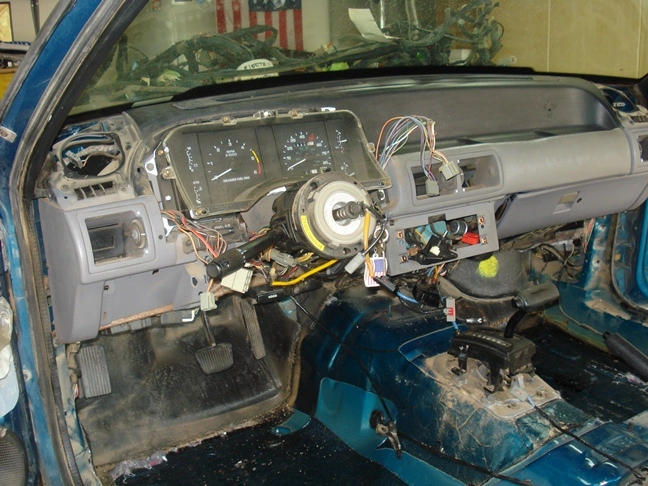

Special thanks goes out to David P (from stangnet here - he drove out by me this past weekend - thanks again David ) and "uncle' patty for helping - well let's face 'Fact' basically DID all of the work - it was my birthday this pass Saturday - and I was already 1/2 drunk..........:confused:
early morning start as usual -

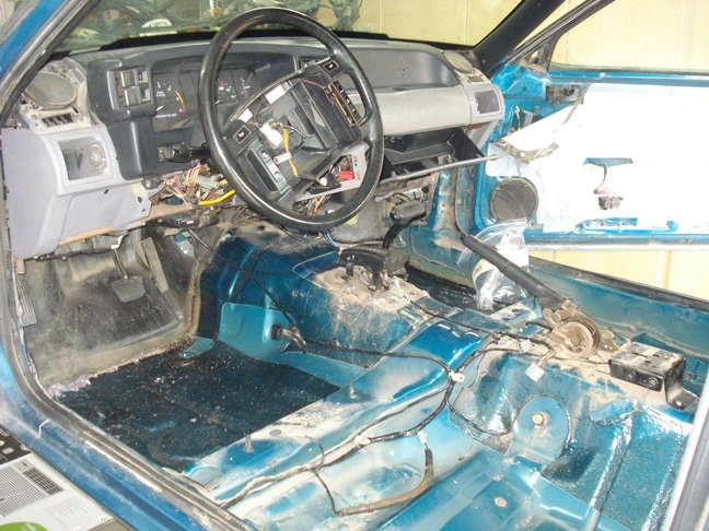

Carpet out - dash started - steering wheel out - David brought a 'puller'

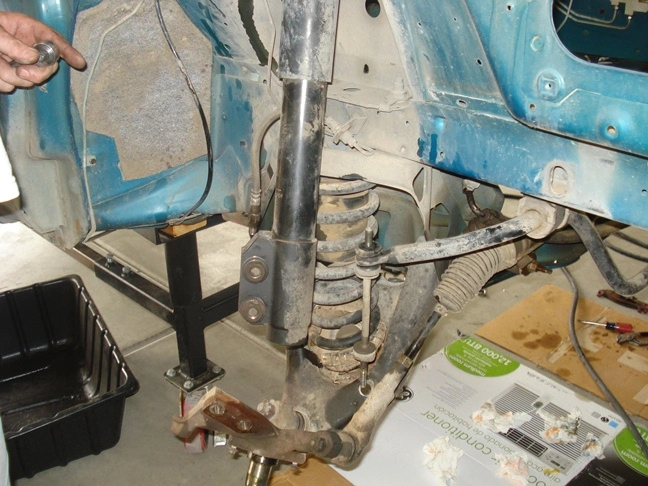

front suspension coming down

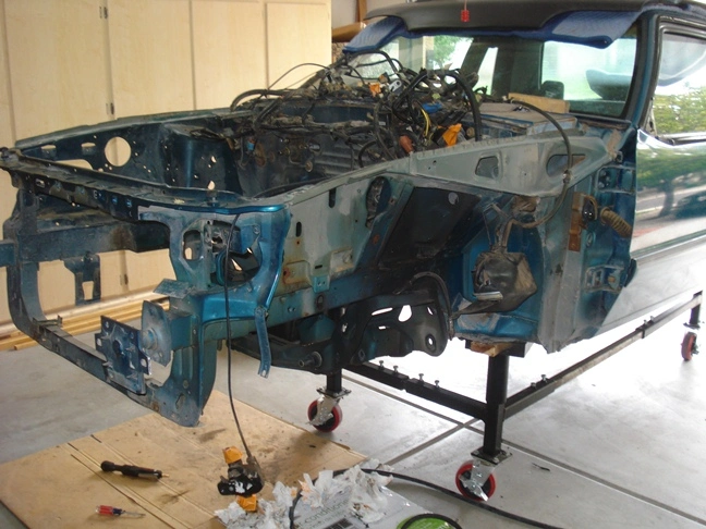

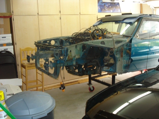

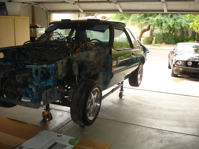

back sitting in it's place

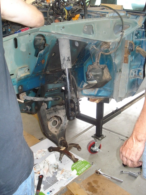

Whos the hottie in the 5th pic? Oh wait looks like me...

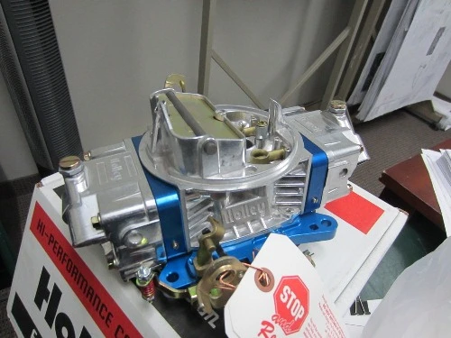

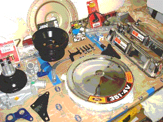

Looks sweet whatre the specs on it?
I pulled it from a 1971 LTD w/90k on it - it's a 351w - 2V - retained the stock crank (polished) - and the rods (checked) - new pistons (hypers ) - machined .30 over/ new oil pump - oil pan conversion for a fox - new E-street heads (present from x-mas) - but b/c they are 'crap' - so they were 're-worked' - 270 magnum comp cam - comp cam push rods and 1.6 roller rockers - just picked up a 650 cfm holley to top it off - pic's below -
