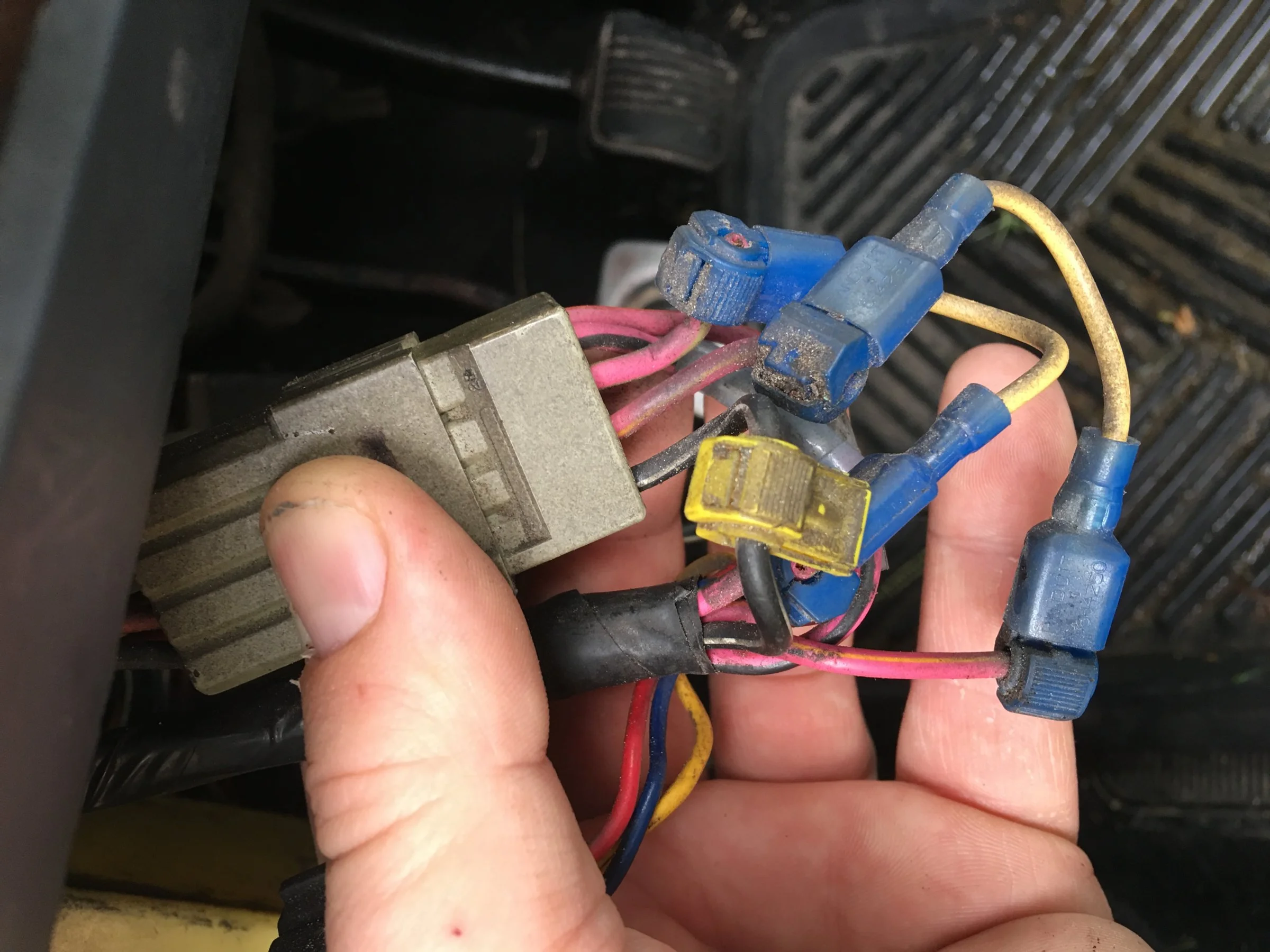

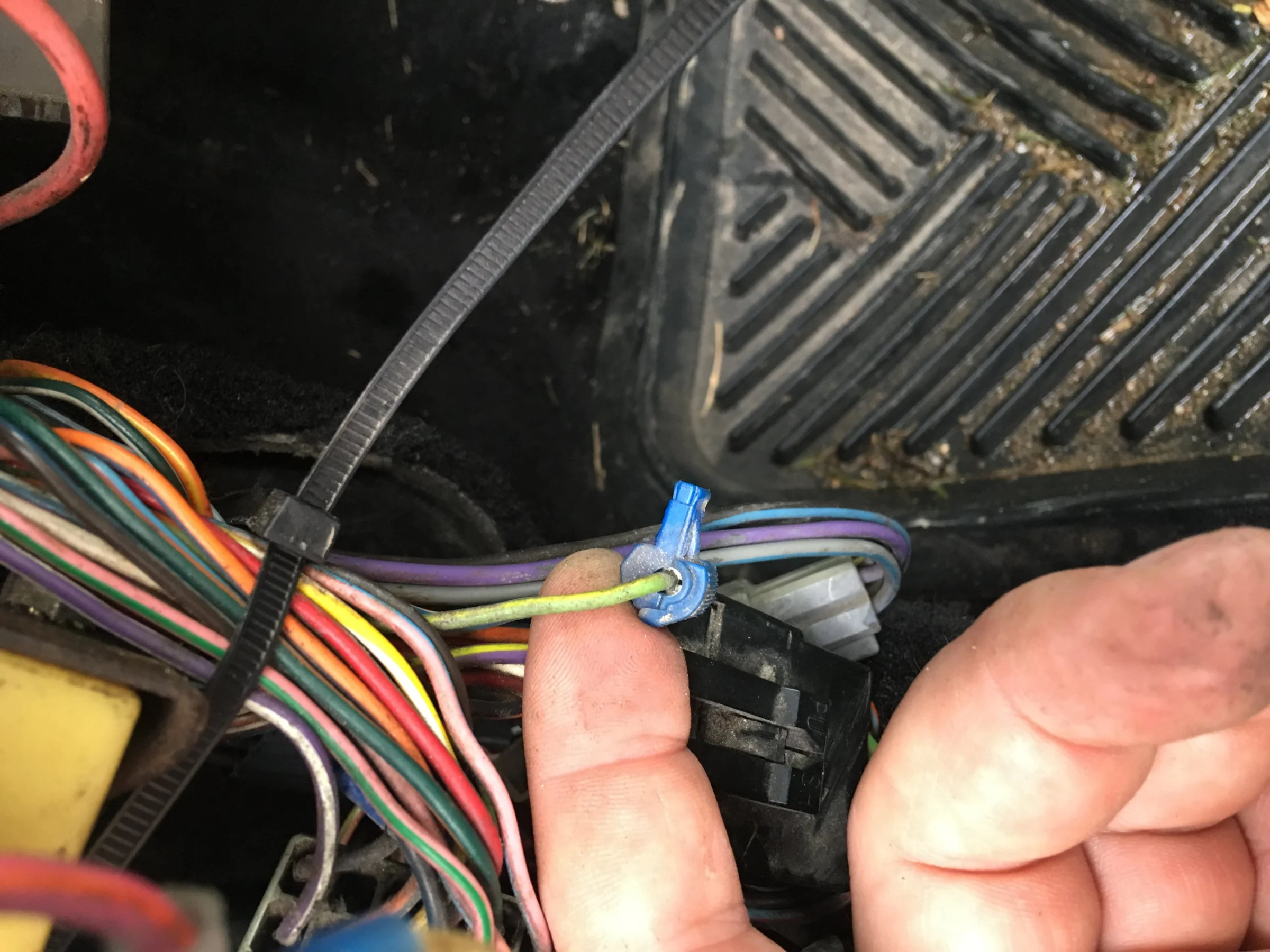

Could talk about this bogas ass alarm system previous owner installed had it duct taped under dash. All hacked up. We i removed it took all the wiring out now im having no ignition now power to fuel pump or injectors not even turnung iver with key have to use solenoid and flat head. Im stumped
I had the same problem with my son's car. There was a severed power wire feeding the ignition switch that the alarm opened the circuit on for the starter kill. I had to clip all that crap off and butt connect the wire back together.
