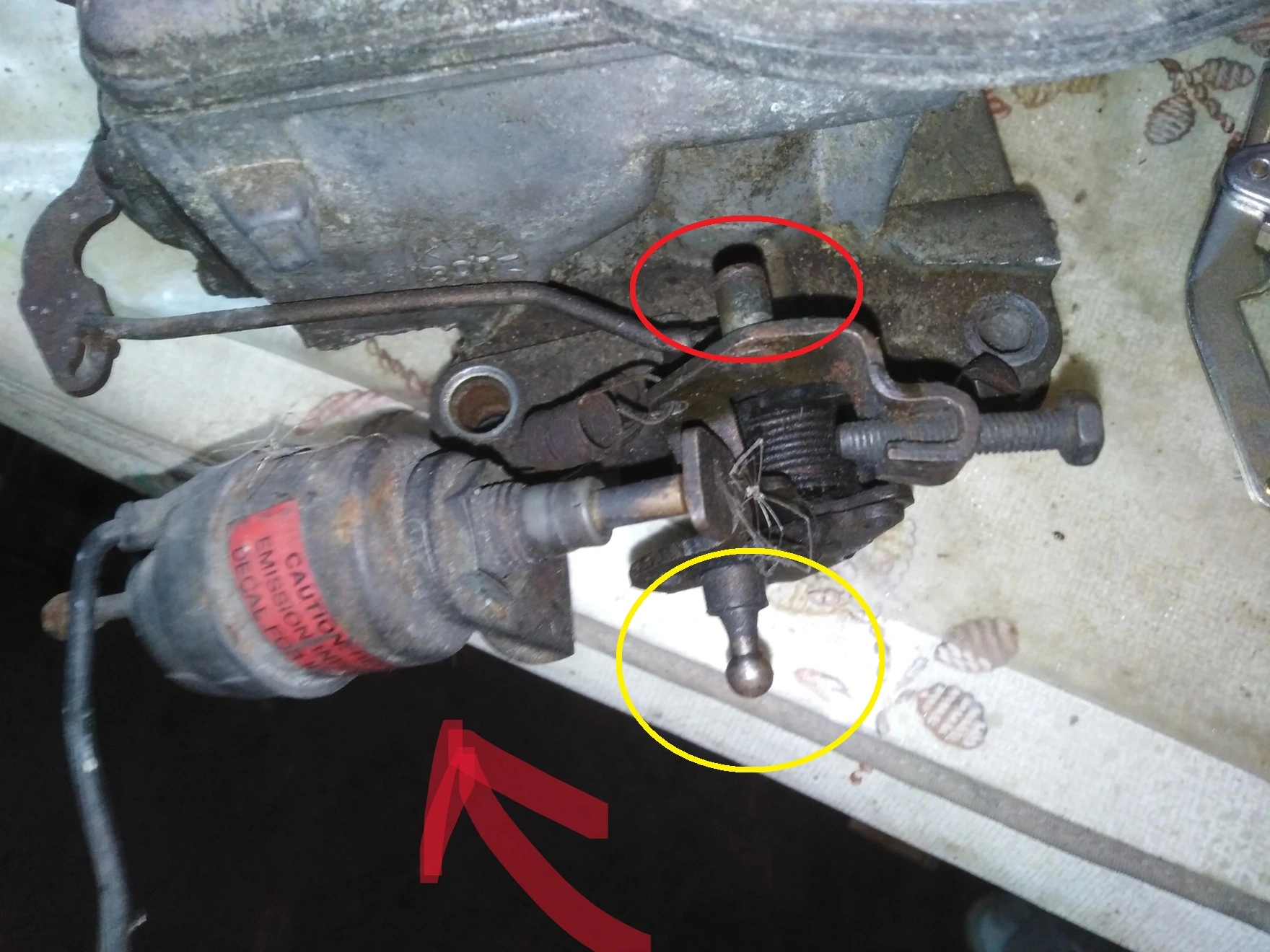

The ball stud circled in blue is for the throttle, the part circled in red is for the AT kickdown, and the solenoid looking thing bumps the idle when the AC is in use. Or at least that's what I've been told. ;)
So the "red thing" probably shouldn't be cut off if you can help it. I mean you can always manually kick the transmission down into second if need be, but it's nice to not have to do that.

Regarding the red thing tho: I -have to- cut it, otherwise it doesn't fit because that piece hits the valve cover. I can't even bend it because the fitment is too tight even that wouldn't be enough. Also it was not on the original carb I yanked out which makes me confident it's not required for this engine.
I'll take a picture next time so you guys can see the fitment

The kickdown rod goes on the straight rod circled in red. It is held on with a snap clip.
The rod with the ball end is for the throttle pedal cable to attach. It snaps on.

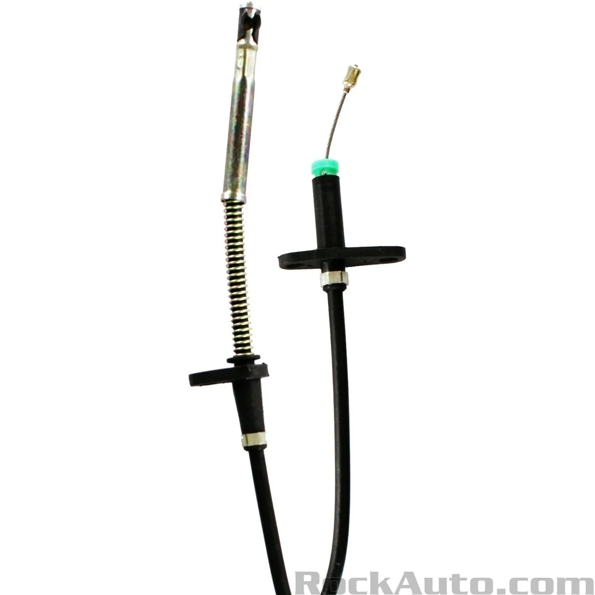

Bullet style end goes on the accelerator pedal, the other end onto the domed pin on the carb.

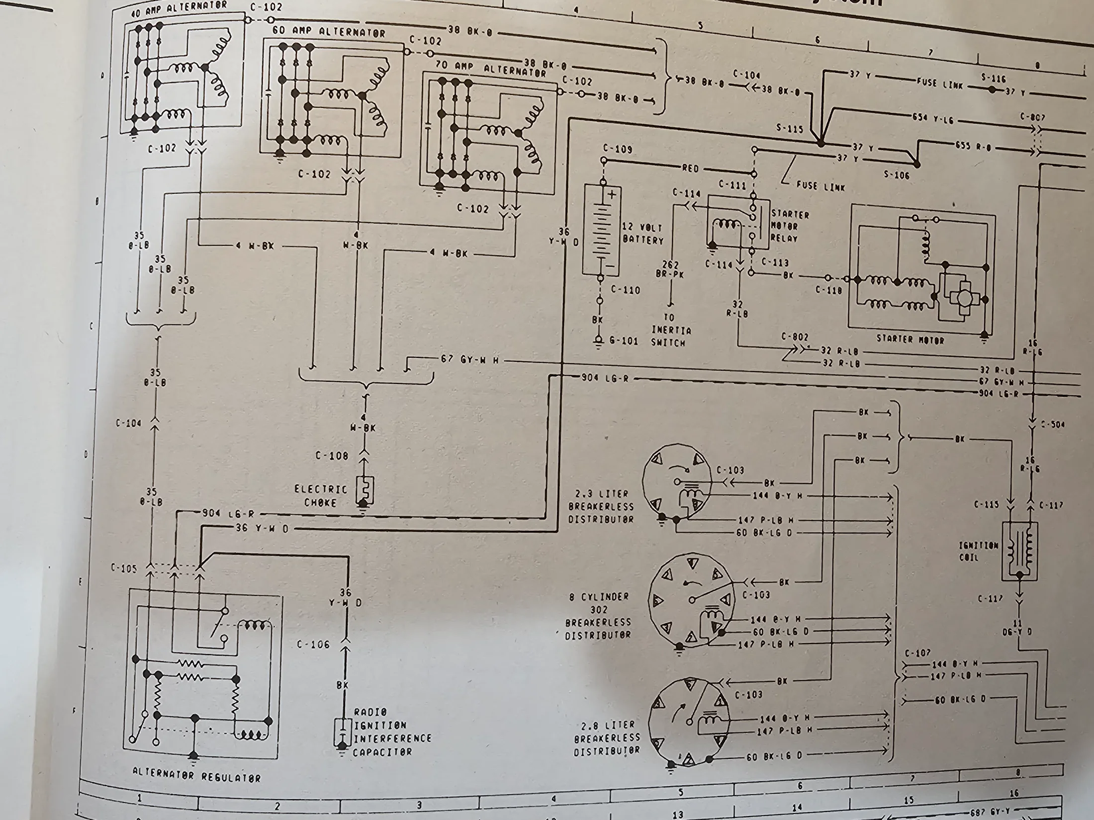

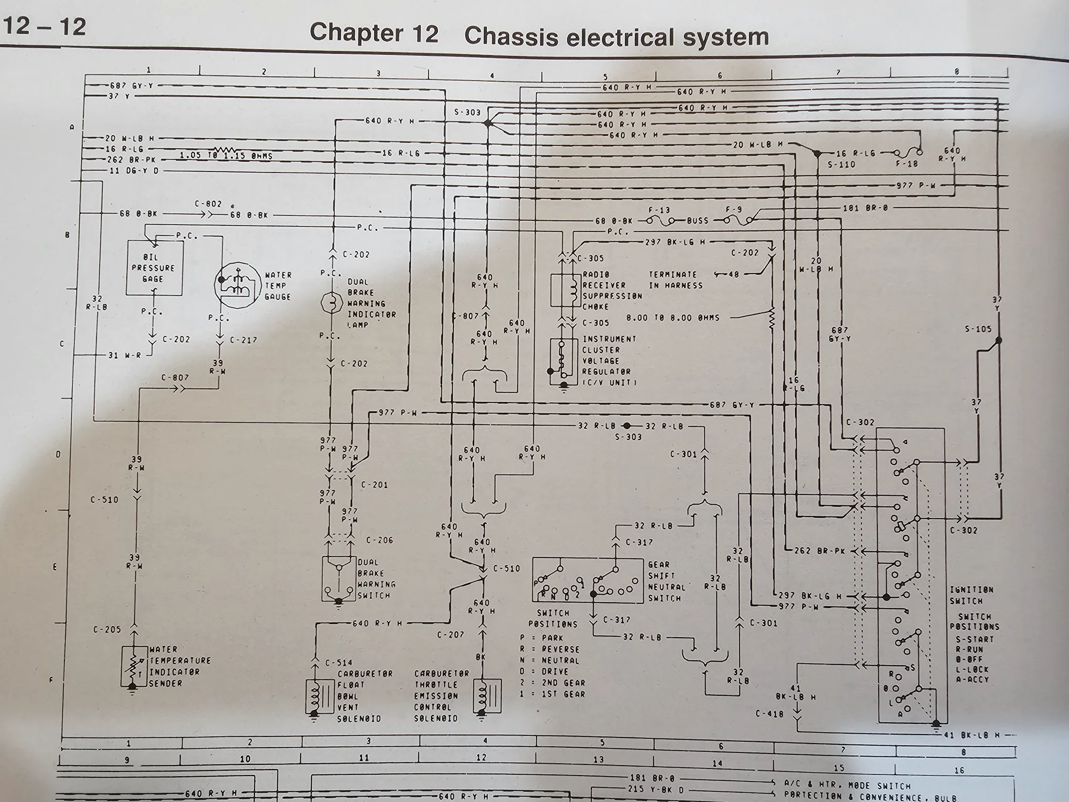

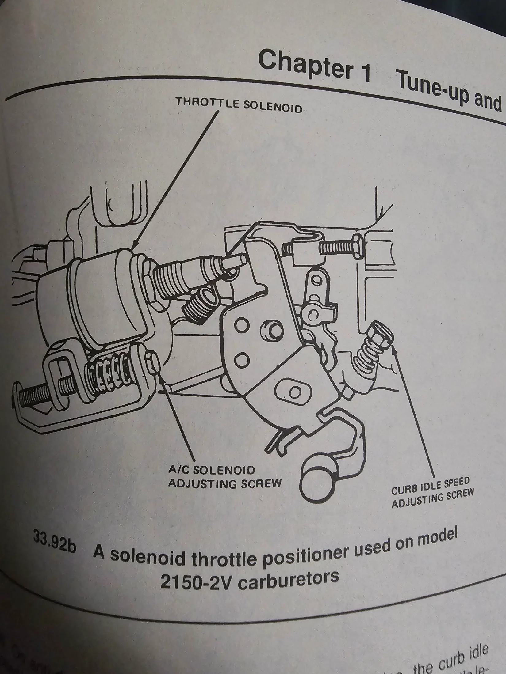

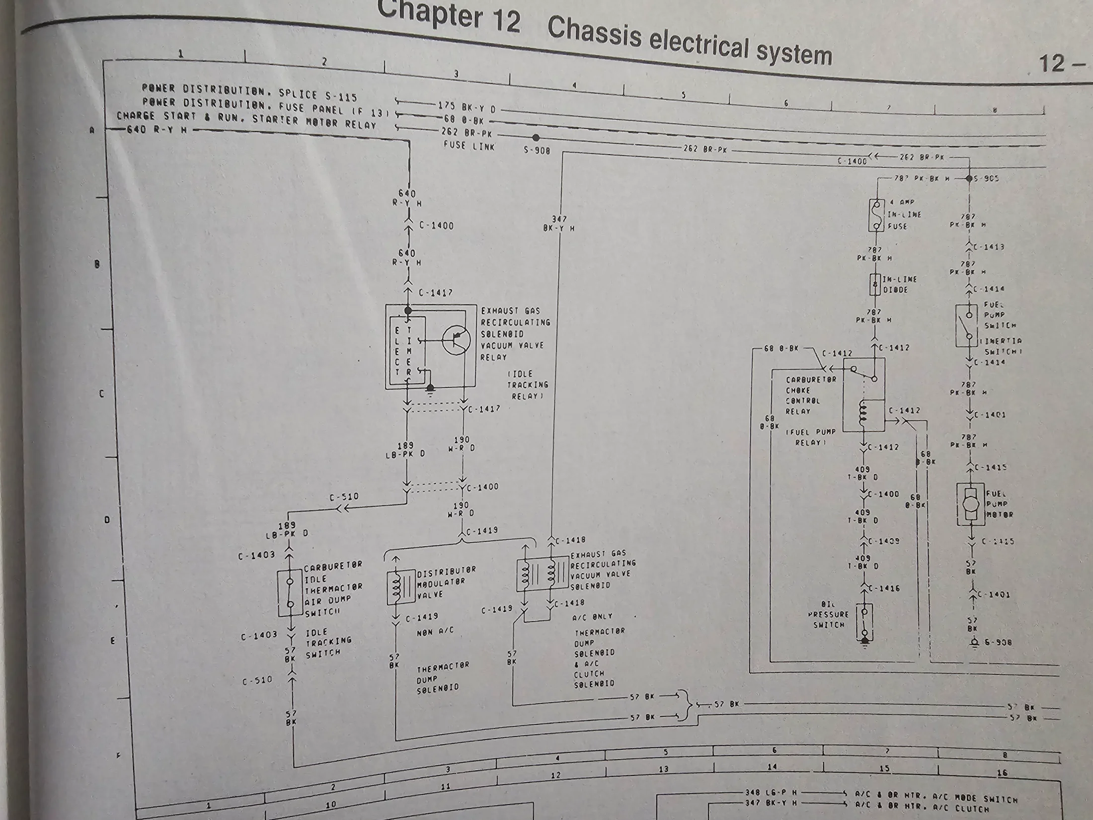

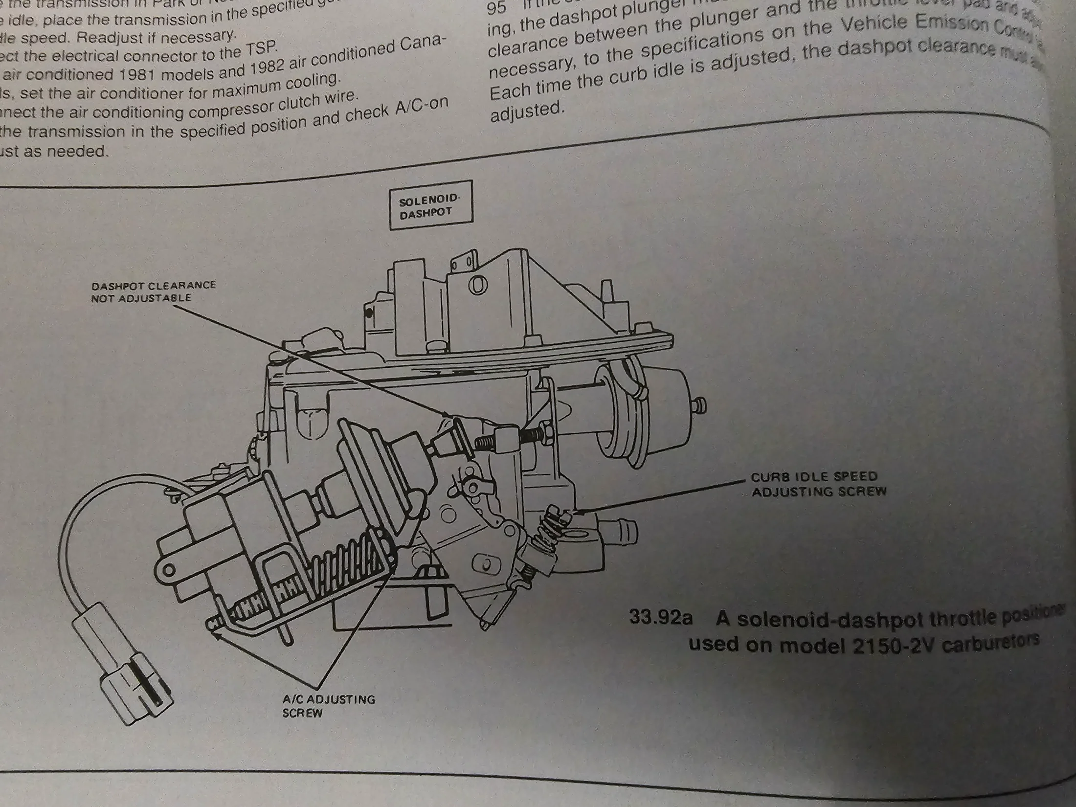

Here you go my friend. There were only a couple pics of the 2150 carburetor in the Fox manual:

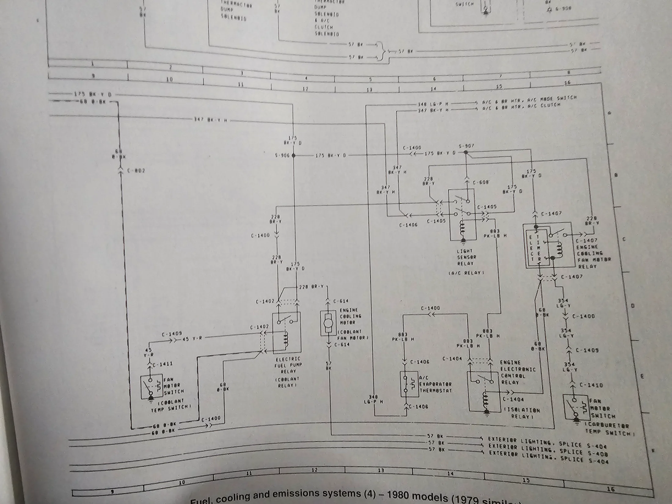

And this is the only place in the schematics that I found that listed a choke.
Hope these help a little.

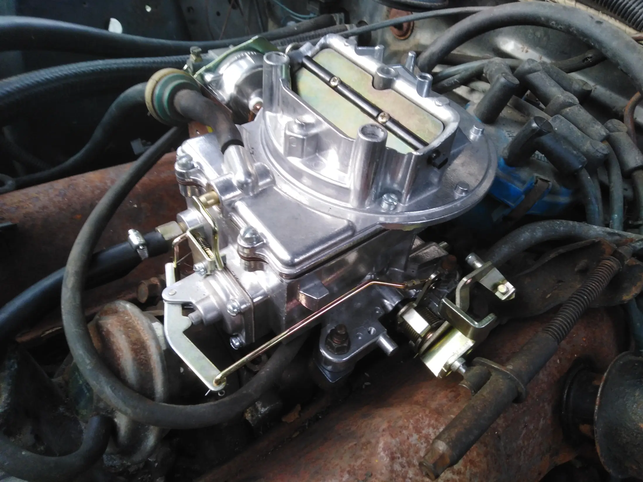

Big update: Car started! It sounds good too! :banana:

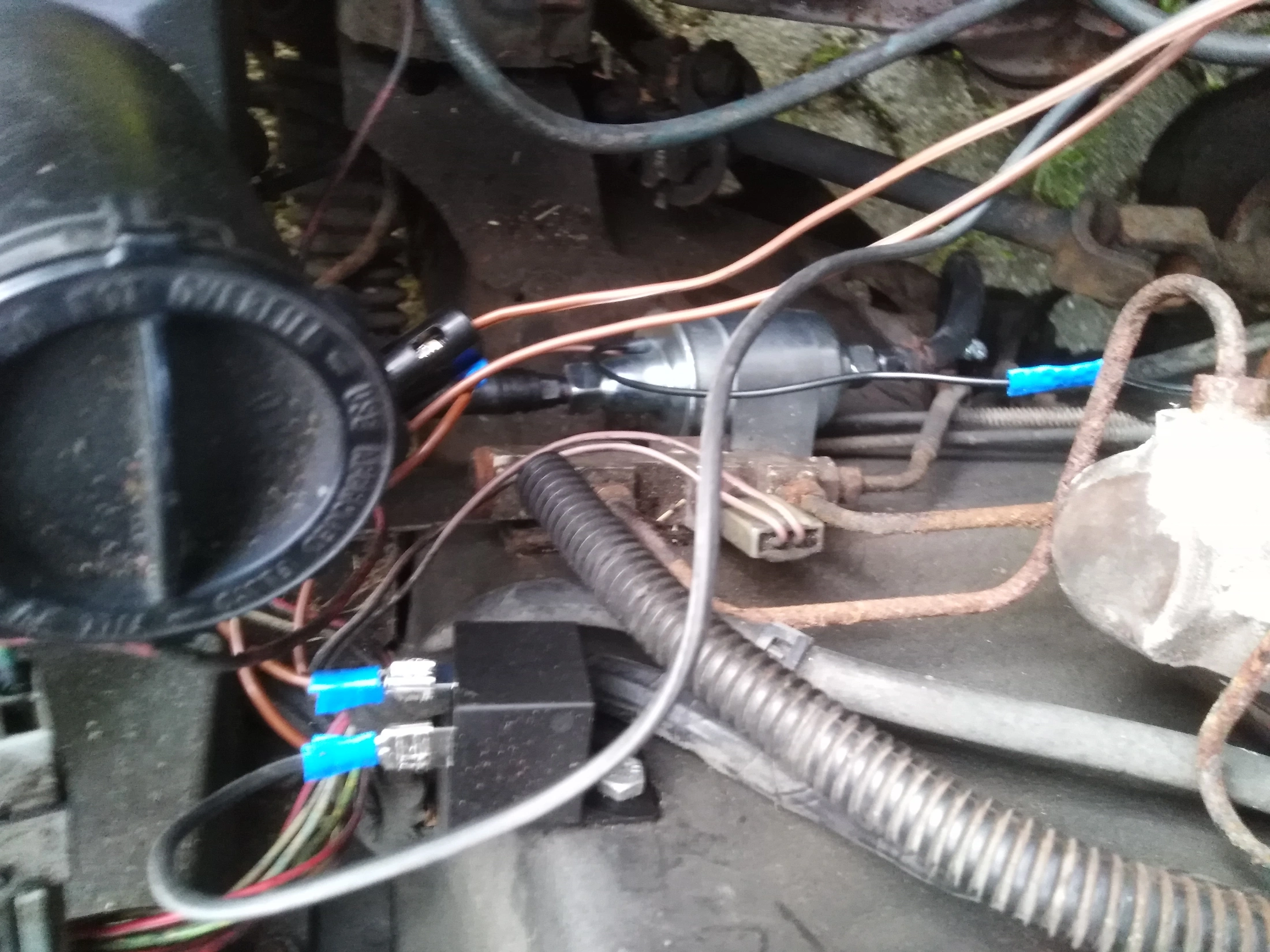

Did some wiring for the pump (I feel I did a pretty good job ^^ ; Proper 4 way switch and everything, just couldn't find an inertia switch locally) and reconnected everything, except the fuel tank; which was both full of old gas and surprisingly clean inside.
I did simply reinstall the og mechanical pump to close the block, but if you know anyone that can make a blockoff plate I'm interested.
The carburator linkage in the front does hit the EGR valve a little. Turning the EGR 180° would fix that problem but I'm not sure that's a good idea. Otherwise I'll grind it down.

Annnd the carb needs adjusting, feels like it revs a little high (as far as tach-less earballing instincts go) and it doesn't want to hold idle for too long. Any tips for that is greatly appreciated.

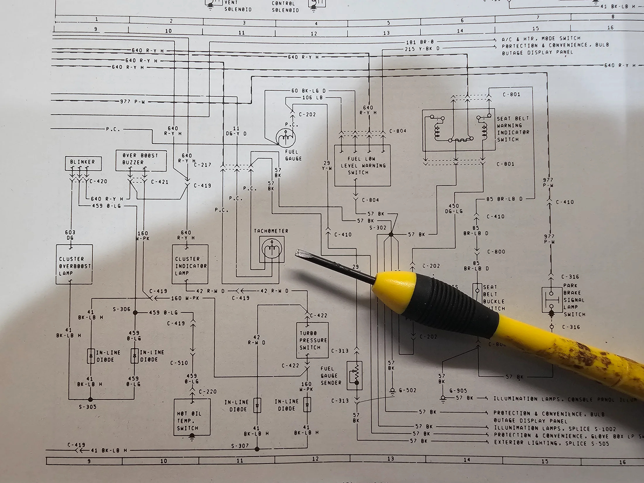

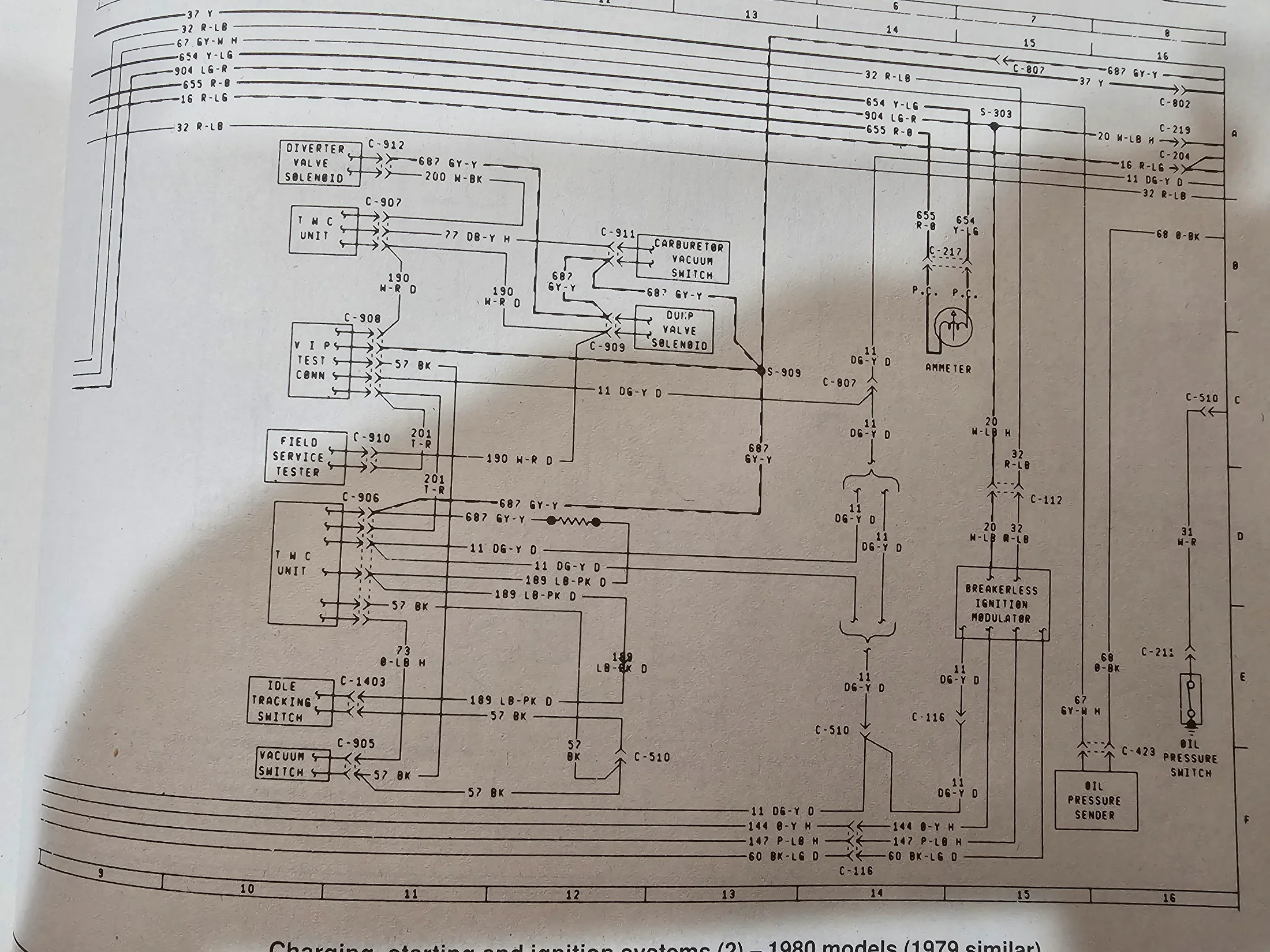

Not sure what color your 79 tach wire is
You need a 1979 Mustang EVTM
Or, to have the diagrams posted possibly by LILCBRA like the ones he posted in post 84
But
Your tach wire at the ignition coil negative terminal, might be the same exact wire that goes inside to the tach in the cluster connector
Chances are that your tach is toast if that wire is blinking with the engine running

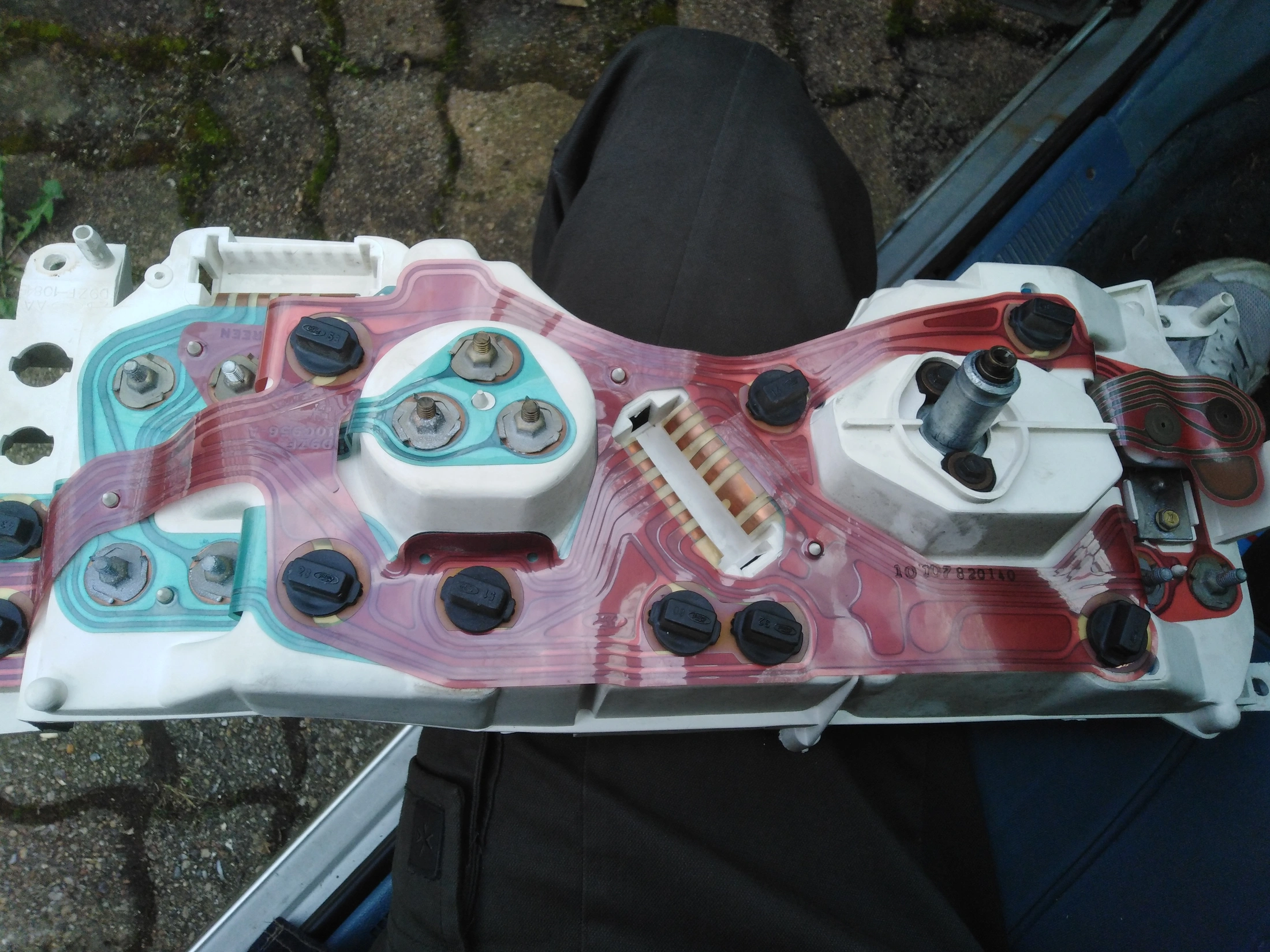

Might be a pain to test since you can't start the car when the cluster is unplugged, guess I'll just go get some blood rushing in my head with some underdash action :nice:

You should be able to start and run the car with the cluster removed
Oh? Mine won't, I hear a clacking from some kind of relay I don't recognize from before and nothing more.
Feel like I read that info somewhere too, can't remember if it was on a forum or in the manual.

Ok @ZachOrie - here's the diagram following the 3 connections to the tach. I'm no electrical guru or anything, but it appears that the red with yellow hash wire #640 is your tach's power wire, the black #57 wire is ground, and the dark green with yellow dot wire #11 is your signal wire. Here are the diagrams.
@ZachOrie - I know you said that you had gotten a manual, but these wiring diagrams are also very handy.... they are color-coded with factory wire colors, more durable than paper, and sometimes are easier to use than a book with folded out pages, especially when one is laying on their back on the floorboard, trying to track down some underdash wiring issue.
