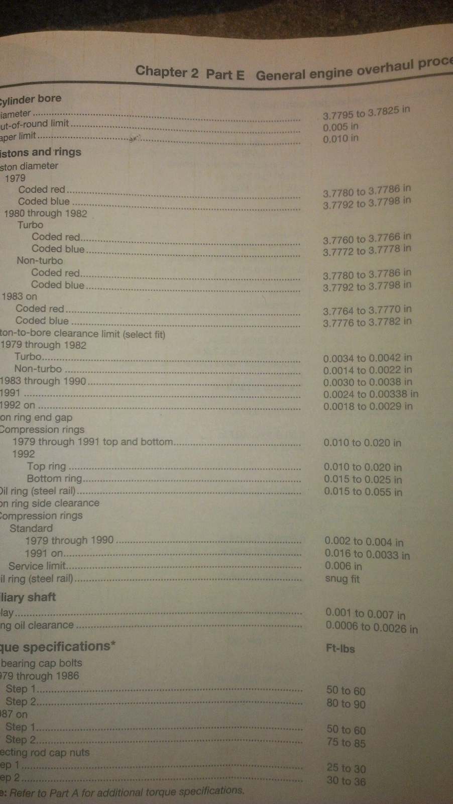

miced ring and land on piston.... only .003 difference. ring .078 / landing .081

i got standard gap rings. not file to fit. but ill get that tomorrow its all locked away now. yes dots are up shinny ring is top ring. cleaned them after getting them off and theywent back on just fine.

ring end gap .016 top, .018 second ring

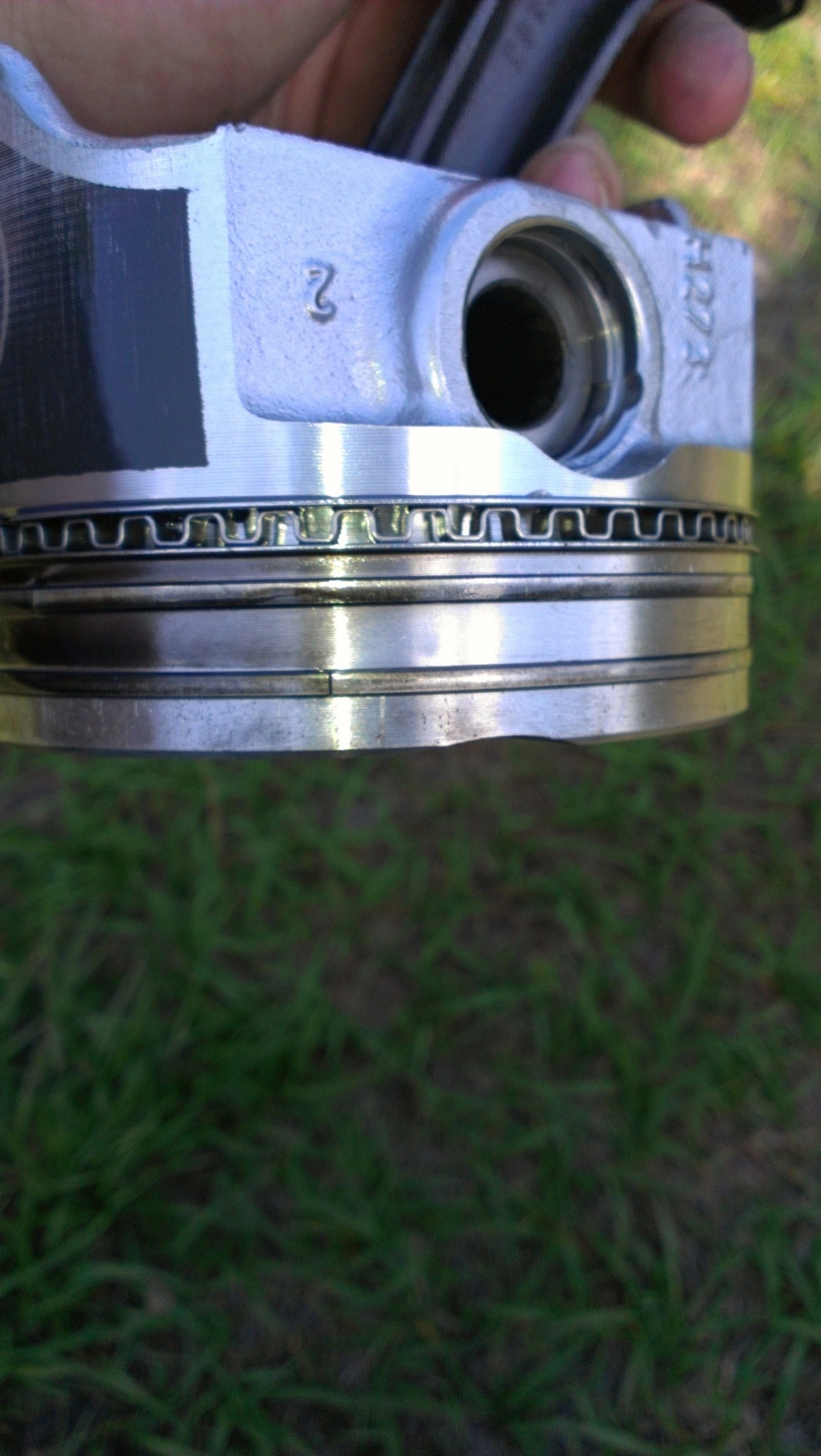

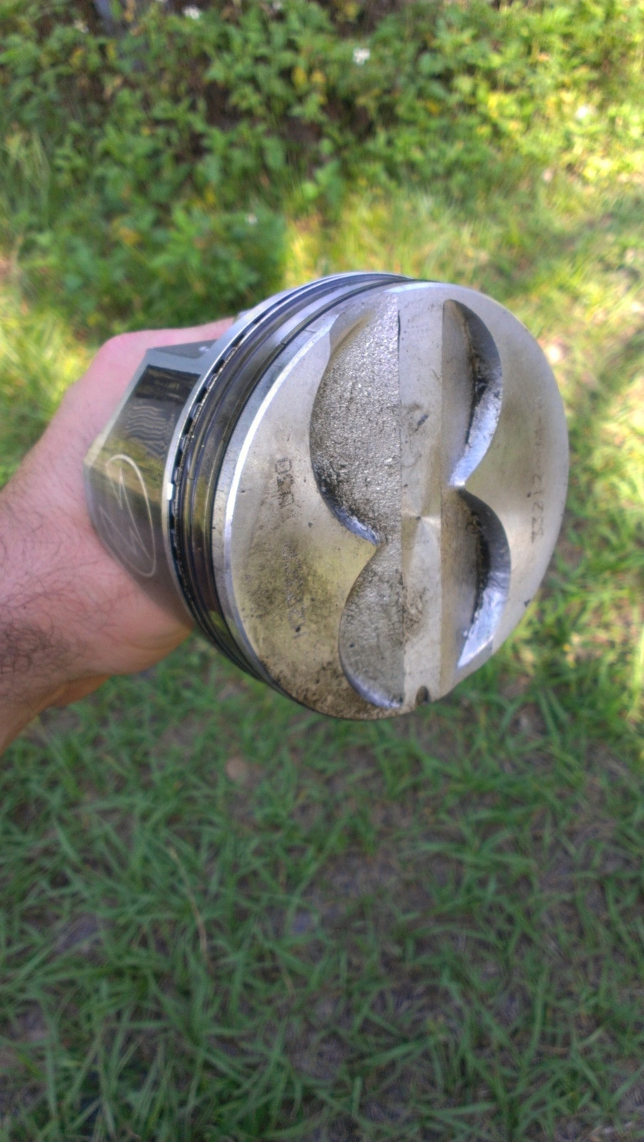

ok you can see the rings are stuck. i have to pry them out of the piston. they did come loose after 24hrs soaking in a tub of carb cleaner.

woah thats not right. looks like the wrong sized rings

the top ring is now thinner as well.
