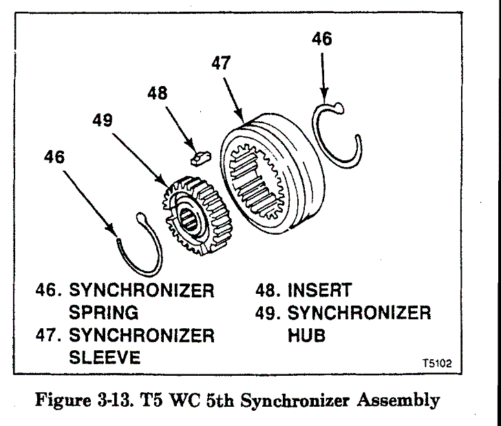

Each synchro assbly has 3 "keys" that serve to hold the syncro in the engaged position. The "keys" look like small metal
boxes and are held in place by a wire spring inside the synchro assembly. My guess is that the spring has slipped out of
place and the "keys" no longer have spring tension on them to hold the synchro assembly in the engaged position.
attachment.php
46 is the spring
47 is the sleeve
48 is the "key"
49 is the sychnro hub
