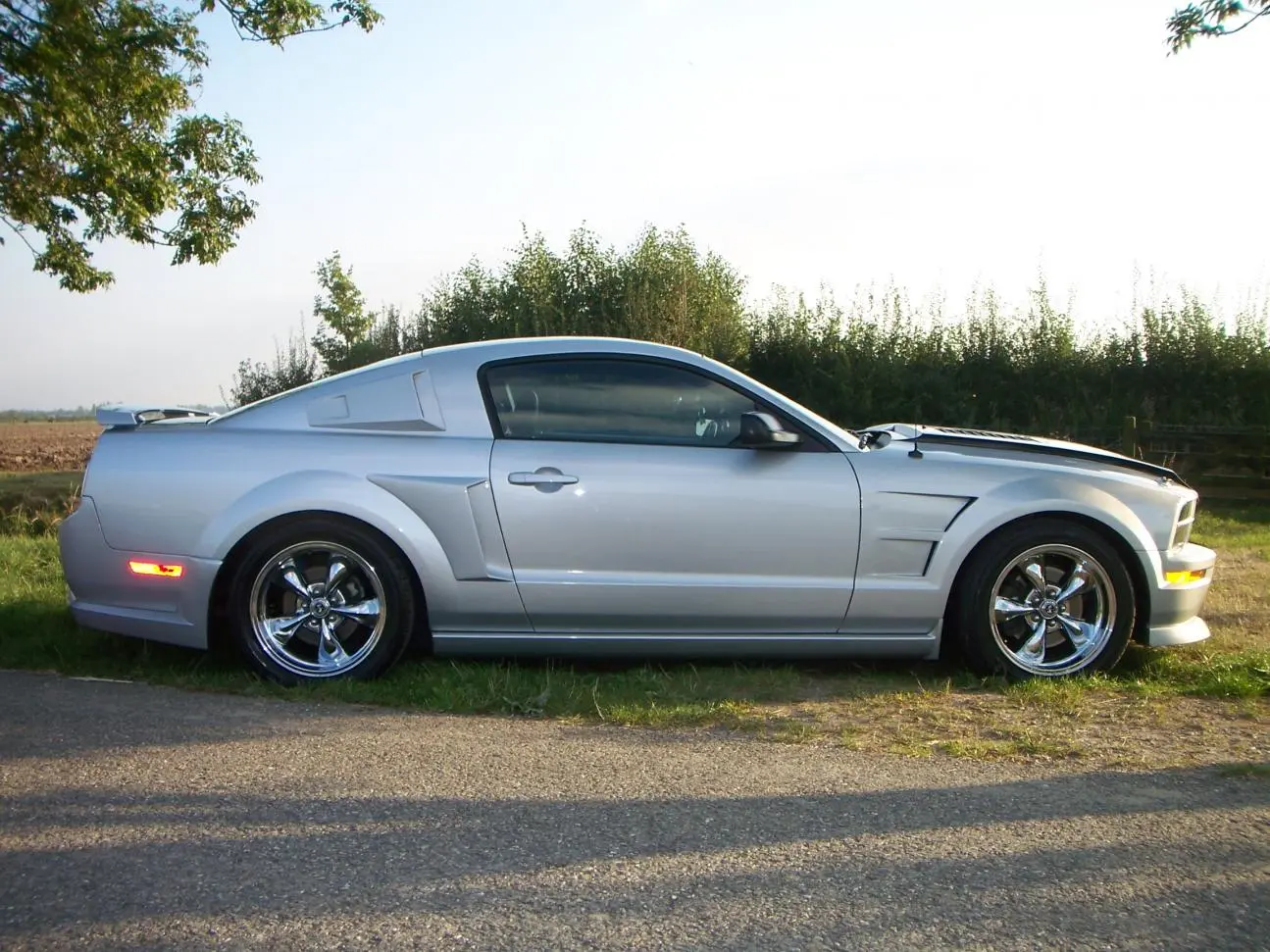

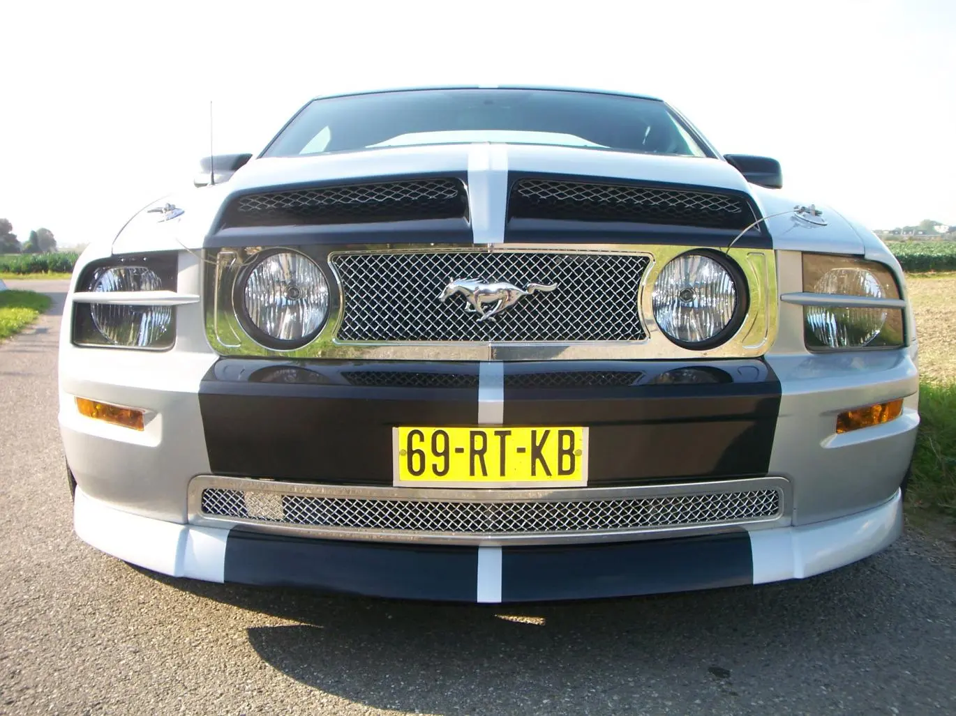

i am Ralph from The Netherlands and have an mustang 2005 gt automatic ,and want to have an supercharger .In The Netherlands there is only 1 company who can install it and the work with an vortec high output .
But a lot of people are saying that Saleen stage 2 brenspeed is better ?? is that really thru? is there really so much of turbo lag with the vortec ...? i am an normal driver sometimes street sometimes road racer....please advise me..
