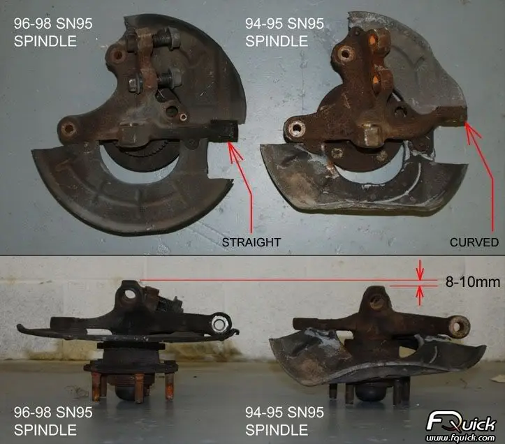

Front Spindles (94 vs. 96) Identification
There is an F5 part number spindle as well. Unsure what the change was, but i have one of each on my car...F4 and F5. Odd thing is they came off the same car.
94-95 spindles also push the front wheel out slightly. it's not much, maybe 1/4" or so. I have pictures of the same wheel on 5-lug fox rotors and my 94-95 spindles and you can see it came out a tiny bit.
96+ come out 8mm more than 94-95.
Here is something for a visual:
