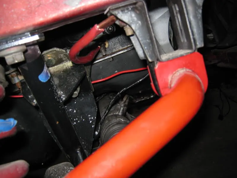

If you mean the bushings on the sway bar...

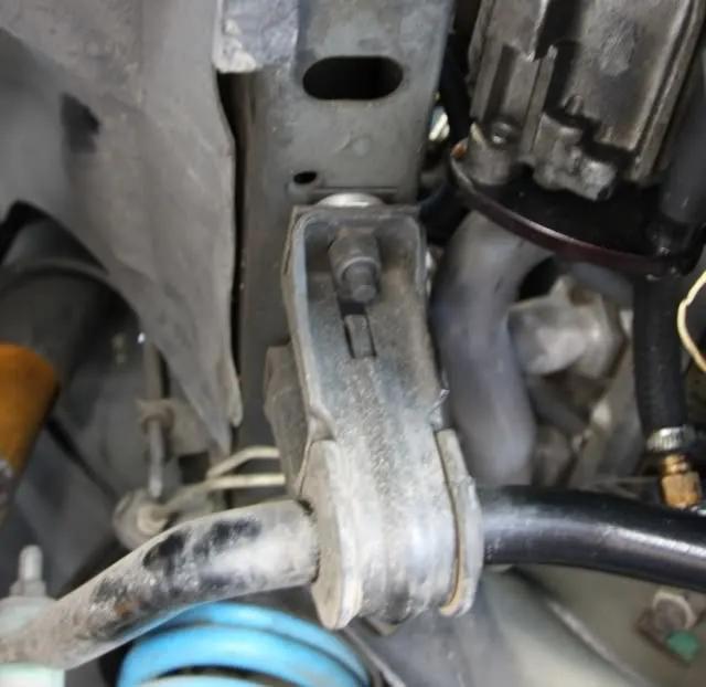

Its a stud with a nut:
Have fun fishing that through the rail... If you have a welder i would probably just open it up and weld a bolt in there...
There might be an easier way... Mechanics wire is your friend.
Ha, yep, that's the culprit . . . nice pic.
Won't be as bad as I thought to fix. Took the other nut off and the brackets. Turns out the hole in the rail is slotted with a retaining clip to hold the bolt. Given that, the bolt should still be hanging there since the clip didn't fall out. So maybe it did snap. The bracket has pulled away from the rail simply cuz it bent without both bolts to hold everything in place. I ordered my new bolt and nut from ford this morning. Of course I had to order a 4 pack of bolts at $5 ea.

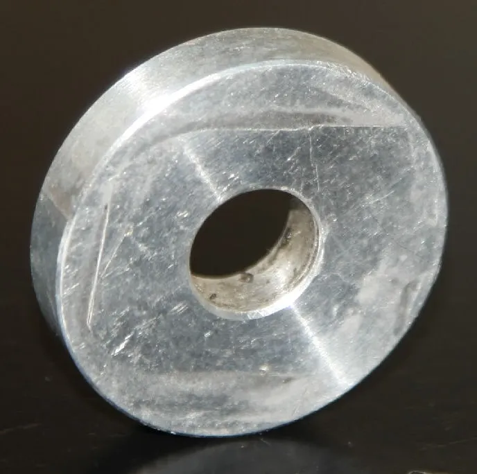

What I'm trying to find out about now is the spacer that is on all the remaining 3 bolts (both rails). It sits right up against the rail, between the rail and the bracket, and clearly isn't in Adam95's pic. It wasn't in the ford parts diagram. Maybe it's aftermarket. It's aluminum, 1-1/4" diameter, 1/4" thick. No idea where to find another one. Anyone know?

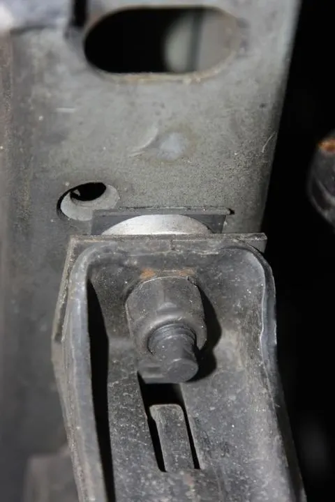

Here's a pic of the other side which is still together, showing one of the spacers installed.
Anyone know why they're there? What they do? Were they part of some kit?
Anyone know where to get another one? I've looked around on the internet and no luck. Dimensions are 1-1/4" diameter, 1/4" thick.
At this rate it's just easier to leave all the spacers out if I don't know the benefit of leaving them in.
I just replaced the swaybar bushings on my car and there definitely was not an aluminum spacer like in your pictures. Mine looks like the one in adam's pic.
