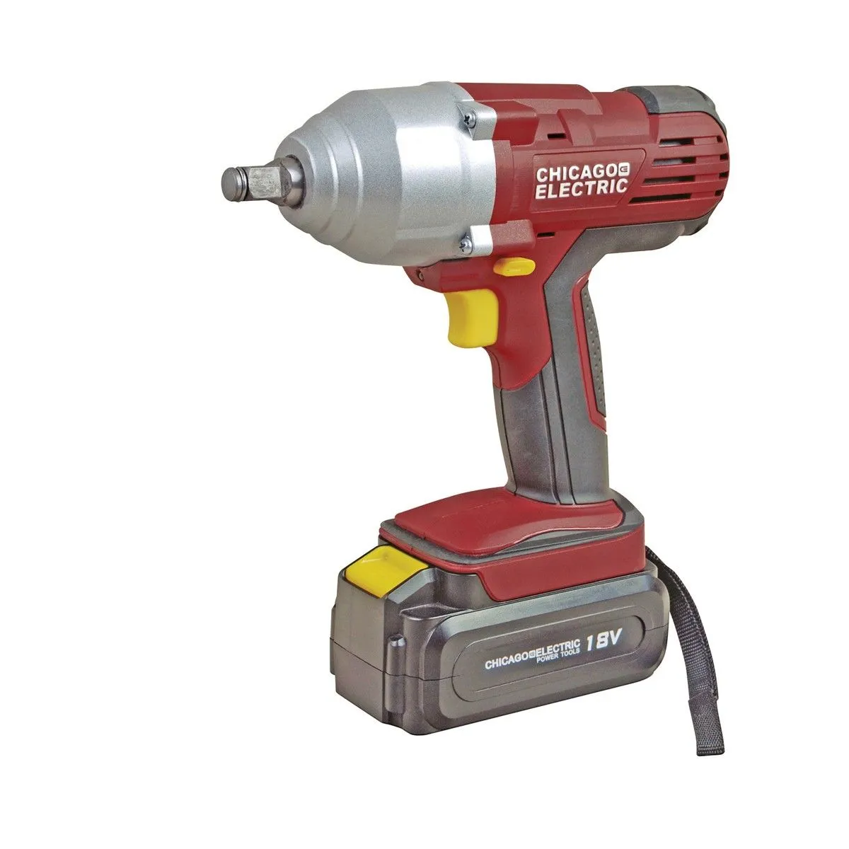

Be sure you do I had an oh shiaaat moment when the jack I had under was a pos and it gave out, took the nut off and it popped down, talk about an oh crap moment when the strut hit inside the fender which would have been right in my crotch. Luckily I had the old wheels underneath as well so it didn’t fall all the way down. Go to harbor freight and get the battery powered one, I had the same issue and that solved it. I found one in their clearance section that somebody returned and it works perfectly, paid 60 bucks.
