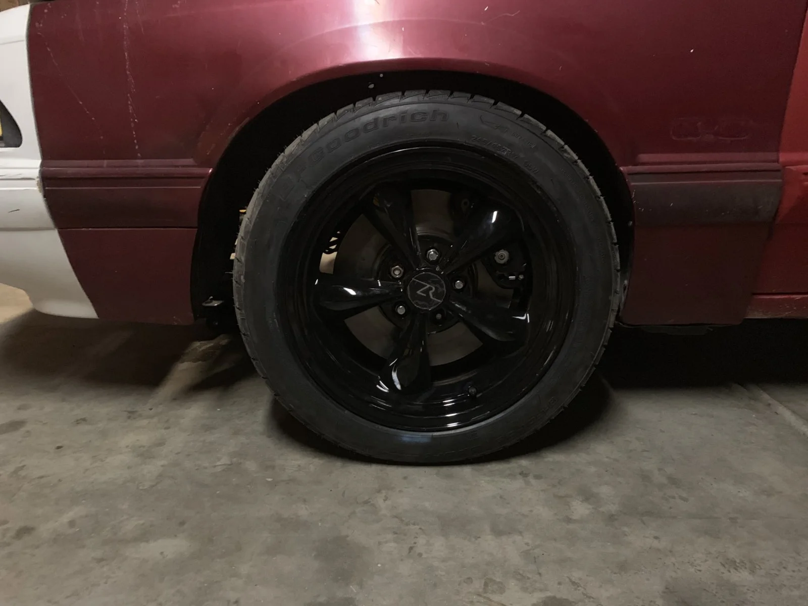

Hi guys, looking for some help on this project. 93 notchback I’m working on the front suspension. I put MM coil over kit with MM caster cambers, bilstien struts, SN95 spindles, big brake setup 13” rotors with cobra calipers & QA1 control arms. Alignment still needs to be done but to me it appears the tires have been offset back ? I have 245/45/17 on a 17x9 wheels. Does anyone know if the QA1 control arms are supposed to offset the tires? I know I’m running big tires upfront but I see guys running them all the time but when turning the tires rub the back of the fender. Any help is appreciated.

Qa1 stuff is known to cause all kinds of offset issues . Do you have a stock k member still ? I lf so save yourself a headache and go back to the stock arms . Remember to use the spaces needed with the sn spindles or press in 95 ball joints. This will positivley make your issues go bye bye .
