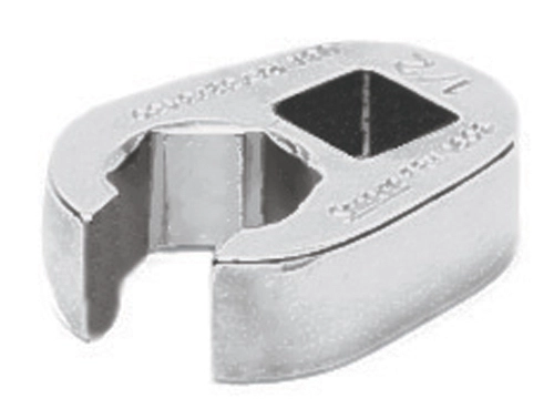

try a crows foot on the end of your torque wrench.
Crows foot on the torque wrench is how I did mine, you just have to remember to adjust the torque setting slightly to compensate for the extra length (mine was about 1 inch longer on a ~10 inch throw, so I just subtracted 10%). I think that nut calls for 85 or 86 lb-ft, I forget without looking in the shop manual, and I think I hit it with about 78 with the crows foot.
Hasn't come loose yet but it hasn't been all that many miles yet.

BTW, you will need 18mm, it's an odd size and can be a little hard to find. I know Craftsman sells a pack that contains 18mm, and Harbor Freight has a flare nut version that would also work in 18mm, but I had to order mine and therefore had to wait for shipping.

I have the crowfoot set from Craftsman. The question becomes, how long is the arm from the original lug center to the force point in the bar of my "clicker" old-but-good Craftsman torque wrench. I can't isolate the click, and the wrench is 18" from lug center to handle tip, 13" from lug to the (relaxed) adjustment ring. Hand-grip center is 15" from the lug center.
Intuition says from grip to lug, plus the ¾ inch extension of the crow foot.
Any more authoritative ideas?
Thanks again for your thoughts.
That's what I used, it should be close enough, there is a torque range on the bolts and I know my torque wrench is off by a good 5%+ at times. When I did mine, I figured that I was applying my force roughly 10 inches out and the crowsfoot was adding another inch, so I figured it was adding about 10% more torque than I had dialed in.
